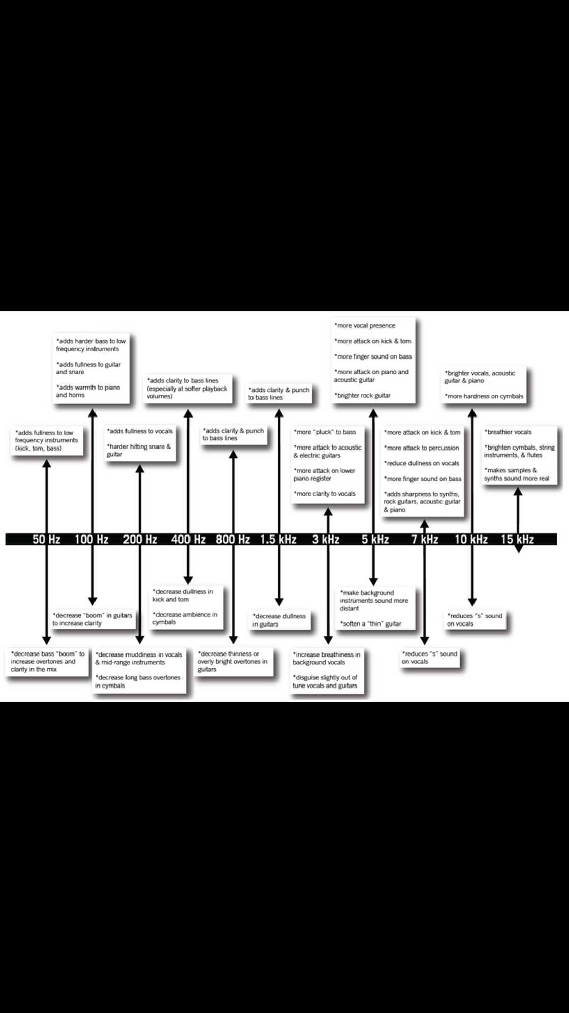

Yeah, I think it is a little too bright too. I got it that far and wasn't really sure what frequency would bring that down a little.
