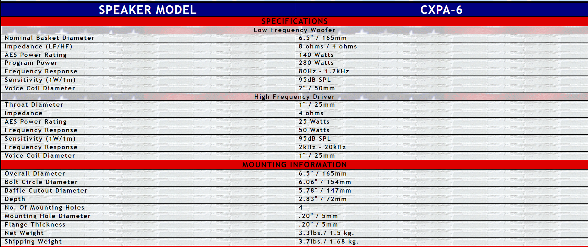

Yes or no on this speaker? Why or why not. Spec experts chime in. Ciare.

not unless you have a dsp and a tweeter to run with it, look at the top end of it's spec rating, stops at 1.2khz, there is a lot of sound and tone above that and without something else to pick up the slack and be able to tune it to do the best it can, i think that you will be left wanting. that speaker all alone wont cover your higher frequencies.

Look closer at the specs. The woofer and tweeter are listed separate. But I agree on the dsp.

Sorry, my bad missed the tweeter section. You're still going to need the rep to tune it, and you ight be light on power for it with the stinger amp, unldss you wanted to run it bridged, along with another amp for the high end side of things.
