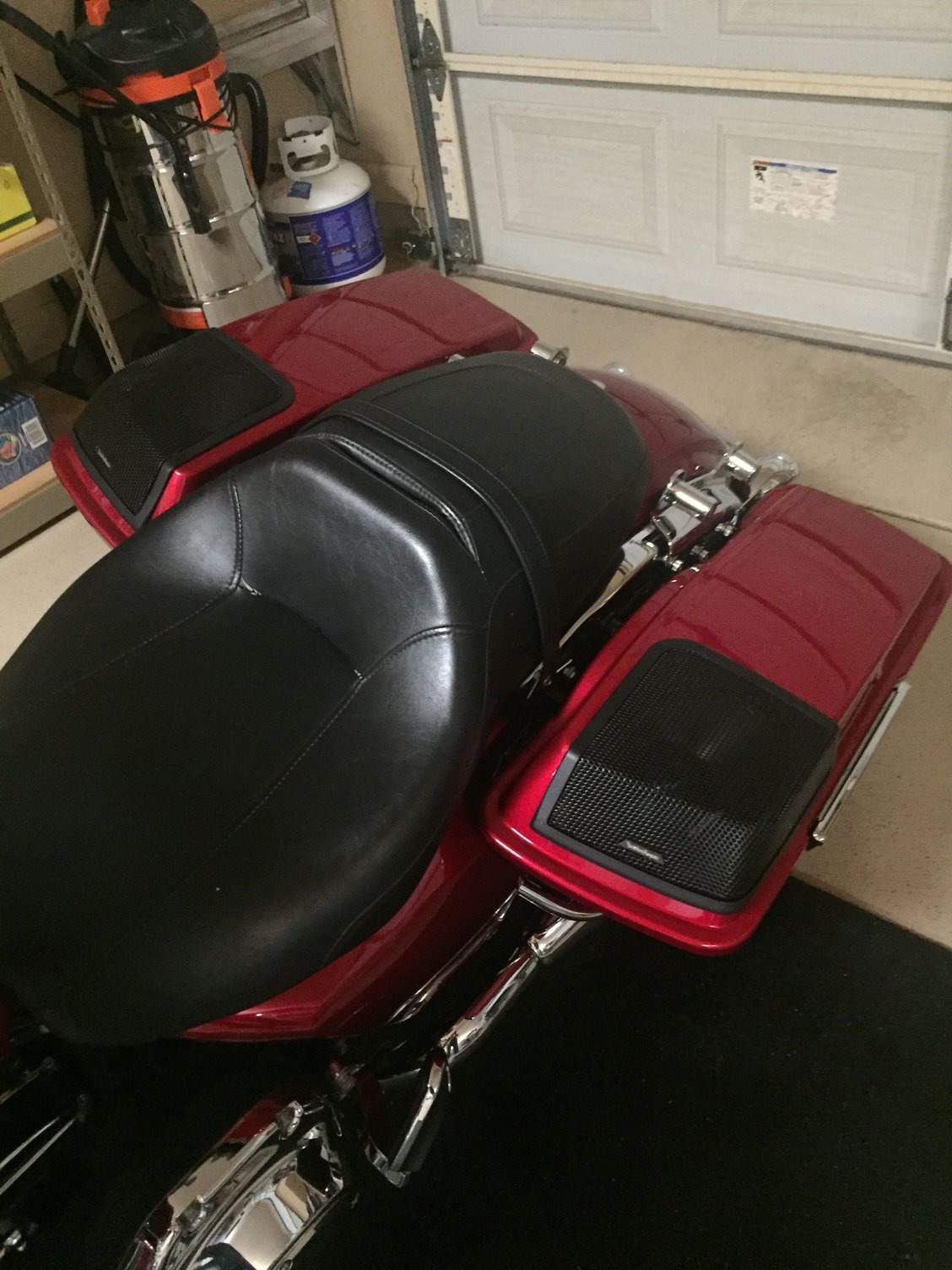

Not a pic of my install but you will get the picture here. My friend took the intact cutouts/templates and placed them over the lid. He drilled the holes in the circular holes you see on the templates and used a Dremel to cut along the straight lines on the template but instead of cutting all the way thru and rendering the template/cutout useless he simply ditched the template and freehanded the rest of the cuts (using a straight edge), thus preserving the template to use again on other lid installs. It came out perfect.
My guess is that RF was hip to the fact that many were doing this and promptly discontinued the grills and mounting hardware as a standalone kit. Now you can only order just the grills separately or order the whole kit w/speakers.
