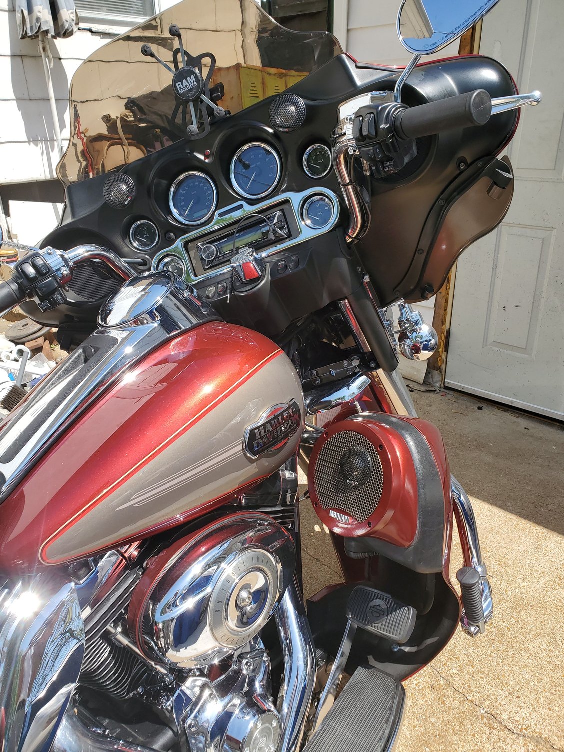

This is a reworked 6.5 inch 14 and up lower to accommodate an 8 inch in a wethead lower
