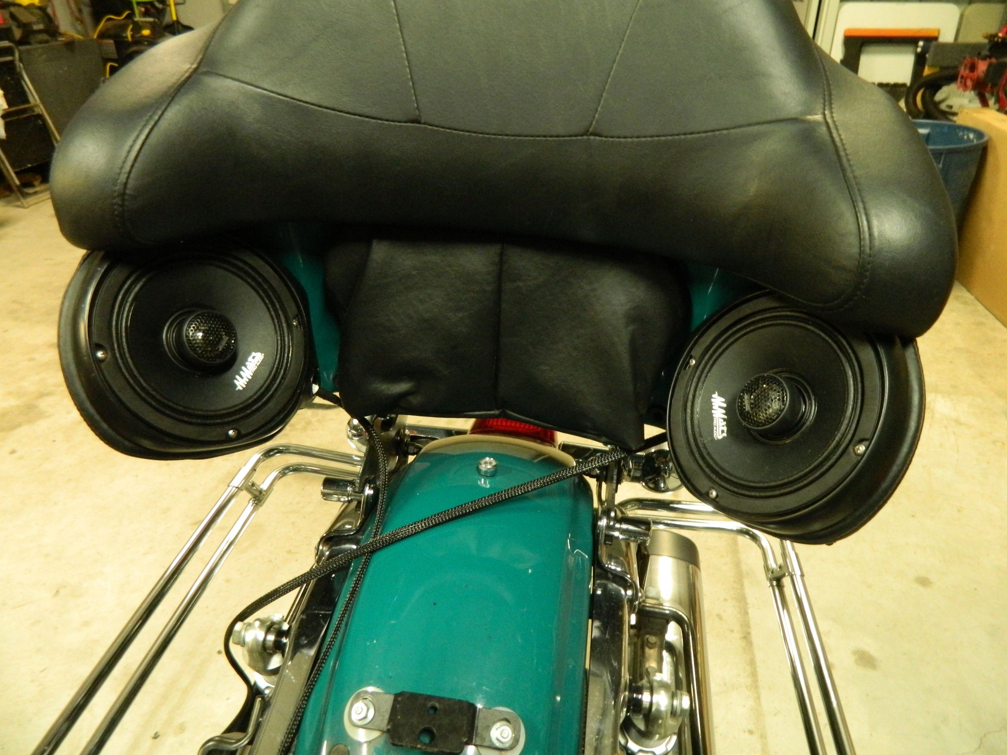

Heat gun on the pod. Heat push the speaker in, if it still conflict heat again.
Also make sure your wire connections are on the side wth the most space, This is the orientation that worked for me.

Minimal heat, yes I have spacers, left the passeger controls (but they are not connected - I never showed her how to use them anyway), and I have the covers that came with the spacer KIT. Spacer kit and covers were $99.

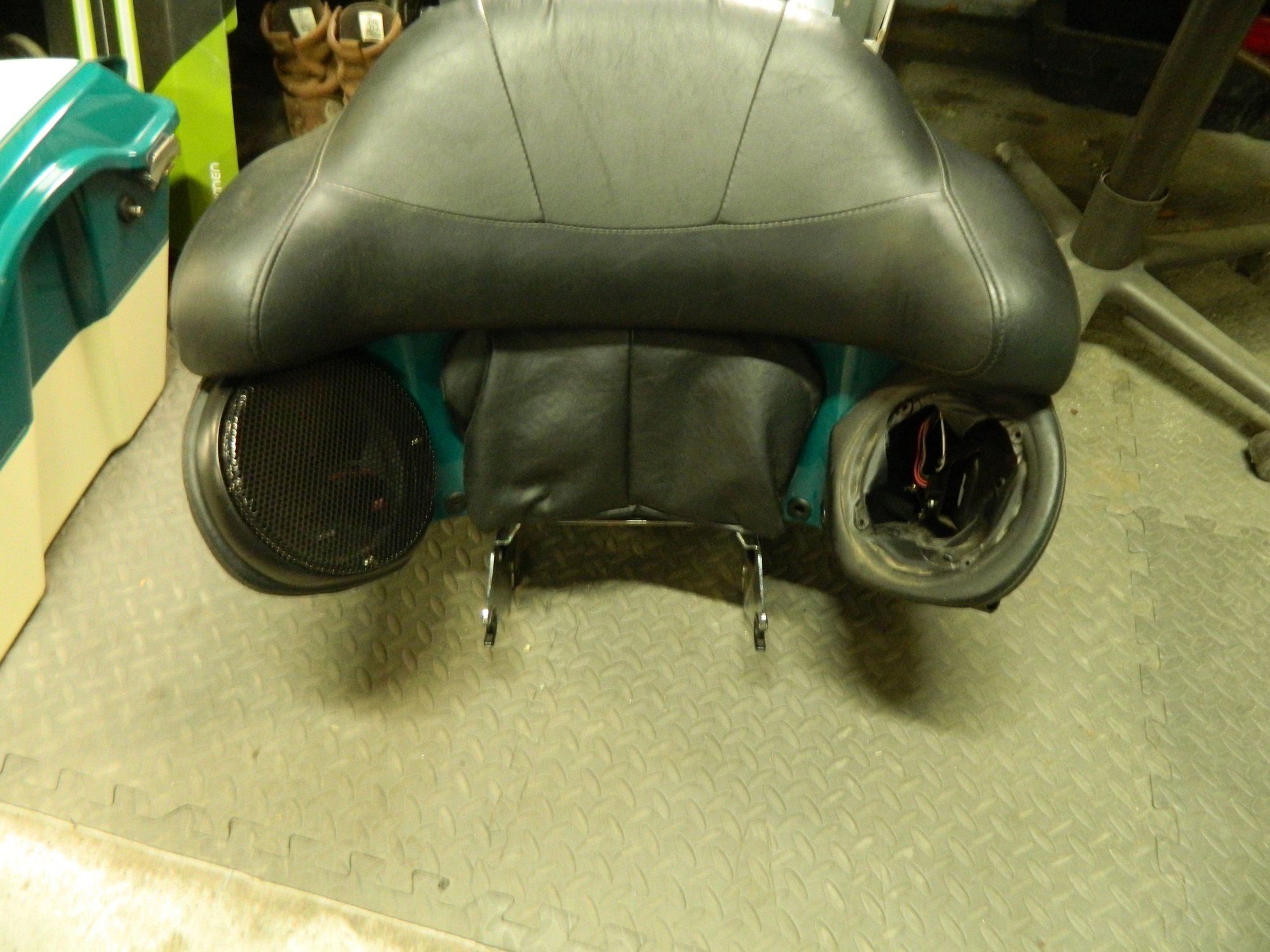

Better look of the spacer kit.
