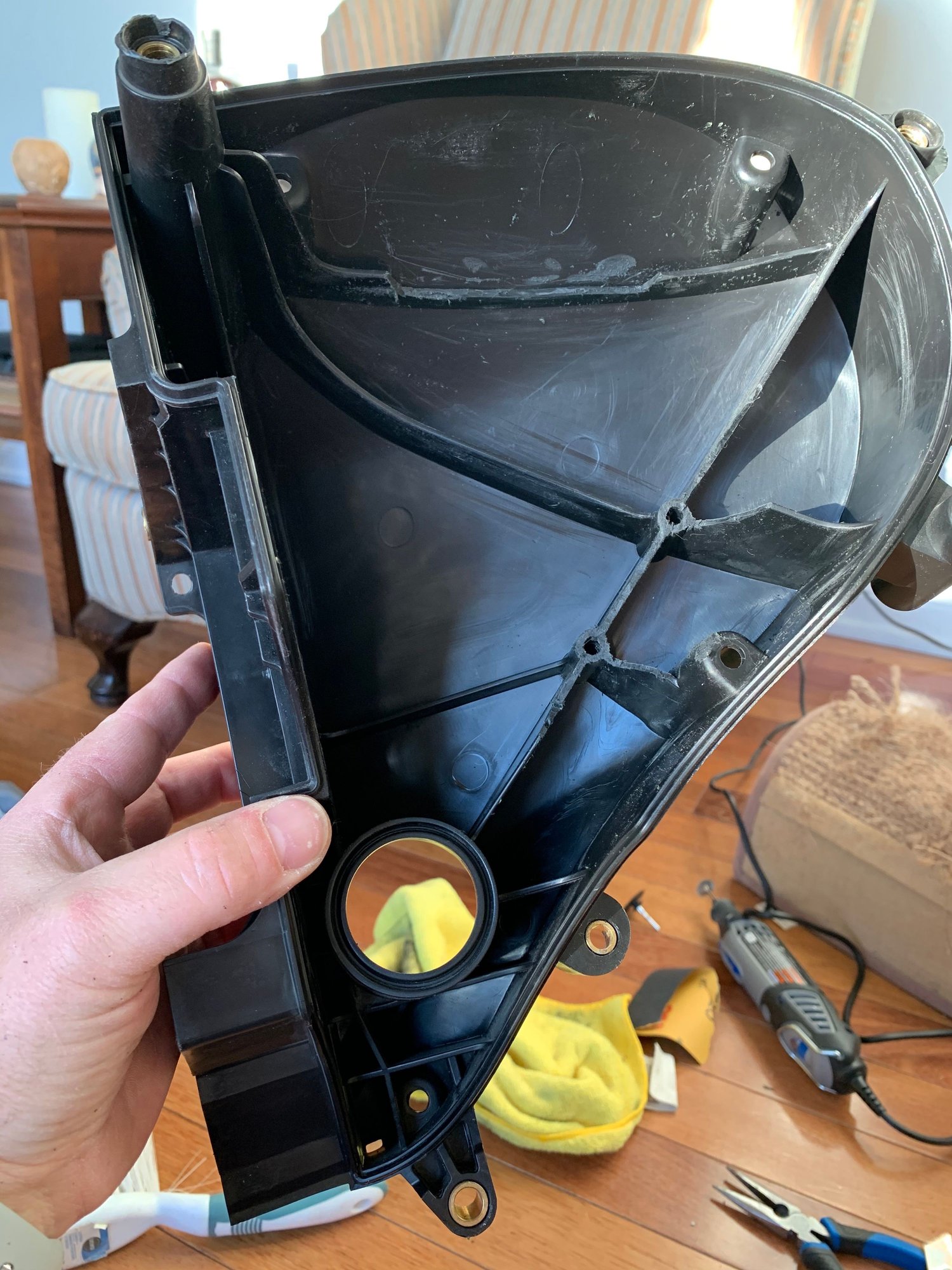

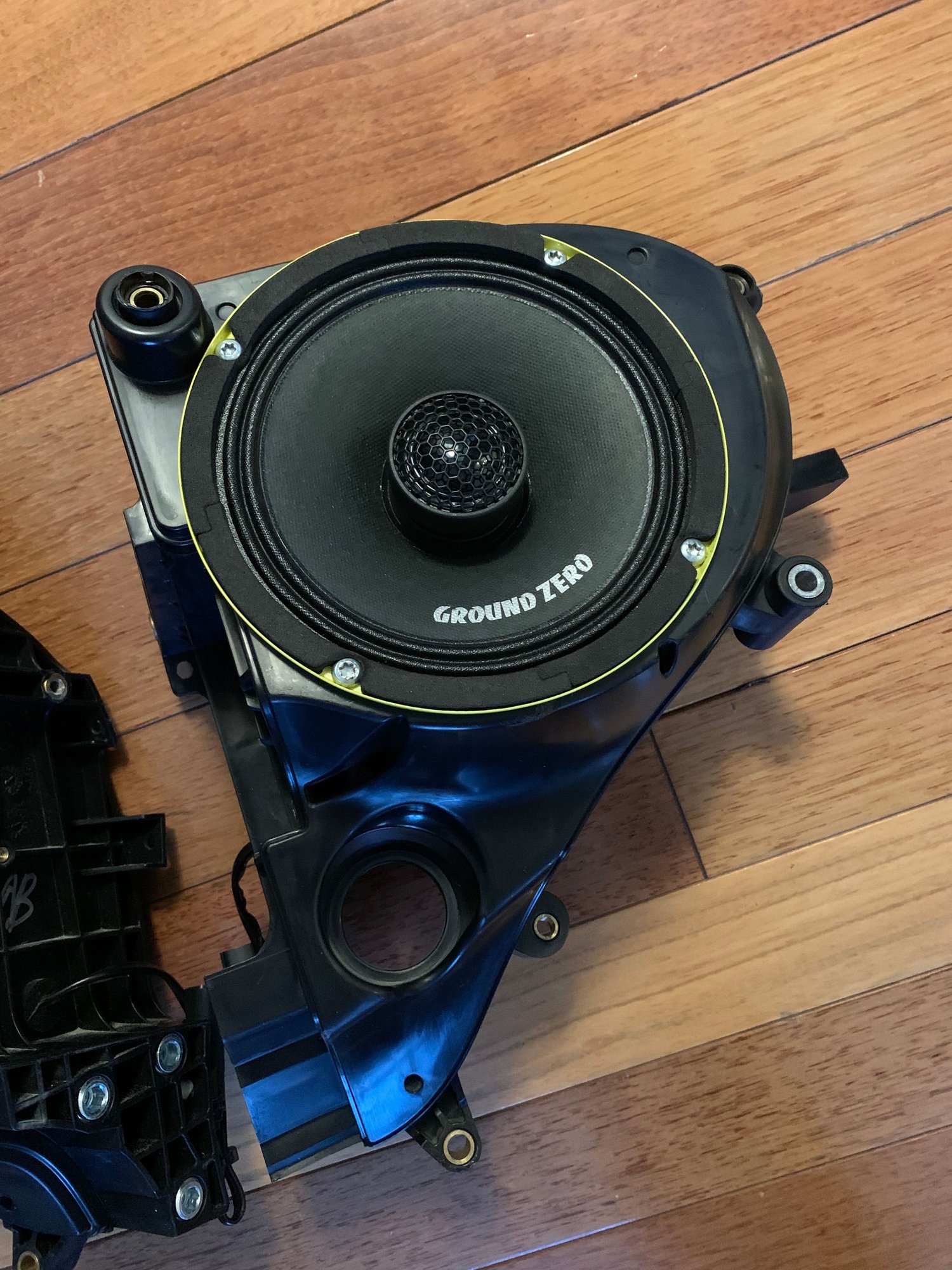

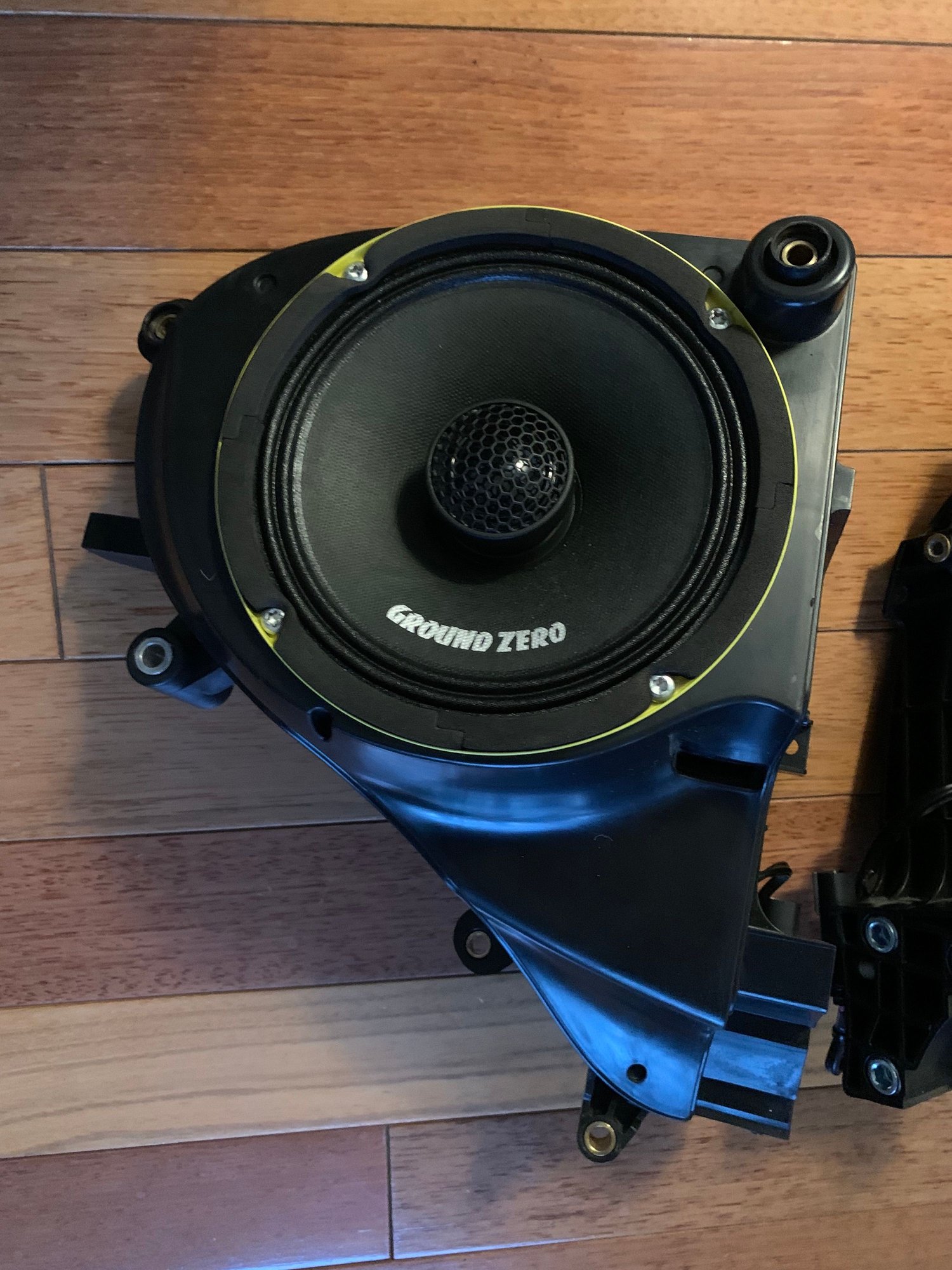

I just installed gz yellow 6.5s in my 2019. There is mild trimming to bring down the ribs but nothing crazy. Ok used a dremel tool. Took like 5 minutes extra max

I added these photos in a previous post. It's very easy to make the minor modifications to your pods. The pods are 2 half attached by a number of fasteners. Open the pods so you have easy access to the ribs inside. Use a Dremel or even take your time with a blade. Here are the photo's again.
