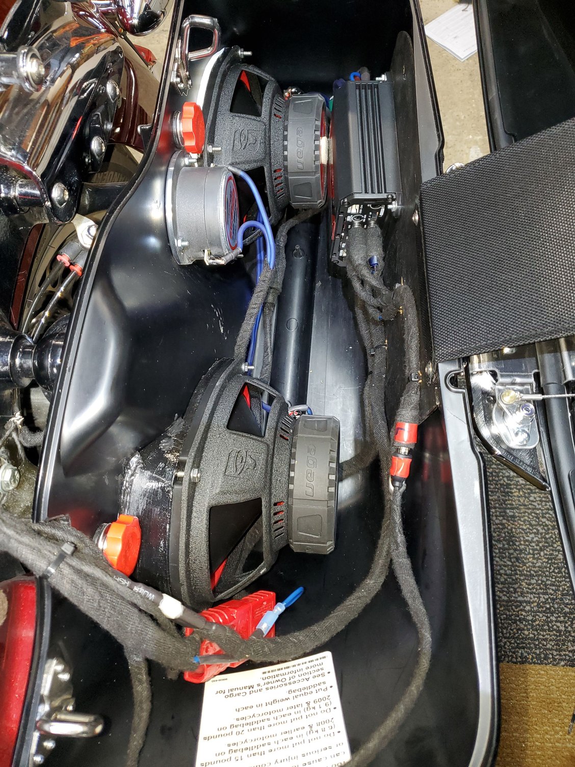

I installed 2 6x9's in each bag facing the wheels and 1 horn tweeter and replaced 1 tramps 800x4 to sound digital
800x4 got a little more room in the bag. either case
it looks like you will be changing your lids or adding a 10".
By the way these are 14 bags on my 09 UC
