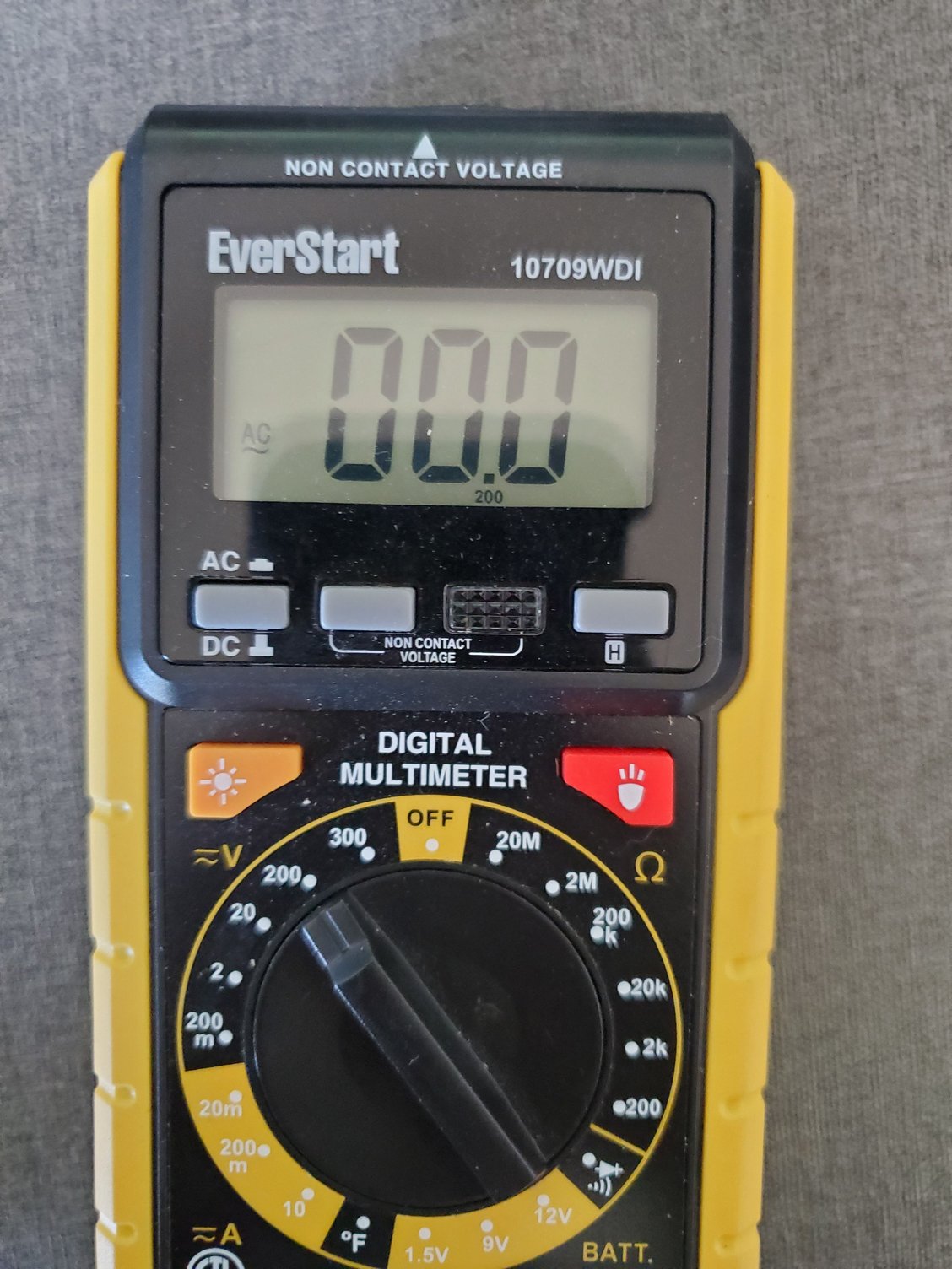

Multimeter is set too 200v meter setting and AC
Just an image of my MM to show where I have it set.
