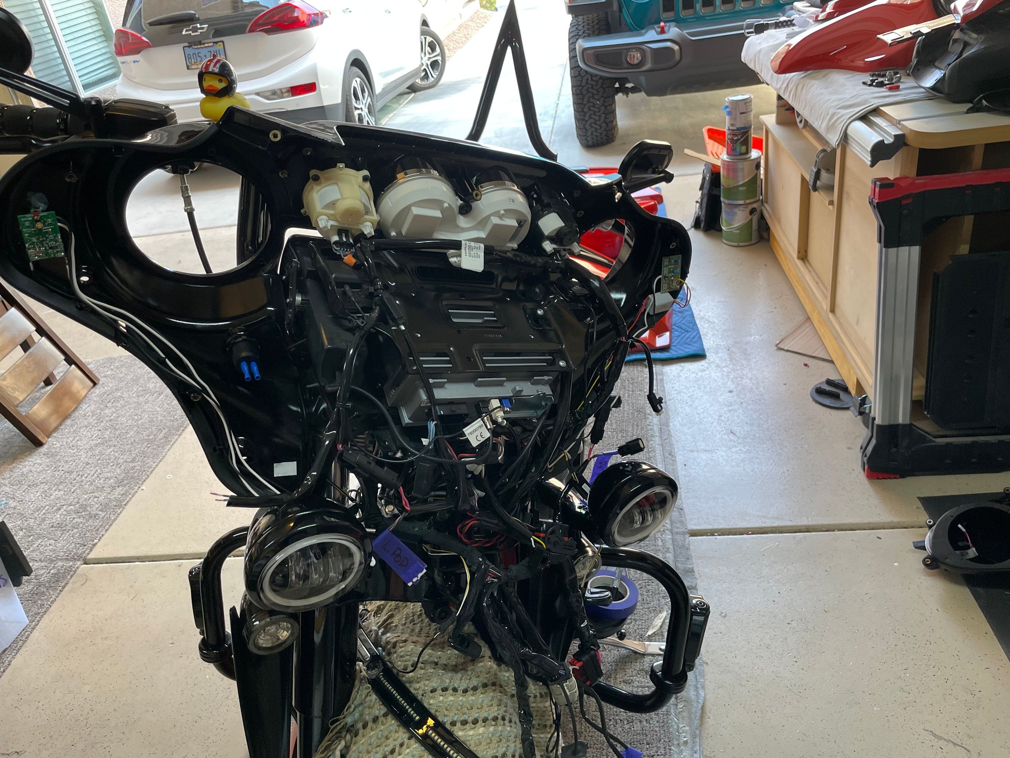

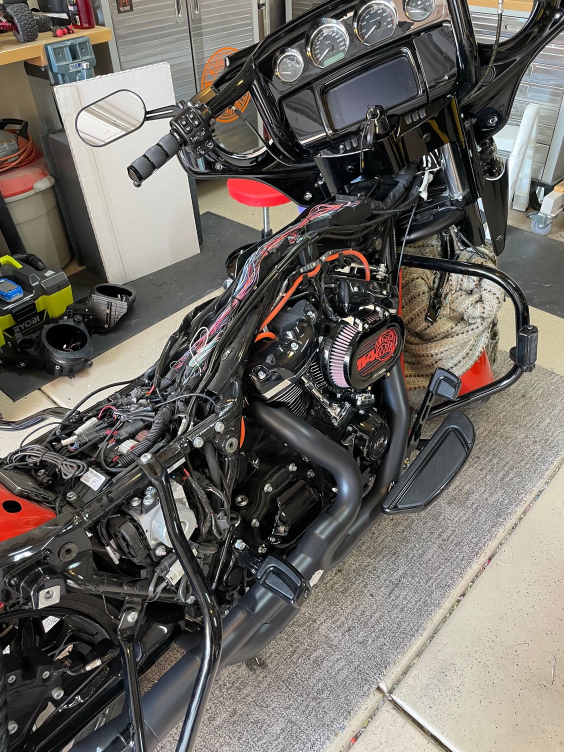

With that done, first step was to take bike apart and remove all the old Boom Stuff.
Removed Tank, Bags, and stripped out the old Boom II Wiring Harness
Removed Boom amp and rack, removed speaker pods for trimming
About all I got done on Day 1.

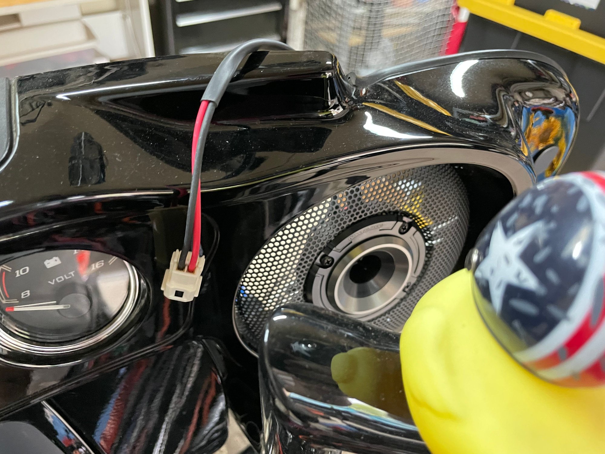

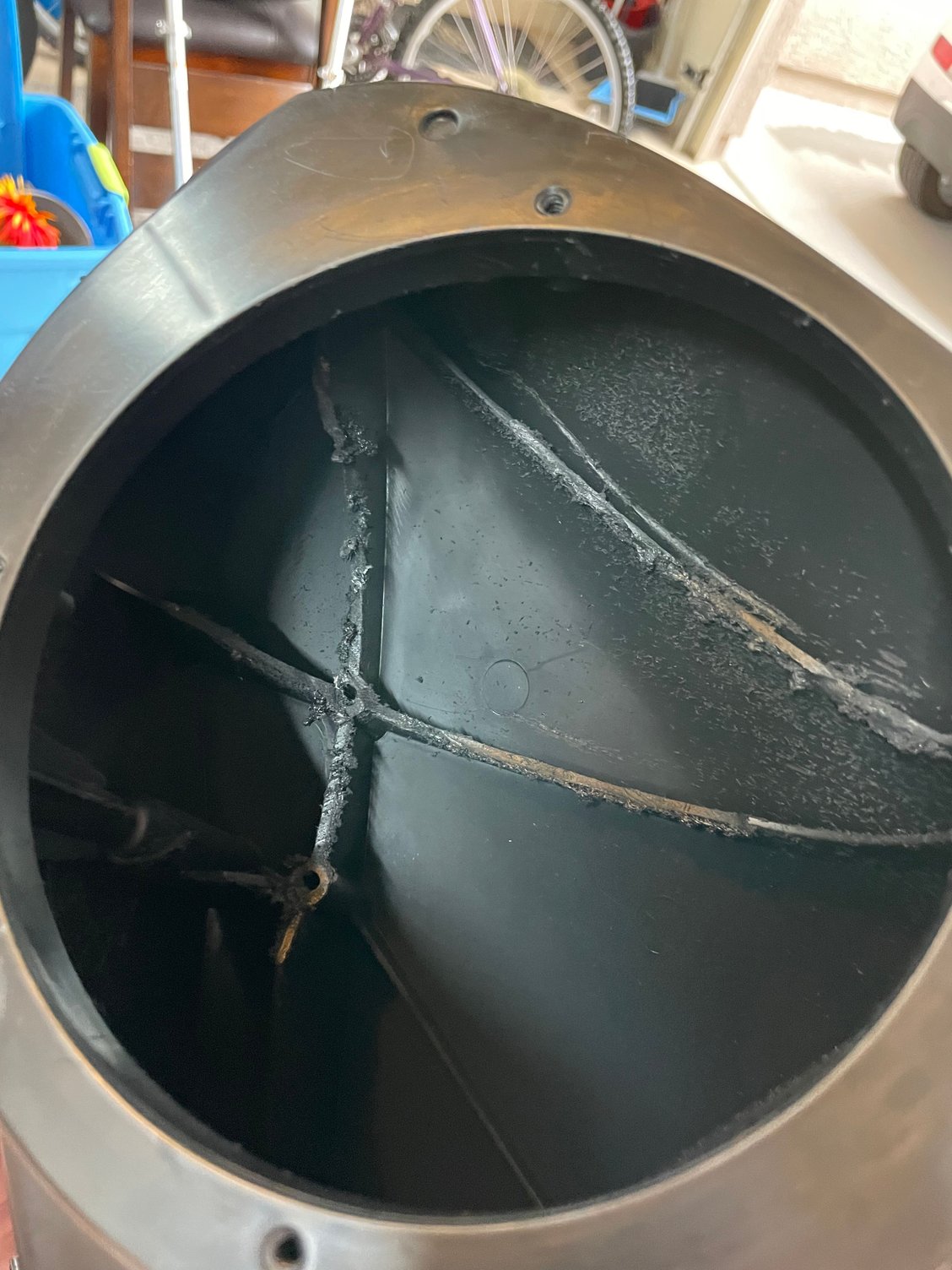

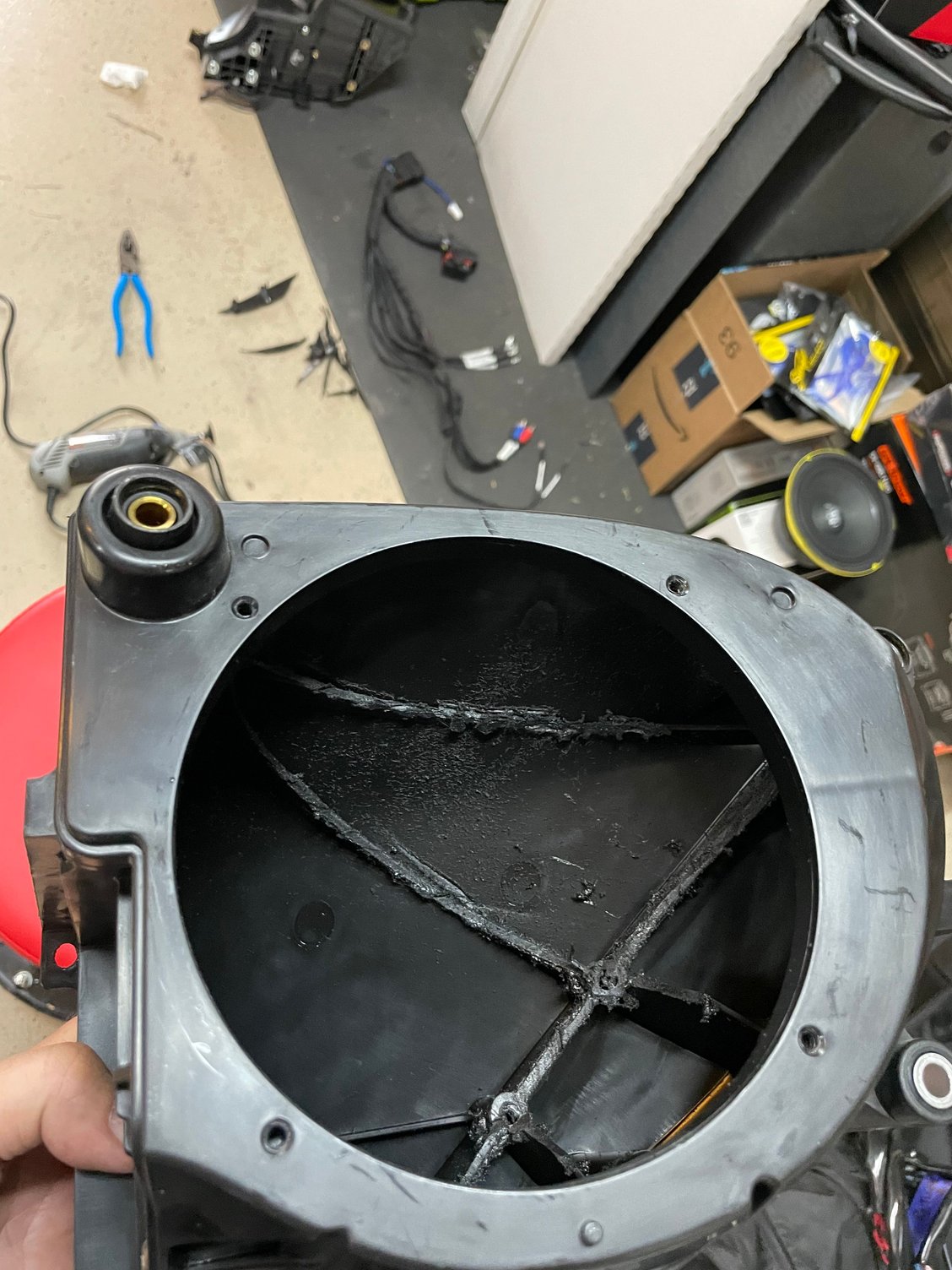

Didn't have much time today, but got the speaker pods trimmed up for the GZ Mid Bass speakers. Was not much interference, but enough to cause an issue. Probably cut out more than I needed to, but was limited by the Dremel and access. Only took about 10 minutes tops to trim them both. I have read a few things and am not sure whether to use polyfil in the pods, or seal them, or port them. I think for maximum flexibility I am going to fully seal the pod, then drill out a 1.5" hole in the back. For now I can just duct tape the hole covered, and this will give me access to add polyfil or remove it, and also have a port. When I decide which way gives me the best sound, I can do the final fix from the back without having to remove the pods again.
Also got the Horns and New Grilles fitted and installed. American Hard Bag makes a nice kit for this. Everything fit up real nice. Don't use the screws they sent, the heads are soft and strip easily. The OEM screws are torx and less likely to strip out. When reusing this type of screw into plastic i also give the screw one wrap of teflon tape, helps it hold better and not loosen up.
Took about 1/2" off the inner ribs. After Cutting pods are still structurally strong. Still need to go back and sand it all smooth and clean up the insides. Be easier when I take the actual pod apart to seal it tight.
Be carful when trimming the rib on the right. It is angled to the inner surface and a little tricky. Go too deep and you may cut through the pod itself.
Grill and horn from the front.

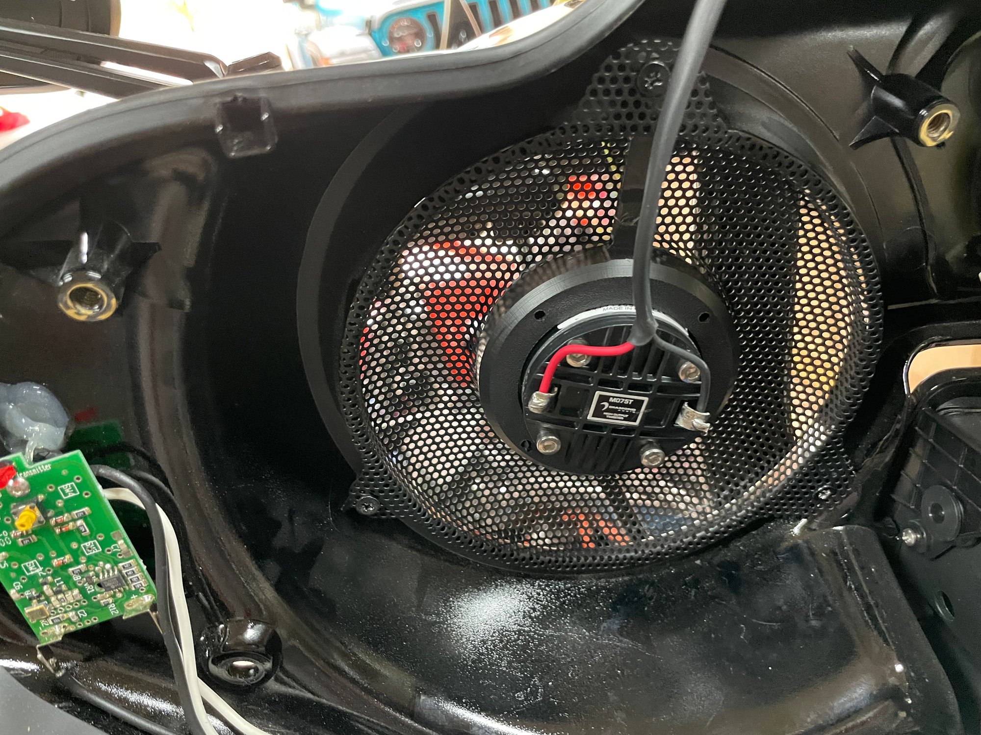

Grill and horn from inside. Screws supplied have very soft heads. Ended up removing them and going back to the HD OEM ones. One wrap of teflon tape and they fit nice and snug.
How do you have those speaker wires connected to the speaker terminals? Looks like you bent them? But no speaker terminal ends on the wires that I can see.
That is how they came wired out of the box. Looks like they soldered them down, then bent them flat.
