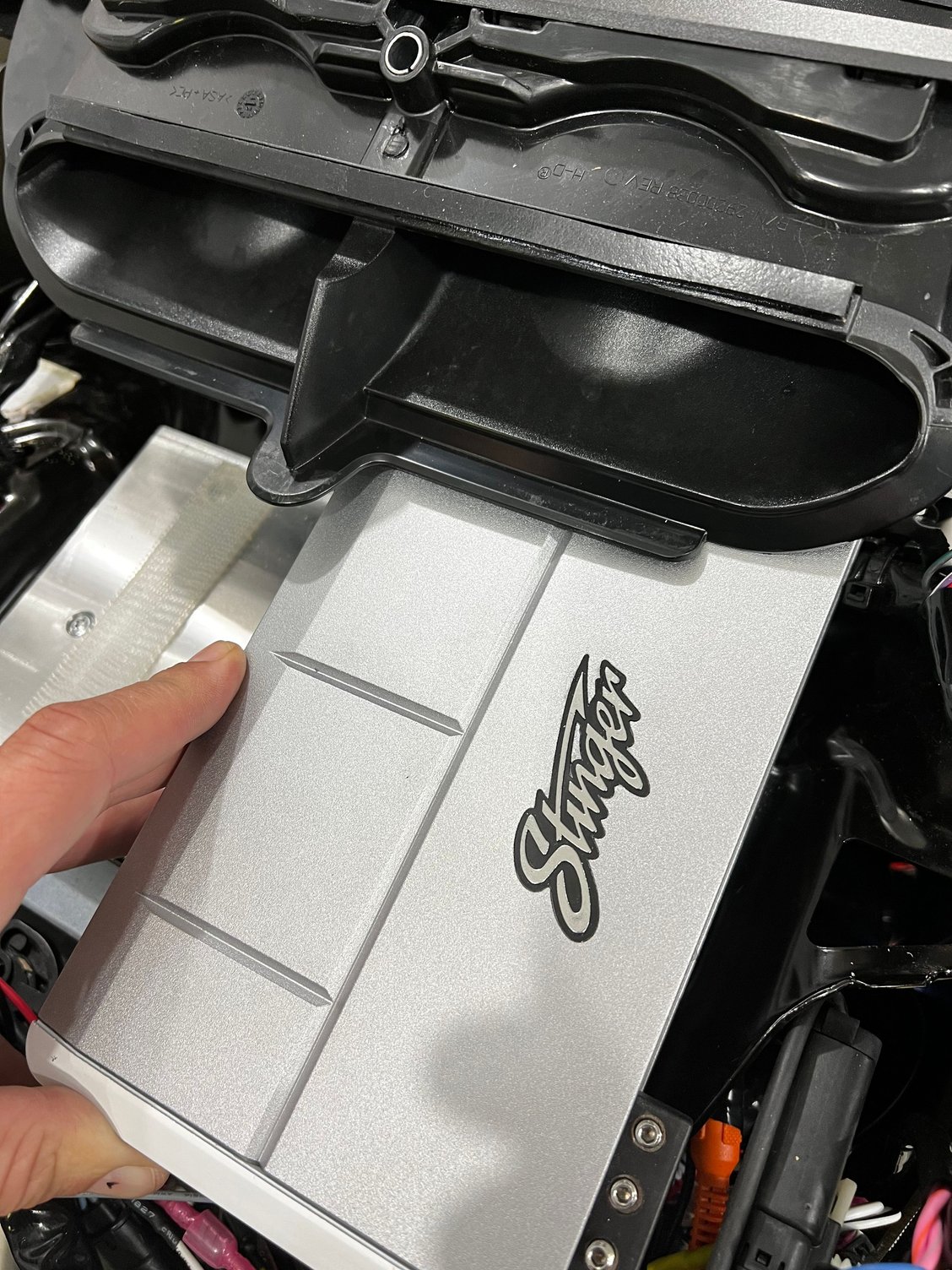

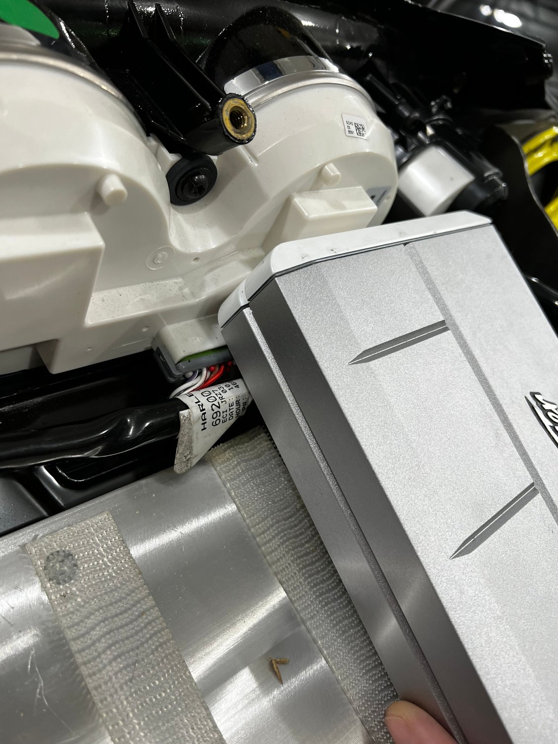

i did pull the fairing off tonight for fun and tried mowing the amp around to get some idea. If I place it at 90 degrees of what it is now, I could wedge 2 side by side. However, I need to angle them up. I have a 3D printer, so I could make a wedge base for them to sit on. However, I think where the power would go on on the left side amp is really close to the original tray. And looks like I’d have to trim the right side to get it to fly. Not sure I’m keen on that.

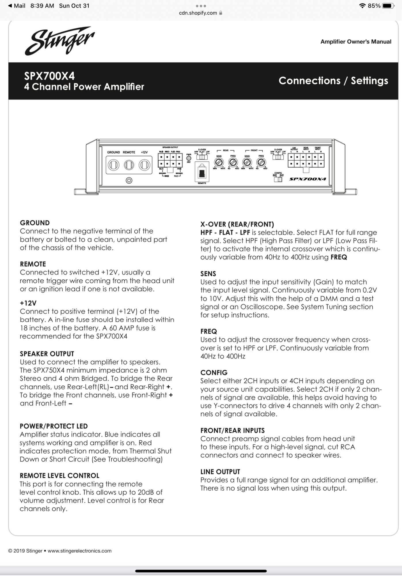

i can’t figure out how to insert the link on here ( bc I’m on my phone maybe ) the manual says only rear channels can be bridged. It sounds like you have been running it bridged on both sides with no issue so I guess that’s all that matters.
Here you go (see last line)...from the Stinger site.

it’s really weird because in the same page above it says 350x2 bridged. Apparently you can run it in 3 channel mode as well. Maybe a typo. Either way. Thinking I may be able to shove a RF 2 channel amp in the cubby.
