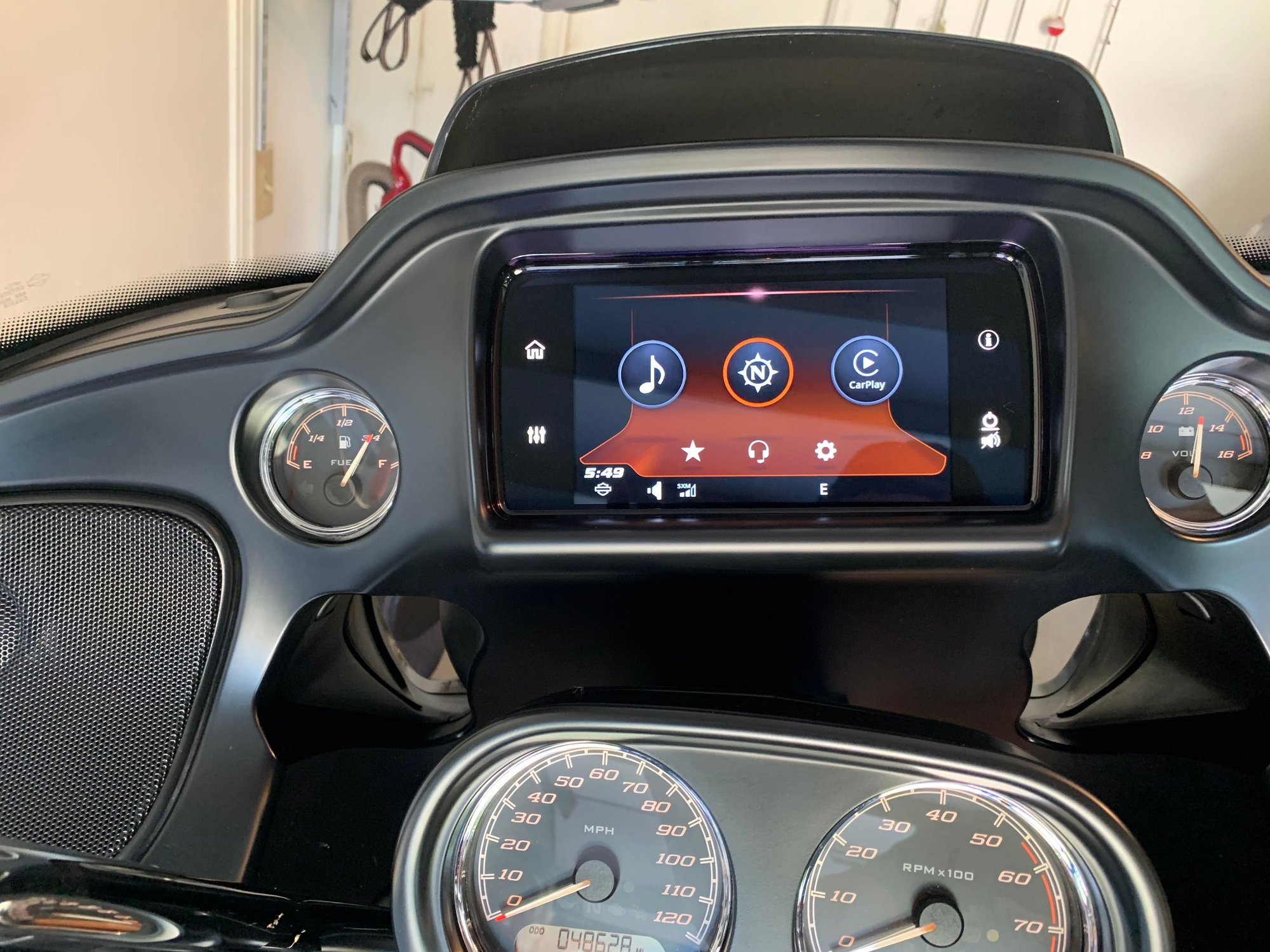

Your bike is capable right now, if it has the stereo that looks like the one below... which it probably does.
you just have to plug in one of the headsets that came with your bike first, and then plug your phone into the usb media cable on the bike. I would suggest you try that in the garage to be sure your bike is already "configured" for CarPlay. That way when you get the "jumper" and put it in, it is ready to go. Also, if you get CarPlay working first, with a headset, if you try the jumper and it don't work at first... you know CarPlay was already working with a headset... kinda helps in the trouble shooting when you go to install/test the jumper. Whoever helped you setup CarPlay in the car, get them to help you do it with the bike too lol Then, if you get it working with the headset first, I bet it goes so much more smoothly after you get the jumper in place. The only thing the jumper does is make it where you do not have to plug a headset in to get CarPlay to be available (You still have to plug the phone into the bike's USB media cable though).
That screen shot is what mine looks like when CarPlay connects and working right on the GTS head unit. When CarPlay is connected the "Phone" icon is replaced with the CarPlay icon, like it is in that pic. You will still have to plug the phone into the bike's usb media cable. Then Pandora should work on your bike (thru CarPlay) like it does in your car's CarPlay. You can use the bike's Navigation if you want, while listening to Pandora lol CarPlay doesn't "take over" everything, basically it just gives you other options in addition to what you already have.
