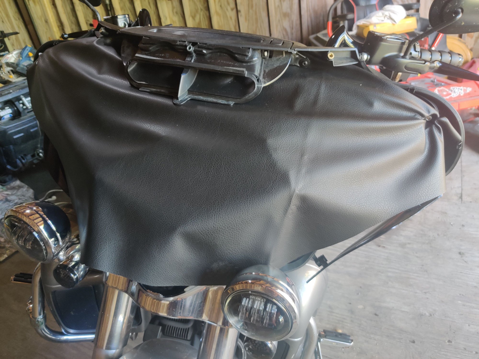

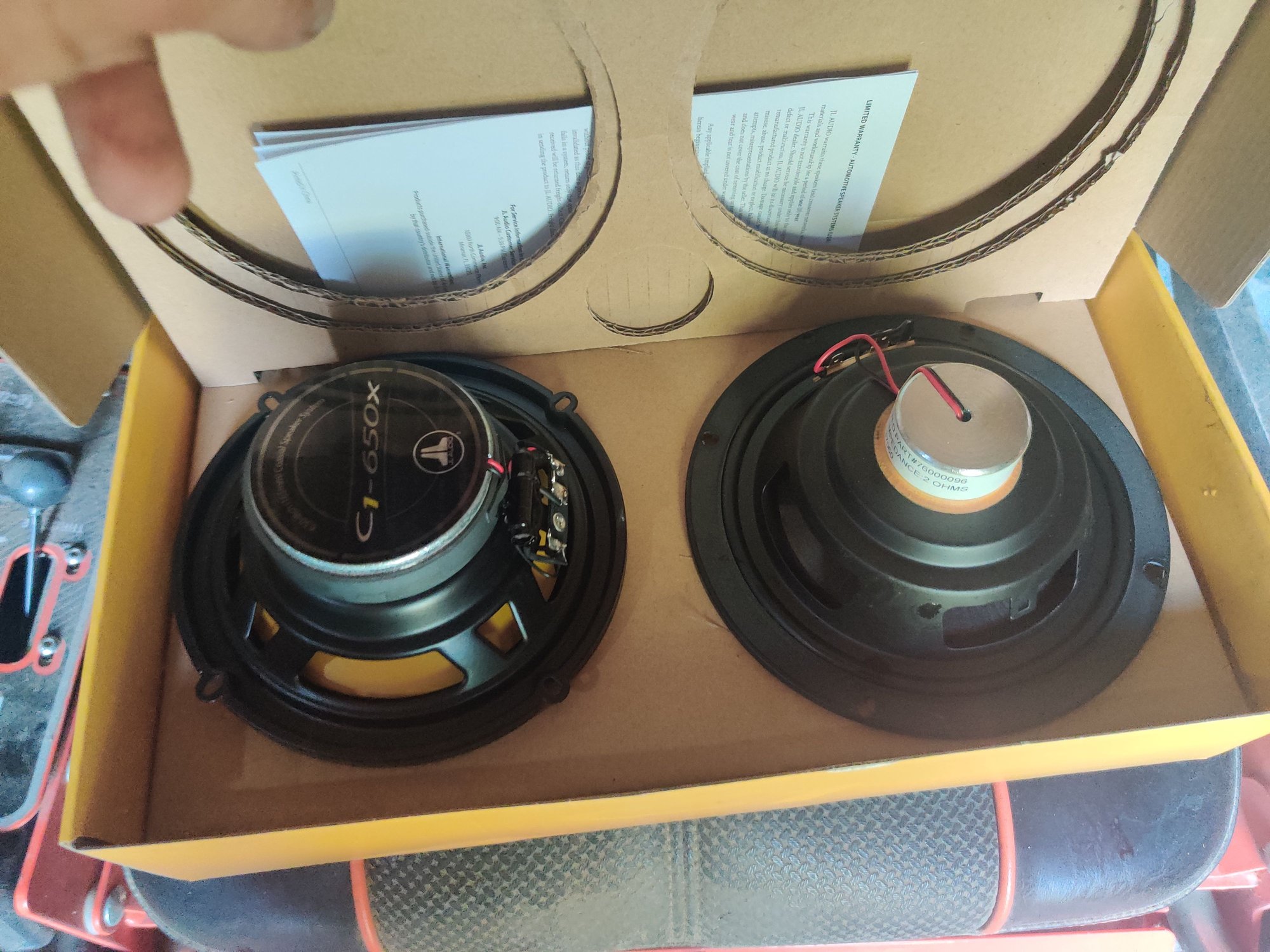

When I got home I put a 20 amp instead of a 15 amp in. Probably not a good idea I know... I swapped my factory speakers to JL C1-650x and put a rain cover I made under the fairing. The JL speakers fit perfectly without any mods or adapters. I had them and was already planning on doing it.
