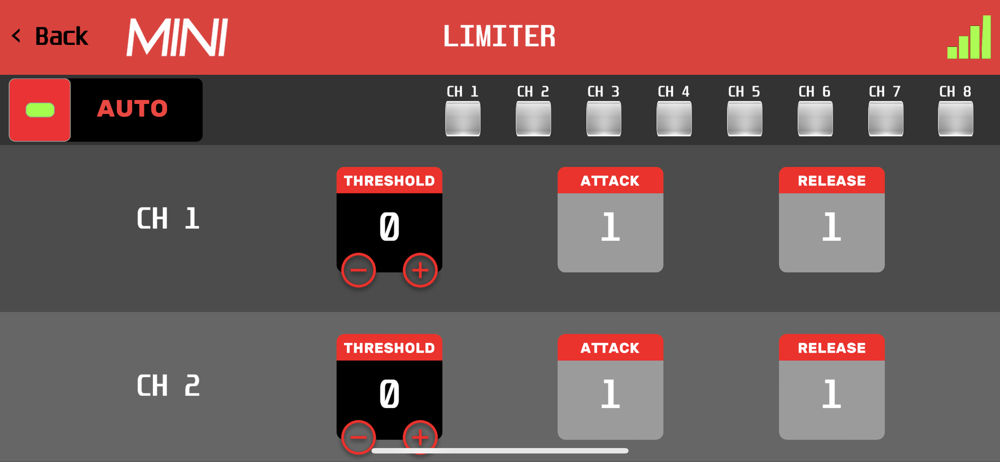

i have all installed but with bad tuning
800 sound digital amp to front ground zero yellow baskets + rear Hertz sx690
sec 800 sd bridged to hertz svl in the bags.
today i installed dsp hki mini , is there any help of basic levels tuning to start from ???
im kinda have all black from not manage it .

Hi pass both the 6.5's at 80hz and the 6x9's at 65hz. Bandpass the 8's at 50hz HPF and 500hz LPF. This would be a good place to start, you are light on power on all your speakers so you will probably can go a little lower on them once everything is broken in. You also might want to play with lowering that LPF from 500 down to anywhere around 250hz once you see how everything blends together at your upper midbass low midrange frequencies. If you aren't tied to your amps a 1200.4 2ohm and a 1000.1 2ohm would be better power for your setup.
