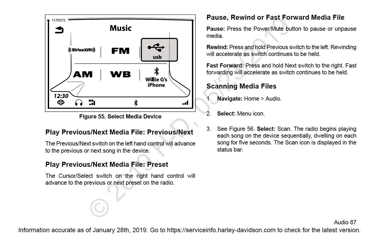

Go to your audio sources and pick the USB and it should show you the songs.
I imagine you are already doing that and not seeing what you should...
See if this works, in the garage turn the ignition on, and once the head unit is powered up, then plug in the USB stick. Along the top it should have a some sort of dialog about scanning or indexing the drive. I would leave everything alone while completes that, then after its done, see if you can find your music where it should be. If so leave the USB plugged in, or you may need/have to go thru that again. I had a USB a couple years ago with several thousand songs on it and it seems like I had a lot missing until I did that and then they were all there. Seems like it took like 10 minutes or so for it to index everything... and sometimes I would have to go thru it again if I unplugged the drive at some point. I don't know for sure thats it... and its been awhile since I used a USB stick, with the GTS I just use my phone/CarPlay now.
