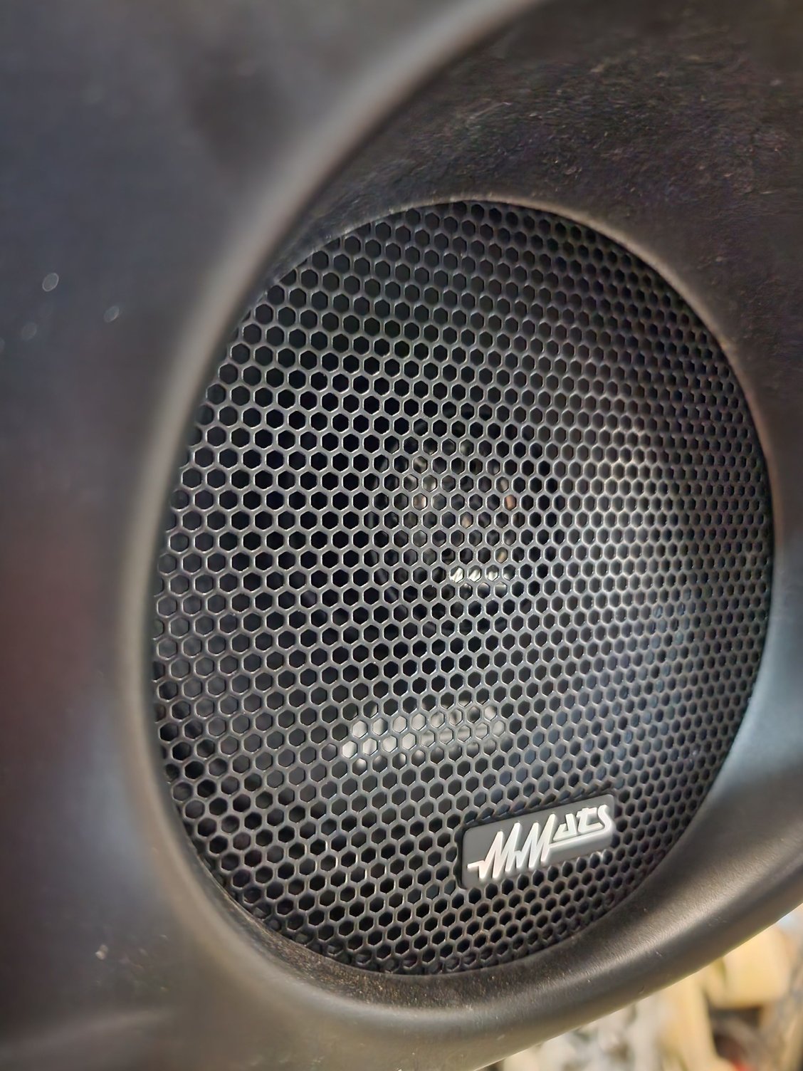

Had to do lil trimming but got the Mmats grill to fit.
Need a recommendation on a head unit to replace factory one before I can button it back up and go on a test ride.
