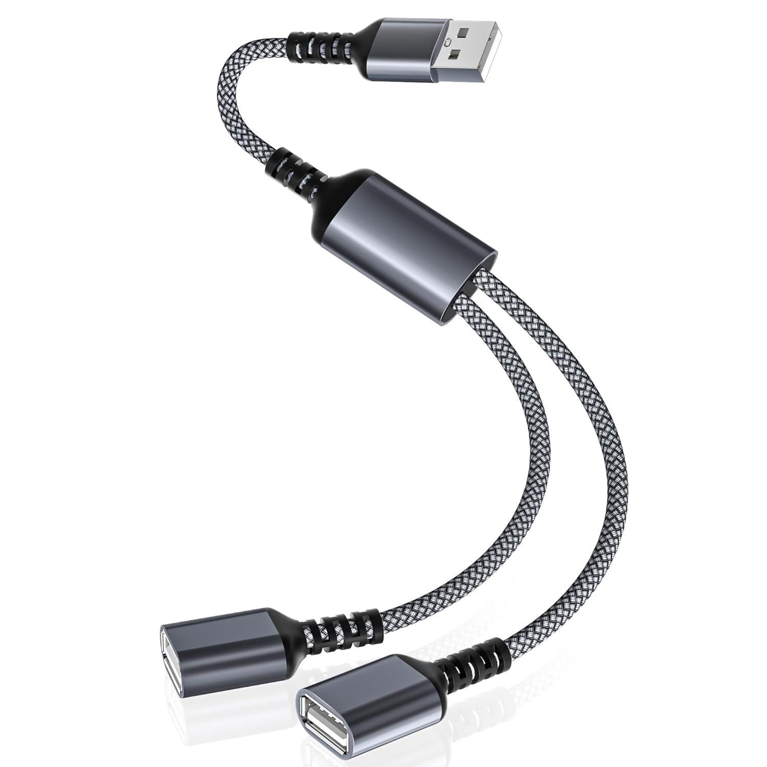

I don't understand why you would need the USB On-Off Switch. My cable is in my trunk. I have a splitter in the trunk so I can run my phone and my flash drive for music.
Sometimes, I plug the phone into one part of the splitter. Other times, I keep my phone in my pocket and plug my wireless adapter into the splitter.
I go out to the bike, turn the switch and let everything boot up. Are you running into problems if the phone boots up before the bike?
Just curious
Just curious
That is exactly why. For some reason I can't fathom, unless I connect the phone to the USB cable after the infotainment system is up and running the infotainment system won't start Android Auto. When I had the phone on the handlebars it wasn't an issue but not so much once I moved it to the tour pak. BTW, the splitter is a good idea; I have one also for the same reason.

How do y'all have the splitters set up? After giving up on the long USB cable I put a small USB hub in the media cubby so that I could keep the Android Auto puck plugged in with a flash drive with my music on it. Are y'all putting splitters in the tour pak? If so what type?
I am running my splitter in the tour box.
