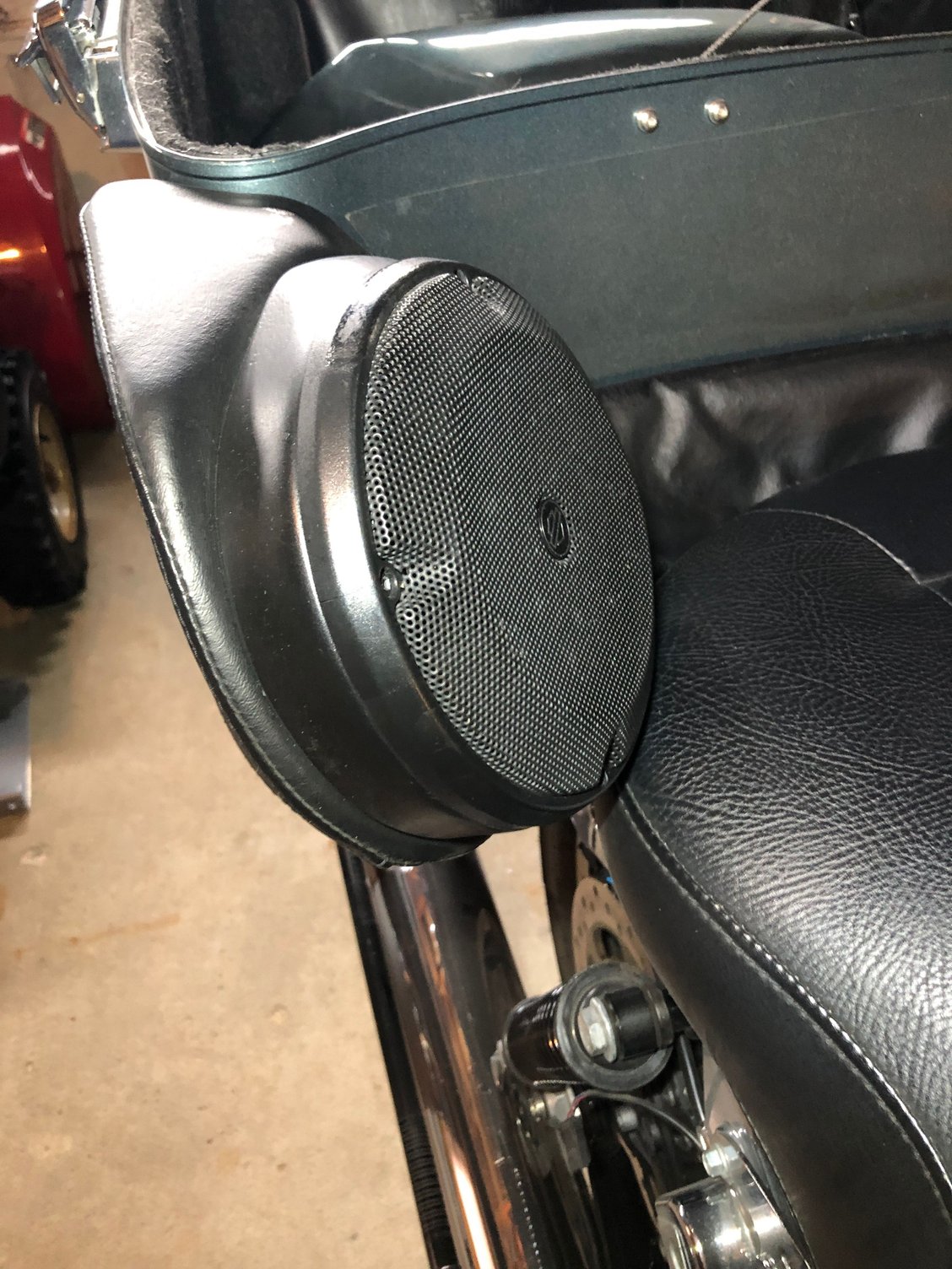

Originally Posted by Roadie13
Curious what grill you used with the v twin adapters. One of mine decided to go awol on a highway out west and haven't looked into replacement options yet.
I used some HD grilles I had from my previous bike (pic below). It was tricky but I got them to work. It definitely tightens the passenger seating area but my wife is a "slight" lady and fits back there no problem at all.
On another note, I've got a couple of the V-Twin grilles sitting in the box they came in doing nothing. If you'd like them n/c (just cover the mail), PM me your address and I'll send them to you.
