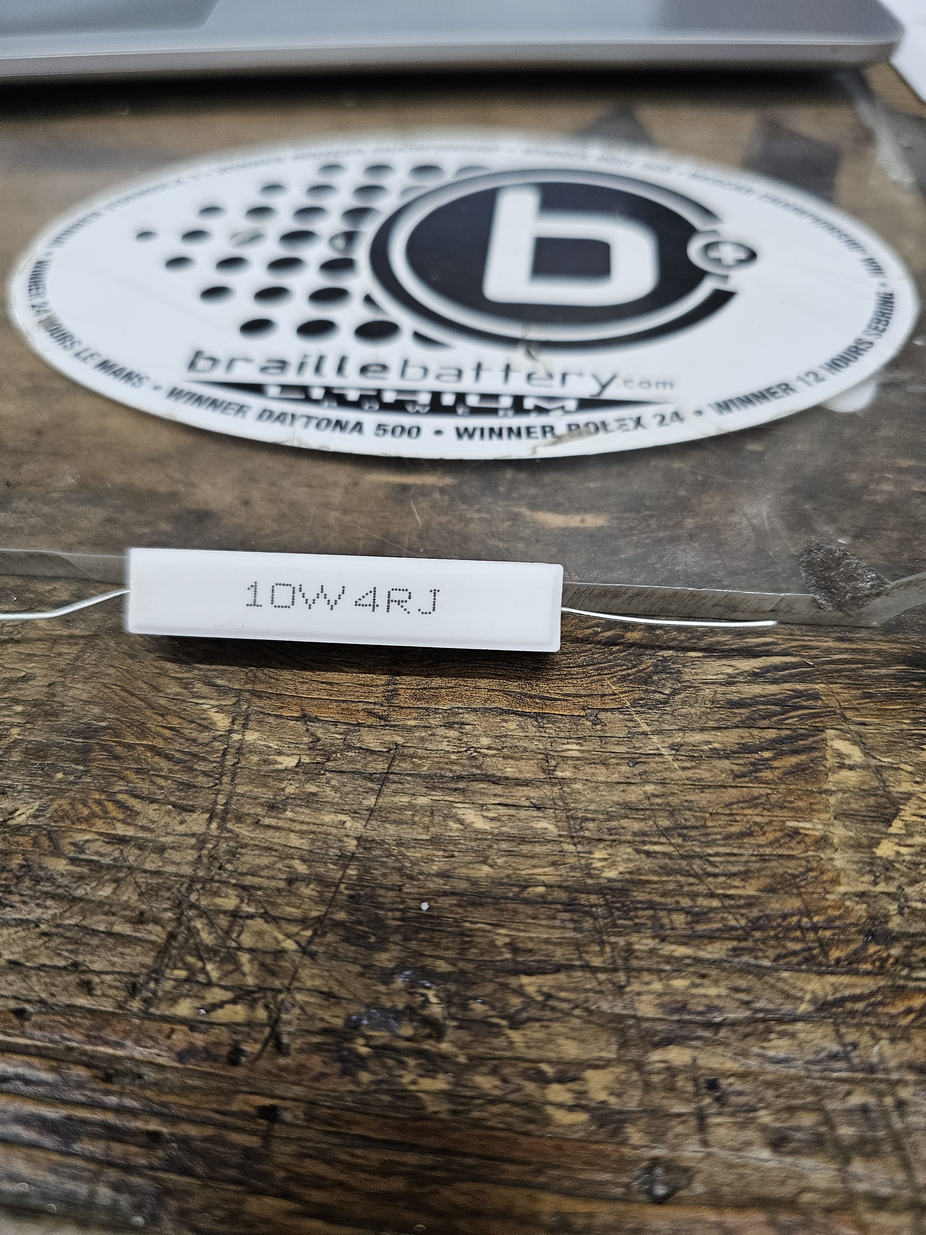

This is a resistor from the CICADA CH65

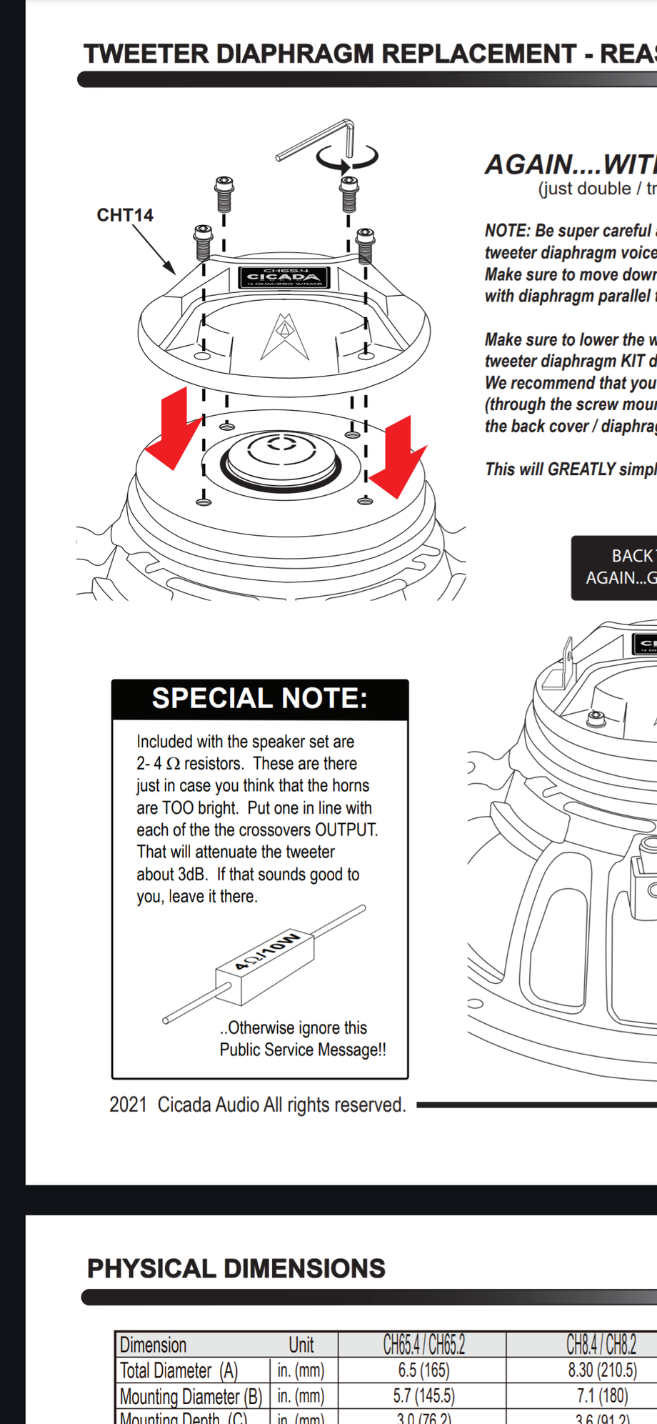

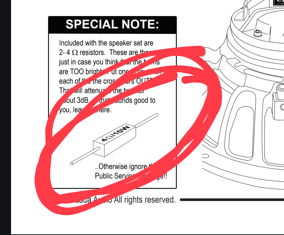

Originally Posted by Glenn Gorman
Thanks for the info. I still don't see where it shows 10watt. I ordered the 200watt because of the amps power.

Resistors are included and they are 10 watt
