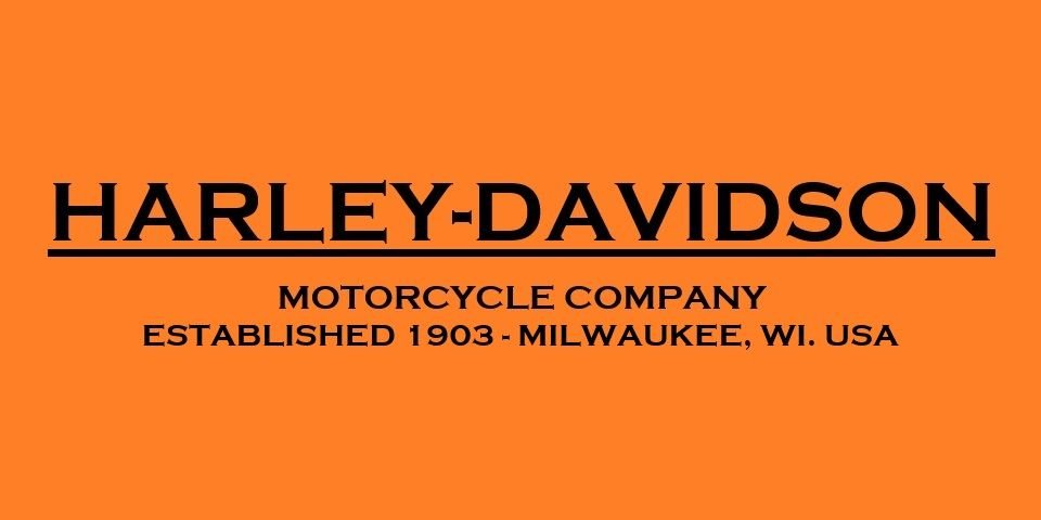

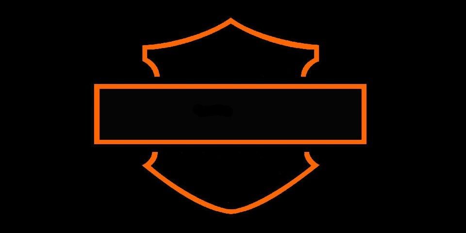

Do you have file for the jpg you could share?
Originally Posted by Jumpman

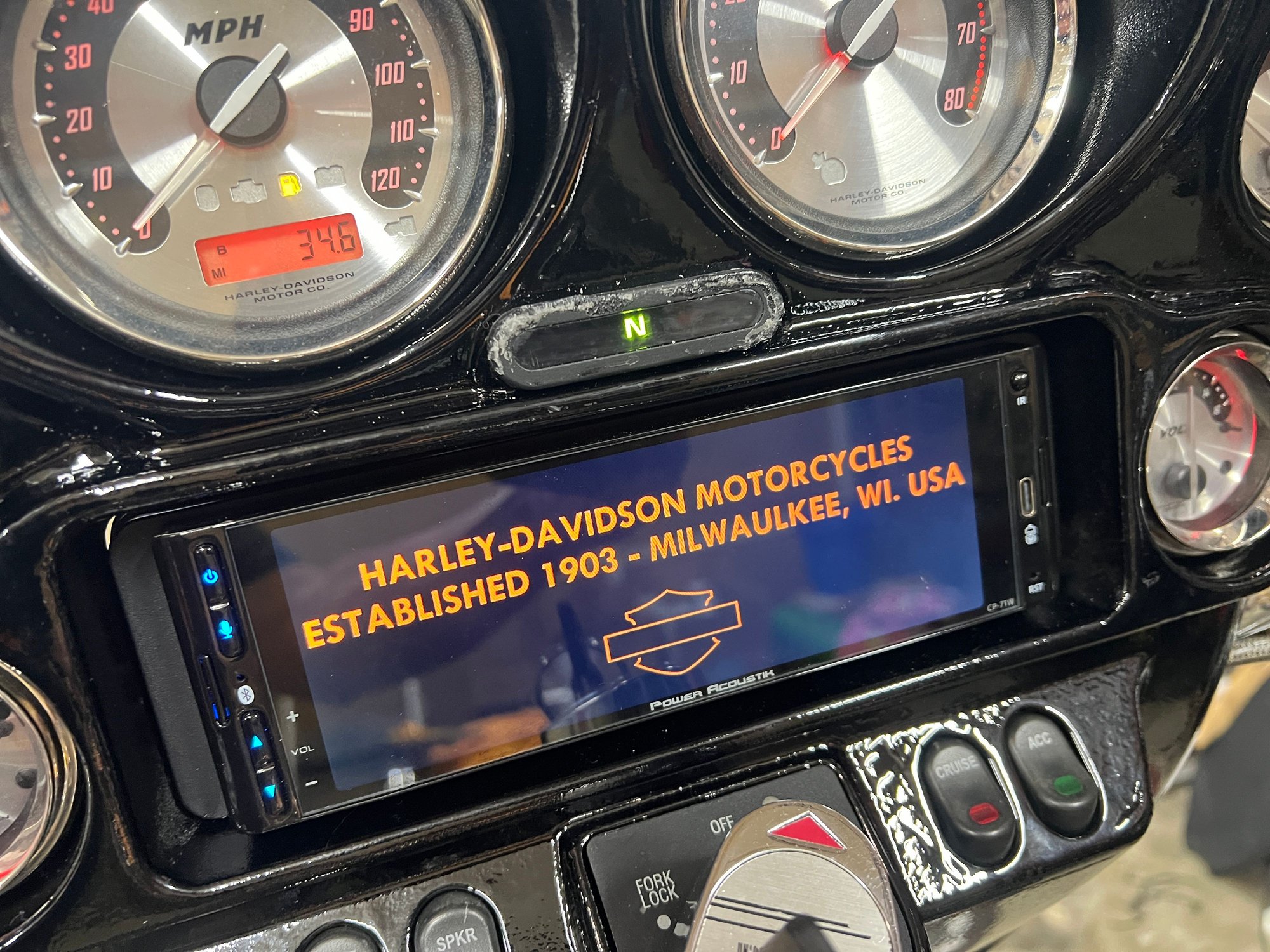

I’ve been working on some audio stuff on the bike.
I fount that the new Power Acoustik CP-71W Firmware Update allows the user to change the Image that is shown when the radio powers-up.
So, I made a Harley-Davidson themed .JPG that appears while the radio boots-up.
I also made a Bar & Shield Logo image that I added as a Wallpaper/Background.
pics ⬇️

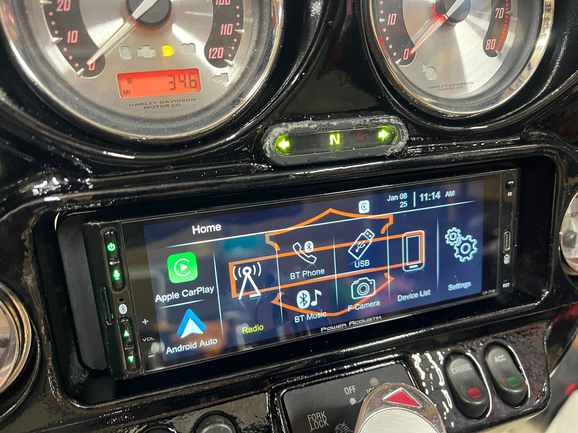

My only concern with that particular unit would be the exposed usb slot in rain or washing. does it have a rubber plug to insert when you don't have a cable in use?
Sorry for the long wait for my reply, I haven't logged-in for a bit.
Radio seems to be holding-up just fine. I've not been caught out in the rain, so cannot speak to how that will impact it.
The screen is, obviously, smaller than I'd prefer...but it's usable.
My primary objective was twofold - Get easy access to Apple Music via CarPlay, and use CarPlay to allow me access to my 'Smart' Garage Door Opener thru CarPlay.
Both of these objectives have been satisfied. I like it.
The Mapping feature thru CarPlay is nice. It's not as easy to view as the larger CarPlay screens in my cars...but it is definitely usable.
I'm not sure I would select this radio if I were someone who was constantly riding in the rain, but that said - for the price it may have still been something I would have tried before spending a ton of money on a 'weatherproof' Head Unit.
Here are the Background/Wallpaper Images I made.
Instructions for loading them on the CP-71W can be found on The YouTubes. It requires renaming the Image you're going to use.
