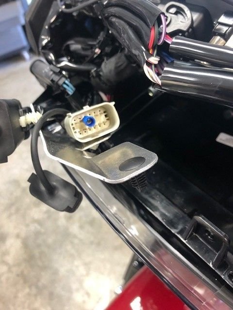

All you need to do to get carplay to work on a GTS is connect the two pins in the whim connector. I've done this on a few bikes including a 21RGS and 23 RGS. It works better than a whim. But this method is only for those that don't want to connect/pair a headset to the GTS. Also, with this method, you can use just about any wireless carplay adapter. Once you set it up, anytime you turn on the bike, carplay will automatically come up if your phone is not locked.

I added Apple Car Play without adding a mic.
