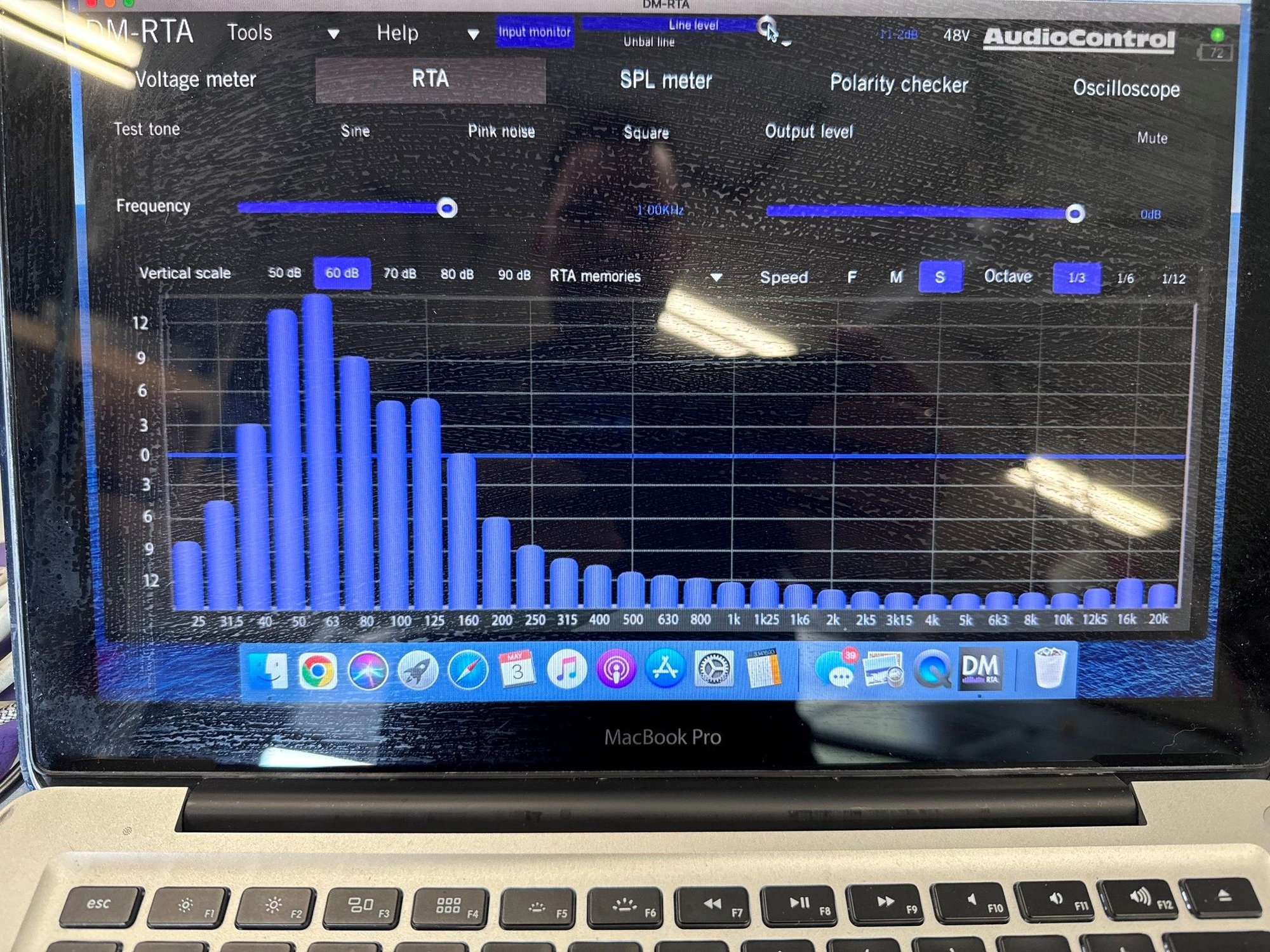

Yeah I've done 2 set ups in the bike so far. I used the NVS piggyback setup (ARC PSM Pro).
First setup was a SD 800.4 running Audio Dynamics 3000 series (2 ohm) in the fairing and lids.
Once an amp rack came out, I switched it all up. Curlys amp rack (Street Glide) with a Cicada BDA 2000.4, Cicada CH in fairing and Cicada CHX in lids.
Here's what the factory EQ looked like with everything flat:

Always wondered what that curve looked like, hadn't seen it posted anywhere else. The good old Harley built in boost.
I've read good things about the AD speakers but have never heard them in person. How do they compare to the cicadas or other "common" bike speakers?

They are a good speakers. Just have to be careful on power and crossover point. They will pop easy. But cross them at 120-140hz and they sound great.
As compared to Cicada CH's, I like the Cicada better. They play lower. But, they should sound better for $200 more a pair.
