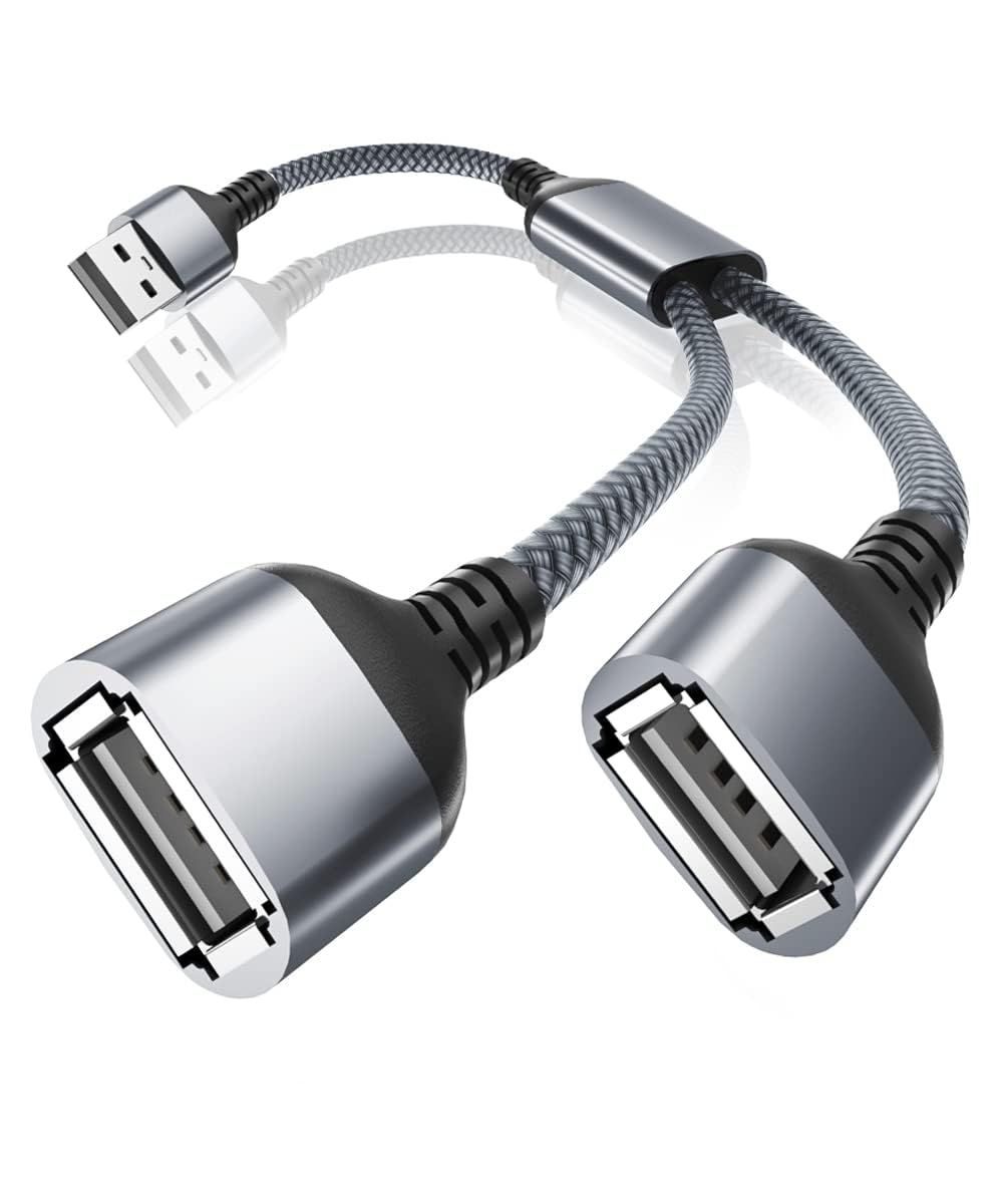

Try something like this. It is what I use.
Itramax USB Splitter 1 in 2 Out 1FT Y Cable,Double USBA dapter,USB Male to Two Female Extension Cord,Dual Port Extender Hub,Data Power Charger Split for TV,PC,Laptop,MacBook,Keyboard,PS4,PS5

That doesn't seem helpful

Sorry - not sure why you can't get the image. This is from Amazon for $5.99. Go in and search for USB splitter
Sorry, thought you were trying to be funny... Telling me I needed (among other things) "....TV,PC,Laptop,MacBook,Keyboard,PS4,PS5"
Then I got snarky... Sorry... Ha Ha...
Here is what's arriving today, about the same cost:
If this doesn't work, I'll use your recommendation... I already found it, and it's in my shopping cart... Thank you!

The one you ordered will work - but I think you will find it a bit more cumbersome. It's a bit larger and has to fit.
The one I suggested is, in my opinion, more flexible.

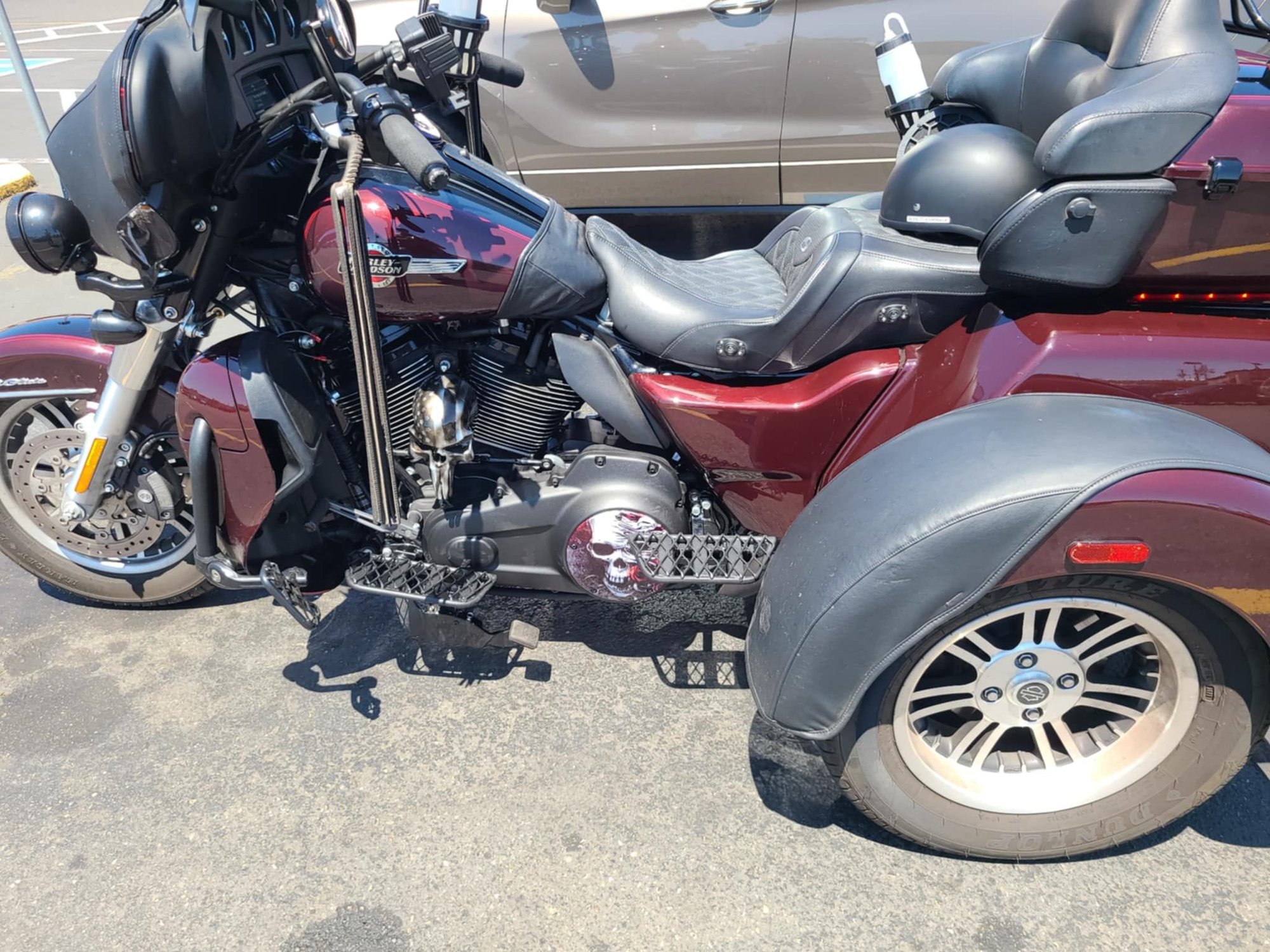

This is a photo from about a year ago. It's changed a lot since then....

Nice looking trike.
