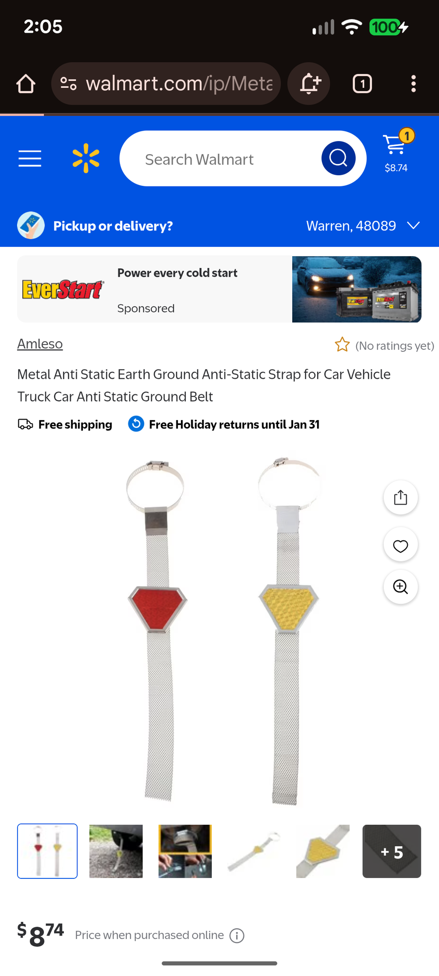

Something like this?
Each tire?
I really noticed the clicking and poping increase when I got new tires
Do I also need to better ground the engine to the frame with a wire as they are isolated with rubber?
Or the radio better grounded to the frame?
I remember seeing these on cars a long time ago - a strap draging the ground from the bumper (when bumpers were steel) or exhaust.
Haven't seen one one 40 years.
