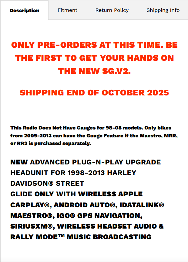

The Soundstread Reserve WHD.SG head unit add a lot of modern features such as Apple Car Play and Android Auto, but I don't think it has any provision for headsets. From what I can see they are coming out with a V2 that will add wireless headset functionality. Yes it is expensive but it will give all the functionality of the modern head units, which is pretty sweet when you think about it. Looking at the description though I don't know if it will allow phone calls to be handled or if it just passes audio to the headset.
Soundstream Reserve SG.V2 2009-2013 (FITS ALL BATWING FAIRINGS) PRE-ORDER
