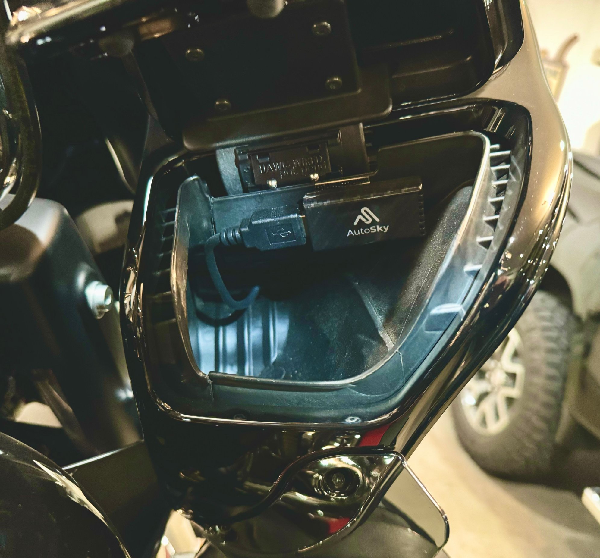

Now #2, Wireless CarPlay refers to not having to plug your iPhone into the bike's USB cable to get CarPlay to be available. This is independent of the above, and I wouldn't move on to this until I first had CarPlay working as intended. For this all you do is get one of the 100 different kinds of "Wireless CarPlay" modules that are available. Everyone has their pick, I use this one in my trucks and bikes
Amazon Amazon
It plugs into the bike's USB cable, instead of plugging the iPhone into the bike, the module makes the head unit think the iPhone is plugged in to it.... then the module communicates with the iPhone via Bluetooth/WIFI... and you can have your iPhone in your pocket, saddle bag, whatever.

There's a ton of them out there, but I've had good luck with that one, so I've stuck with it on other bikes, trucks, and cars...
I originally got it for its size, so on the bike I could put a velcro Scotch-Lock strip on the back of it and stick it up out of the way on my RGL.
It doesn't really take any space away from the little storage area...
