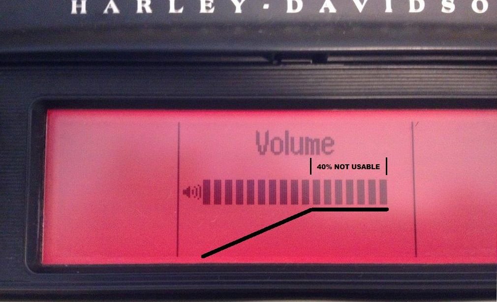

Originally Posted by TRIGGERMAN-SERG
40% unusable volume!
John,
Apparently, I'm not the only customer who's unhappy after they've purchased from you. I've spent well over a thousand dollars for a 500 watt 4channel DSP ROKKER sound system (including four 7.25" XX speakers) for my 2011 FLTRUSE. Since January I've been requesting a DSP software program to provide sufficient volume for high-speed interstate touring. To your credit, you have responded, but only with minimal volume improvements. You appear to have taken the stance that your customer should be satisfied with what YOU DECIDE is sufficient. This customer is NOT SATISFIED with a DSP program which limits him to only 60% of the available volume range! May I remind you that I'm not leasing this equipment .....you'll never see it again. Kindly provide me with a 100% solution and trust that I have the smarts to use my volume control wisely!
Dennis Toth

Originally Posted by JMJOHN
TRIGGERMAN-SERG ,,,,,,
well ,, at least now I know who you are and it is unfortunate that you decided that you needed to bash the J&M product here on HD forums, to the point of being obnoxious, just to see if you could get me to respond,,,,,,
over the past 1 1/2 years, there have been many times I have ignored your emails ((sometimes I just have to)) and other times when I have sincerely tried to explain the system to you and get the proper DSP program to you, for your specific system configuration ,,,, but to no avail ,,,,,,,
YOU are running the Harley saddlebag mounted iPod integration device, and that is one of the reasons you are not getting as much gain into the system, as you might with the CD/Aux input music source etc ,,,,,,
and the volume control tends to be less responsive above halfway ,,,, which tells me that you are also using the AVC control on the highway, and then wonder why the radio face says one thing, when the actual system volume is automatically at max ,,,,,,
then you kind of run off at the mouth about how much you know about Harley audio systems etc ,,,, accusing me personally of somehow trying to control you ,,,,,,
I "SHOULD" just continue to ignore you again, but instead I will send you another DSP download via email ,,,, and you can then let the world know how much louder your system is, compared to it's current state ,,,,,,
just remember ,,,,, ever louder audio system volume levels are a lot like a boost screw on a turbo-charger ,,, the more you turn it up, the better it feels ! ,,,, till you blow a hole right thru a piston ,,,,,,,,,,,,,,,,,,,,
