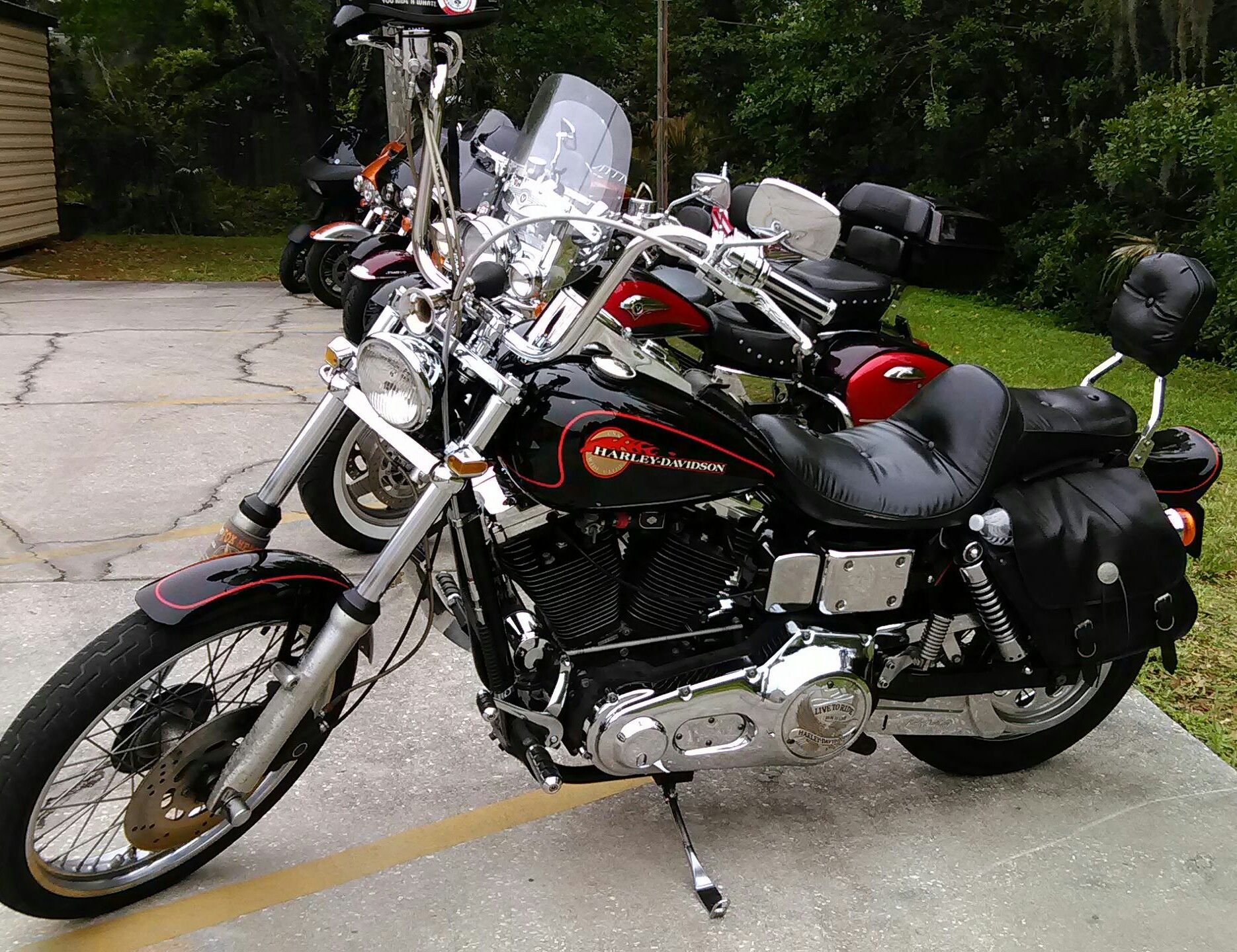

Default 96 Dyna needs TLCI have a 96 Dyna Wide Glide that needs quite a bit of TLC. Pulled fouled plugs that was gapped at .28, 29
replaced & pulled air filter & cleaned. Owner played with air & idle mix & now cannot run or start without full choke.
Any ideas on how to completely reset to see if it needs rebuilt? hard to pull choke and adjust either adjustments solo.
Any help would be appreciated & anyone close that could advise would this help the novice mechanic trying to help.
Thanks in advance, Forrest
