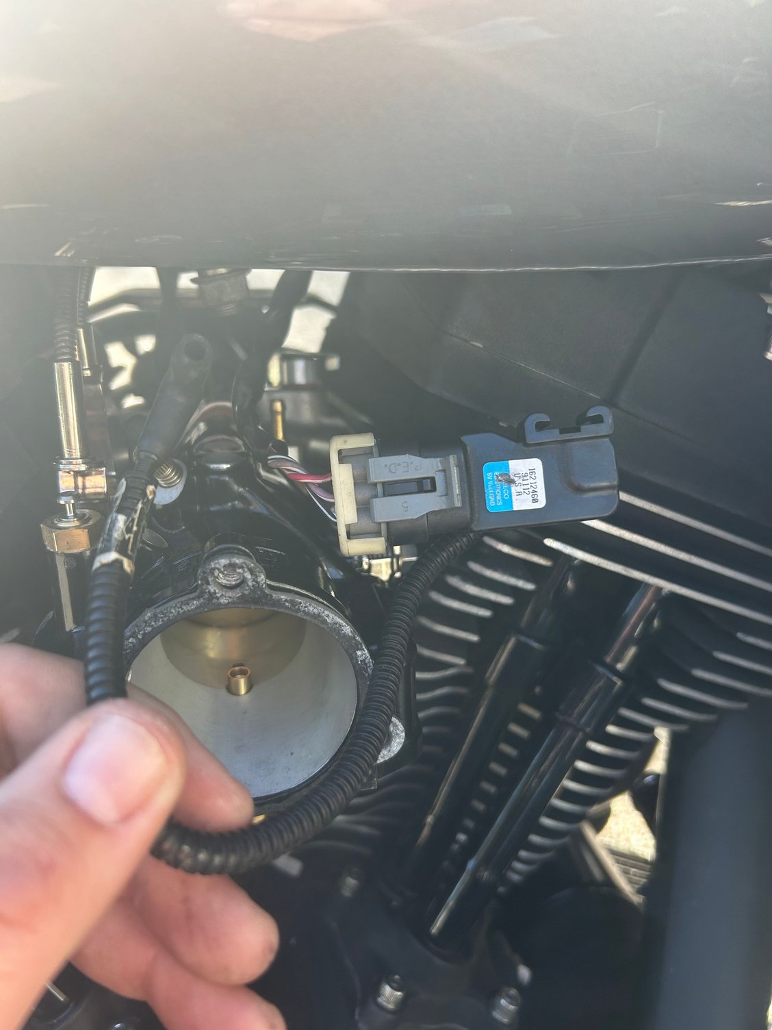

ok so I don’t have voes I have whatever this is

That is a Mass Airflow Sensor, a modern VOES. In the photo, I see a brass hose barb sticking up. Start the engine up. Now stick a fingertip on that brass tube. Is it trying to suck yer fingertip in????

It’s not a mass airflow sensor. More likely a MAP (manifold absolute pressure) sensor.
Check for intake leaks!
