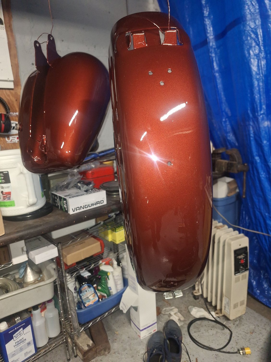

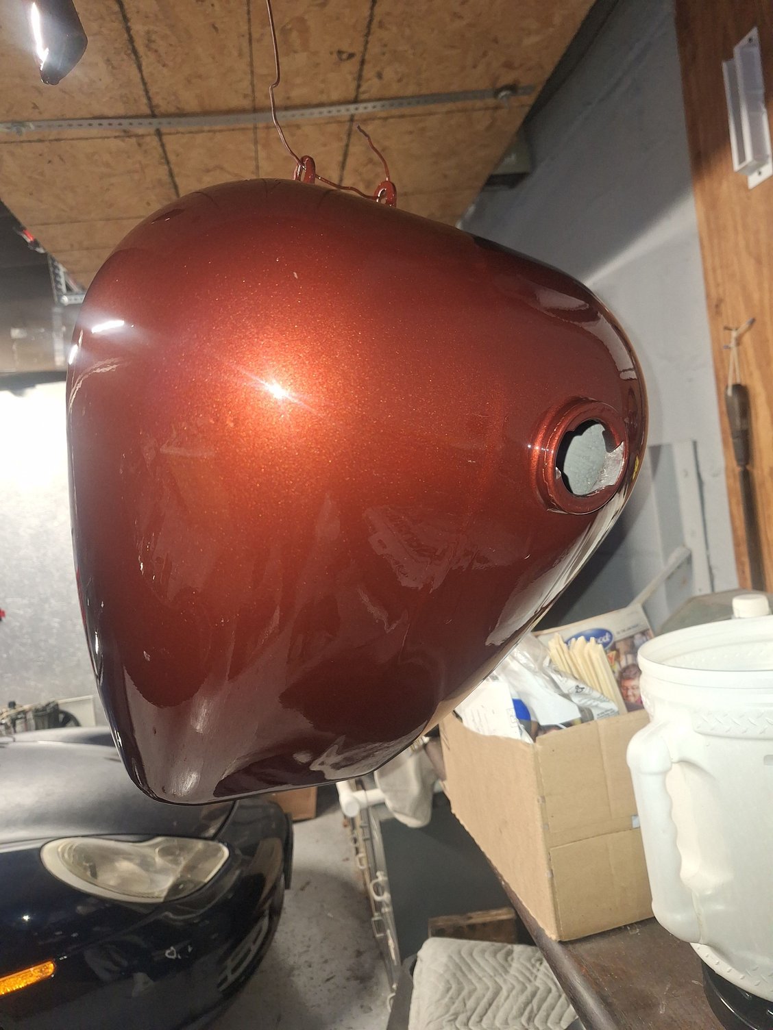

Thanks all, Will do all the above. Just got done painting. LMKWYT...if thats really an acronym.
