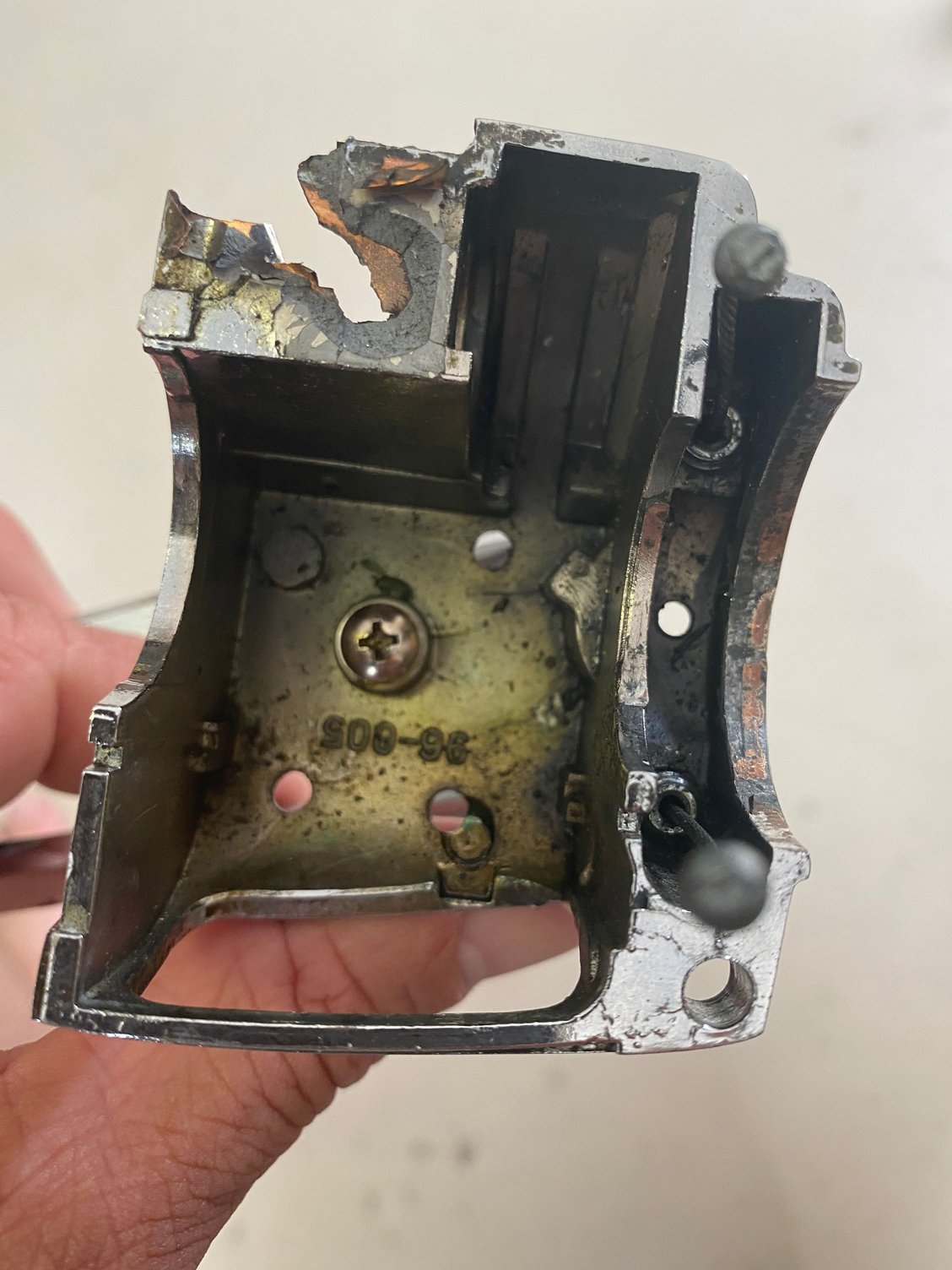

Default Switch Housing
2005 Cycleworks scooter. I am trying to replace the switch housings. I am now on my second set. The bike has cable throttle control with switch openings that are very rounded versus square. The first set I purchased was part number 3800447 which is for a pre 96 model bike. The openings in the housings for the switches were very square and the right lower did not have holes for the throttle cables. The second set I purchased was part number 5000260 which is for a 2005 lowrider. Fit the bike well, the switch openings are more rounded which is what was on the bike however the openings for the throttle cables are not threaded. Just did the live chat thing with JP and they are now recommending 5000242 right lower housing however by the picture it is back to the square opening. This is also for a pre96 model which I don't believe is correct as the bike was built-in 2004-2005 timeframe unless they were using 9 year old parts which is possible. Does anyone know if any harleys around 2005 had lower switch housing threaded for throttle cables? I guess the other options I have is to either thread the housing I currently have (2nd set, 5000260) or change out the throttle cables. Can't wait to get this bike running and out of my garage.

Well round 3 is a bust. This time I ordered 3800447 housings and 380-405 switches from JPC and they are incorrect. The right side housings will not fit with the brake lever. Below are pictures of old and new. I need help! The throttle cables are threaded so that should mean at pre-96 model. Does anyone know what I might need to order?
Old upper housing
old lower housing you can see where the mounting screw broke
old housing
old housing
