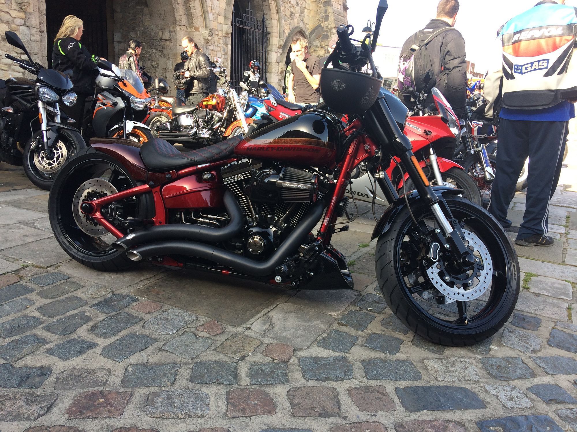

I too am in the UK and pulled the trigger on a Shotgun Shock for my Breakout three years ago. I have not seen another bike in the UK with a Shotgun Shock. What sold it for me was the fact all the other offerings out there Legend, Arnotts and Thunderbike's own offering only offered a two year warranty outside the USA whilst Shotgun still offered a lifetime one. The feedback and forum comments of those that had Shotgun Shocks fitted were also very encouraging. I have had no issues with mine and it really is a great bit of kit once you find your 'sweet spot.'
I accompanied mine with a Thunderbike rear fender which came with a replacement bump stop and stainless steel shims to adjust the lowest setting to prevent the fender from impinging on the rear tyre. This adjustment was crucial to prevent damage to the fender. Admittedly I got it wrong and the fender had to go back to be repainted due to heat damage whilst running the setup at it's lowest setting. This was not a Shotgun issue but of my own making not taking into account tyre flex on bumpy roads when shimming for the lowest setting.
Real estate in my tiny garage is at a premium and I had to do the work outside on my drive, you need plenty of room. I picked a bright sunny day and set to work. The instructions that came with it were very clear and concise. I have mild OCD and took my time, I am also an electrical engineer so spent perhaps more time than was necessary ensuring the looms and frame where it was routed were well protected and routed perfectly. It took most of the day and I needed my partners help to steady the bike on a couple of occasions as access was limited with the stand/table I used and I had to lower it twice to gain access to where I needed to be. A decent torque wrench and some blue Loctite and extra cable ties will come in handy too. Good luck you won't regret it!

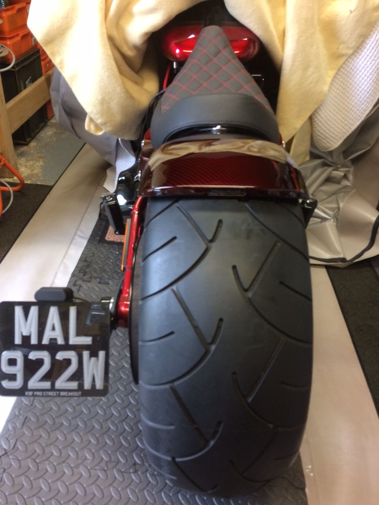

As mentioned I accompanied the Shotgun Shock with a Thunderbike rear fender so the fender, belt guards etc. were all off and away for paint anyway. It can be unnerving removing the standard shocks, I had the bike lifted on the table and the wheels chocked. On my Softail 95% of the work needed was from below, removing two individual shocks and having to fit the Shotgun double unit in lieu, the compressor was also from underneath only. Despite doing it on a bright sunny day an LED floodlight also helped underneath. You are in no rush the more you remove the less likely you are to inadvertently damage anything. You do need to get under both sides of the bike for fitting and removing the guards would help IMHO.
I will send you a 'pm' message about the excellent service I received from Shotgun.
View from underneath during final phase of fitting and yes it's a tight squeeze!

As an afterthought. As you are aware I complimented my Shotgun Shock fitting with a 260 Thunderbike rear fender which was supplied with a replacement thinner bump stop and shims to lower or raise it and adjust accordingly to exactly where I wanted it and to prevent the fender from impinging on the tyre!
I am unsure of this but for the outlay of less than Ł5 it may be worth it perhaps? The shims for mine were stainless steel plates with slots in them so all one had to do was loosen the nuts on the bump stop and slide in or remove shims without the need for bump stop removal.
Even with the Shotgun Shock fitted your lowering position will be limited perhaps by the bump stop and you may wish to go lower still? Or you may need to shim it the other way.
Rather than mess about with your existing bump stop the part number for one is 11514 and costs a mere Ł4:93.
You could get one in for when you are ready to fit the Shotgun Shock and if need be either shave a little off it or use it as a pattern to have some shims made if you need them?
The bump stop securing nuts are accessible behind the battery tray.
