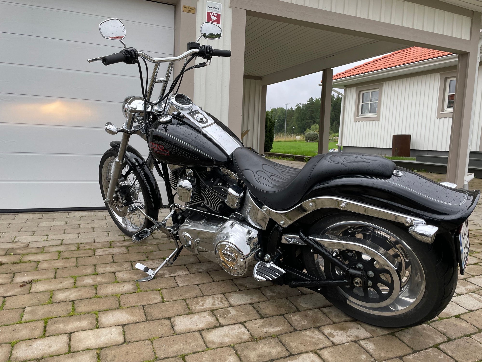

2008 softail low milage start to taking it apart , and selling all the parts a dont need . 23” fatspoke and airride is the plan , long winter is coming .

Hallo thanks my bad , its a softail custom model name .. but , bolt on seat ? The seat is cut in 4 pieces stretched and wided .. bracket is cut an shorted and moved rear to fit the new fender welded and are now in a leathershop to get new leather .
Front fork legs are shorted 3 ” and 1” more with progressive suspension to fit /look god with the 23” front . inew brake rotors black ..rear wheel hub machined to fit my softail and also the belt pullley ..
Triple tree and fork parts cerakoted .
Rear fender roland sands cut to fit , ecm relocated .. battery cover crossbones cut to fit .
risers machined to fit the handlebar and cerakoted black and cromed topclamp..
tank consol change to softail slim .
numberplate holder made weld and cut to fit ..
next work is to put legend airsuspension .
Exhaust pipe cut and fix with new cromed endcap and cercoted heatshields.
Gastank and fender is going to paint chop gloss black .
Just to tell a lot work man .

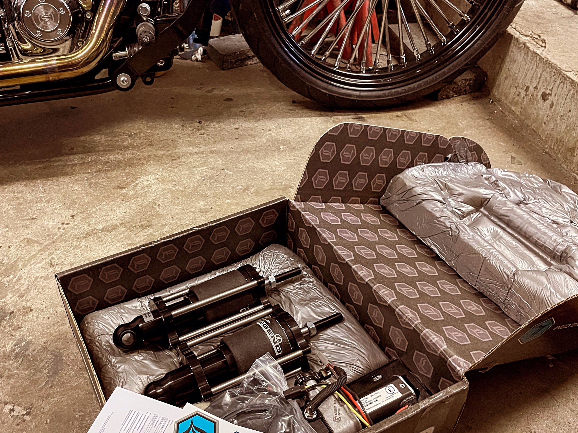

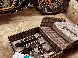

Default Legend airride
Airride from legend air ..

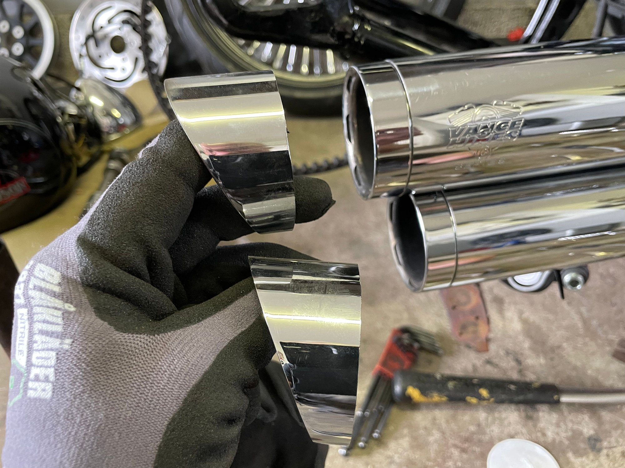

Cut and weld pipes fixing lines

Default Fitting the pipes and seat is back
