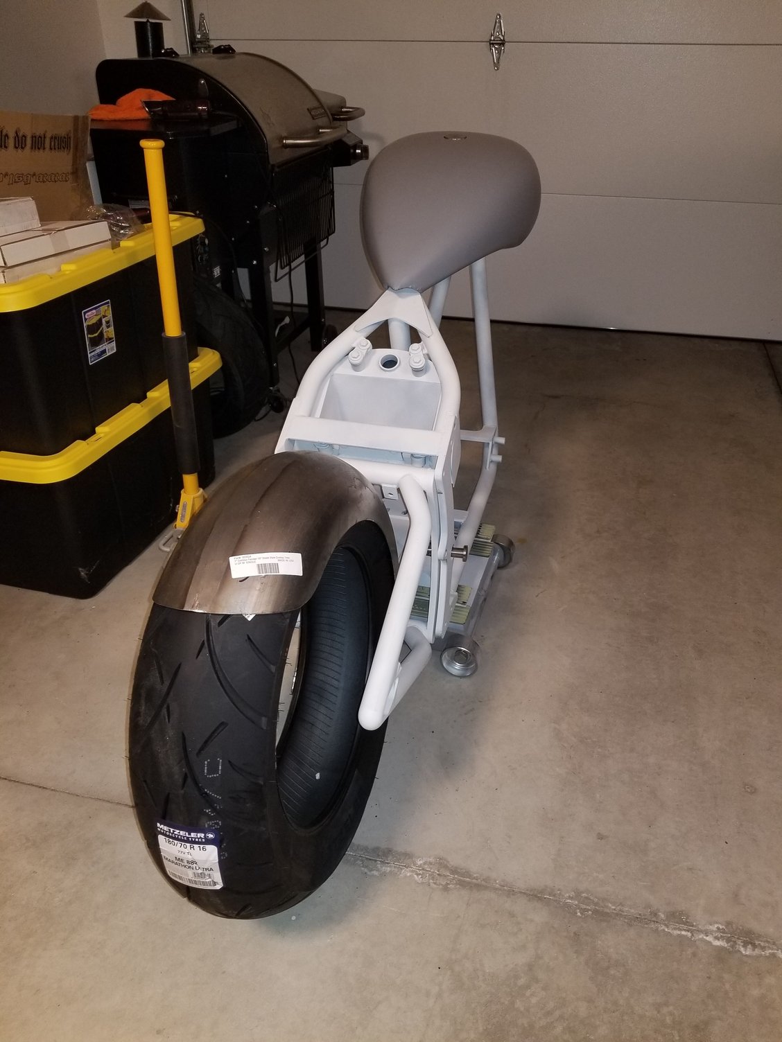

Have been accumulating parts for like six years to make a custom bike that has a bobber look. Last piece is Tech Cycles Cyclone primary with mid controls that I'm waiting on. Hopefully it's done early next year. So I figured I'd start the build. Raced AFM and WSMC for about ten years in CA and wrenched my GSXRs and SVs then, but never owned a Harley. Not claiming this will be a Harley at all, though, given the build is all aftermarket parts. I've already encountered a few builders glitches on making things work, as expected. For me, that's part of the fun and I'll have the knowledge of everything on the bike. Like to ride too but am way too old to race anymore so a large v-twin should be good for me. Wish I could weld and had a mill and lathe but I make do.
Plan is to assemble the bike and do the wiring harness then take to a good builder to weld tabs and such, do metal work on the tank and rear fender, dyno tune motor, check my work. Then title and plate (in Colorado), run in the bike and make sure everything works and adjust anything that needs adjusting/corrected. Then then strip it down to powdercoat the frame and paint the bodywork.
It's a project and I'm in no hurry. I will have questions and lots of times with this stuff there is no clear answer in the stock 84-99 manuals, aftermarket instructions are thin, and sometimes might need help from people who have maybe encountered the unknown unknown issues and challenges that I'll likely face along the way, so posting a thread here. Appreciate the read...
Major Components (have almost 100% of the little stuff as well other than maybe a few fasteners and odds and ends like hydraulic lines, fuel line... that I'll deal with as the build requires):
  • Rolling Thunder softail frame, 1.5", stock rake, 180mm rear
  • Rebuffini Redemption springer stock length
  • Progressive 422's with RAP
  • Ride Wright 30-Daddy 16" wheels, front 3.5", rear 5.5" cush drive with Alloy Art cush/sprocket (chain final)
  • S&S V111 crate, Super E
  • Cycle Electric stator, Drag Specialties HD rotor, Dynatec Twin Fire II coil
  • Rick's universal MOSFET reg/rectifier and Antigravity 16-cell battery
  • Tech Cycles Tornado 2kw starter
  • Baker OD6 hydraulic
  • Tech Cycles Cyclone 2" belt primary and clutch, with their mids made to fit that primary
  • BSL Fat Tommy exhaust and BSL Bomb V2 Tattoo exhaust; The Fat Tommy pipes might interfere with mids so I bought the Bomb which I know will not
  • Lyndall composite front rotors (bought in 2019 before they stopped making them)
  • Wilwood GP310 front calipers on Twisted Choppers caliper brackets
  • Lyndall steel rear rotor
  • Wilwood Dynapro rear caliper on Twisted Chopper rear bracket
  • Rebuffini Vendenge handlebar controls with Muller internal throttle control
  • Motogadget parts like mo.unit Blue, m-button, all stuff for crafting the wiring harness which I can figure out
  • Sprit Leather seat with Two-Bros air bladder kit
  • Lights, bars, this and that...
First question: I see rear calipers mounted inside the swingarm tubes (stock), under the bottom tube, and even above the top tube. What would any of you recommend for a custom?
