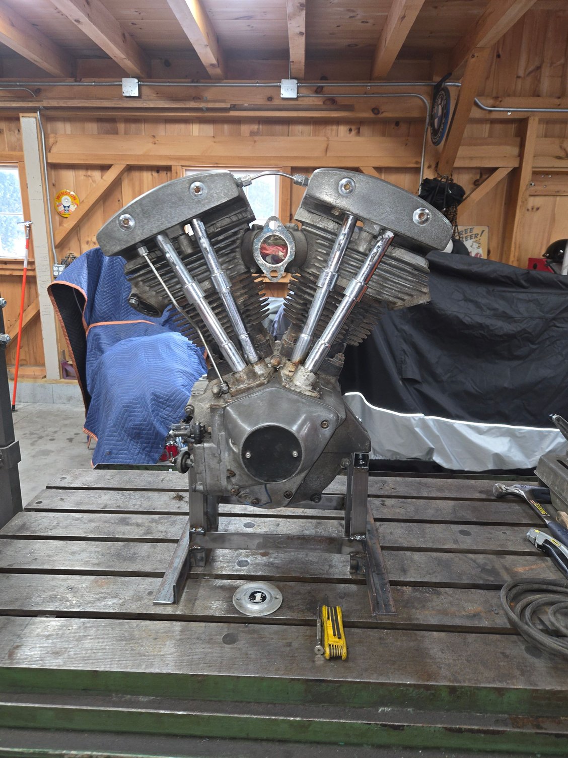

Question for the seasoned guys:
I'm told the 80CI shovels (late 70s) have 9 fins on the jugs.
The number on my case says it is a 1979 74CI motor from a Superglide.
Is it possible to exchange jugs (and pistons) from an 80CI motor to a 74CI lower end?
Or is the 9 fin thing not true?
I have no history at all on this motor....

close up of motor. Please pardon my ugly weld on the home made stand
Research indicates it can be done but 80`s have thicker base flanges and require longer studs, also lowers compression.
Not a bad thing for a kick only chopper.
But what is your goal?
Your existing cylinders may be fine.?
Or they could be bored
If they are beyond help, new replacements are cheap

Good stuff -88. Thanks for sharing that research.
My question was poorly worded. I have no intention of doing anything like that. I was just trying to figure out what I'm working with.
The jugs on this motor have 9 fins. The number stamped on the case indicates it is a 74" motor from a 1979 Superglide
Does the 9 fins indicate an 80" motor / barrel? or is that a campfire story? I feel like I should trust the VIN decoder and assume the motor has not been molested....
Once I get it apart I can measure things to verify.
Does the 9 fins indicate an 80" motor / barrel? or is that a campfire story? I feel like I should trust the VIN decoder and assume the motor has not been molested.....
Research "seems" to indicate that 9 vs 10 was true in 78 when the 80" came out
Then by `79 both 74`s & 80`s had 9 fins
I admit IDK
Note that the aftermarket 74" ( post #24) cylinders appear to have 9 fins
I`ll be counting fins on my E78 this pm

Well that clarifys things a bit. Thank you.
I am confident I have an unmolested motor that can be treated like a stock motor for parts, tolerances, adjustments, etc.
I'll be using a S&S Super E carb I had laying around.
FWIW
9 fins / thick bases / long studs / triangle washers
