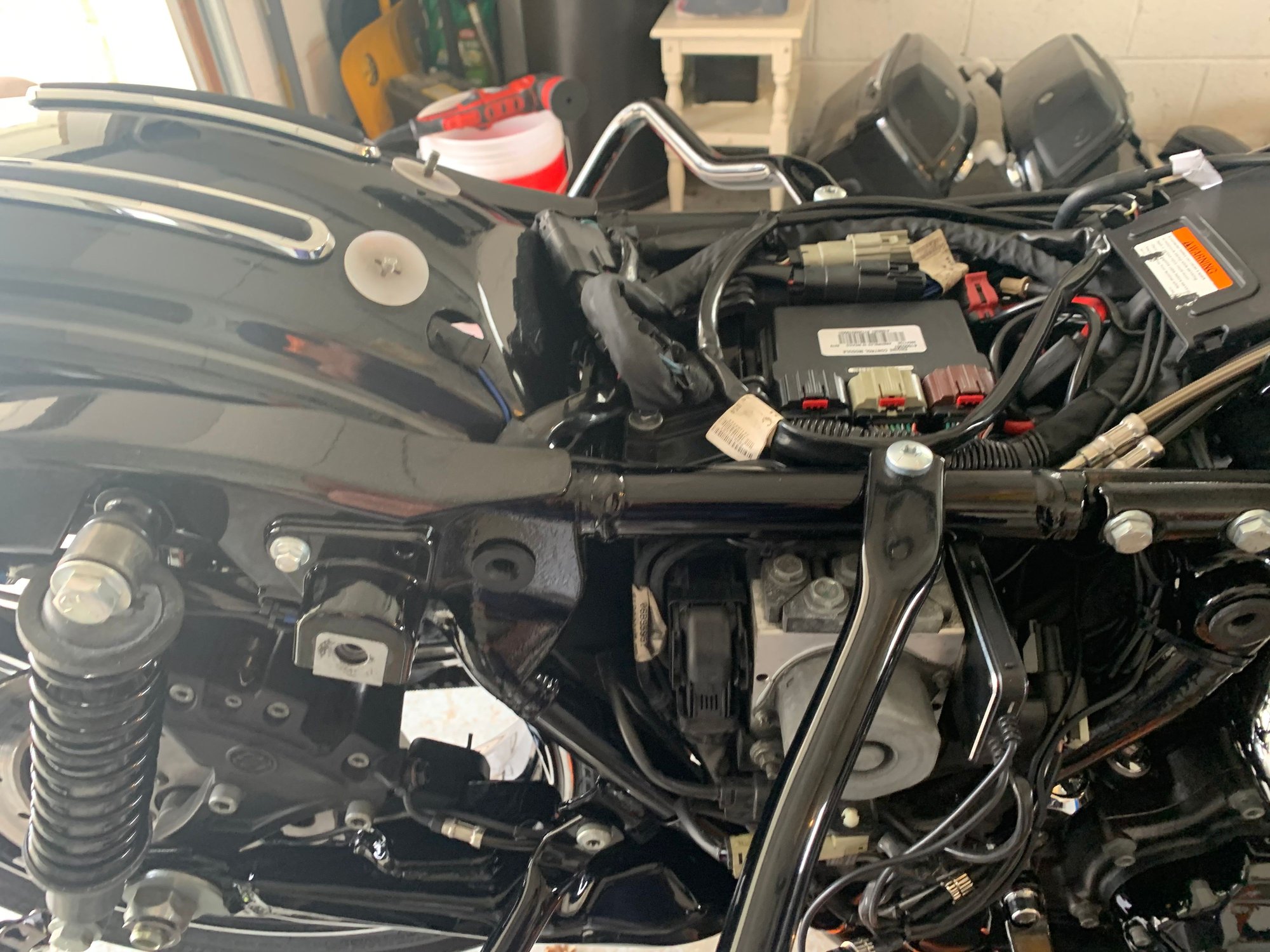

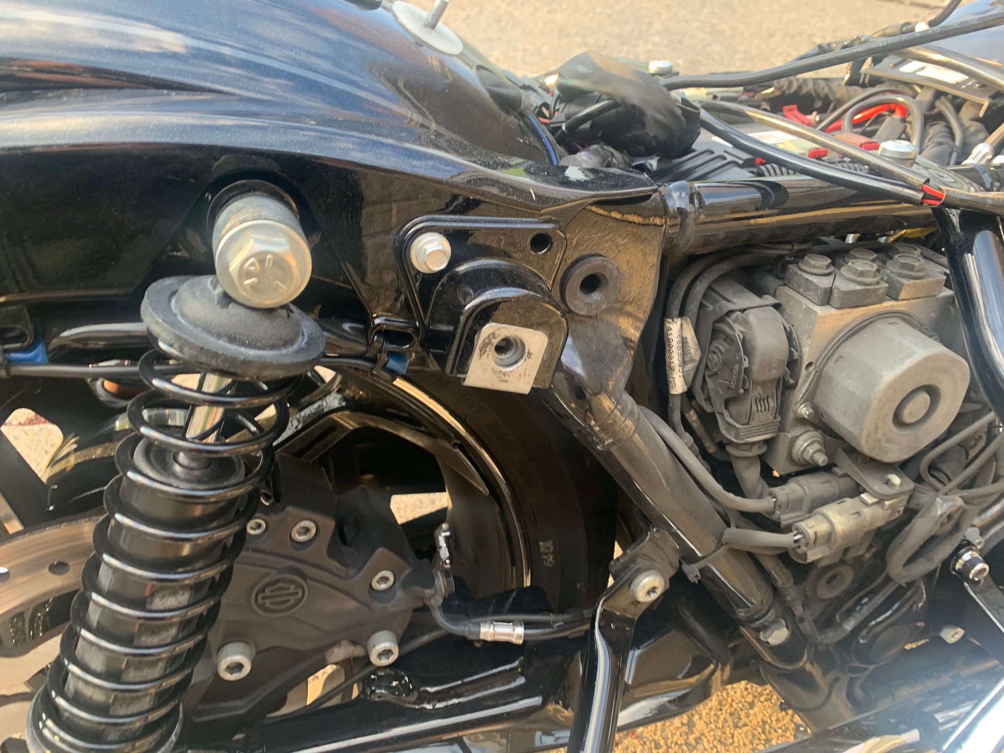

i use a dry microfiber to start, gently wipe as much as you can and then blow it out afterward (compressor, canned air, lean in and go "phooooooo")
then I use a damp mf towel, no soap and such, very dry, no water dripping, wrung out very hard
next, come the cotton detailing swabs, i dip the swabs in a prep solution....only need a tiny bit, leaves the surfaces super clean
keep poking, prodding, wiping, and swiping until the tips start coming back clean
last time i took the time to properly clean it, i wiped each individual wire....seems like a pain in the ***, because it is...... also, grab a tube of dielectric, if you disconnect a wiring harness, apply before reconnecting
hers is a before and after, did some wire cleanup as well

Where is the "after" pic?
Edit: Oh wow! What a huge difference! Nicely done!
Alright then...I guess I will start spraying Probably will just get some soapy water in a sprayer and use a little brush to get in tight places and then gently hose it off...

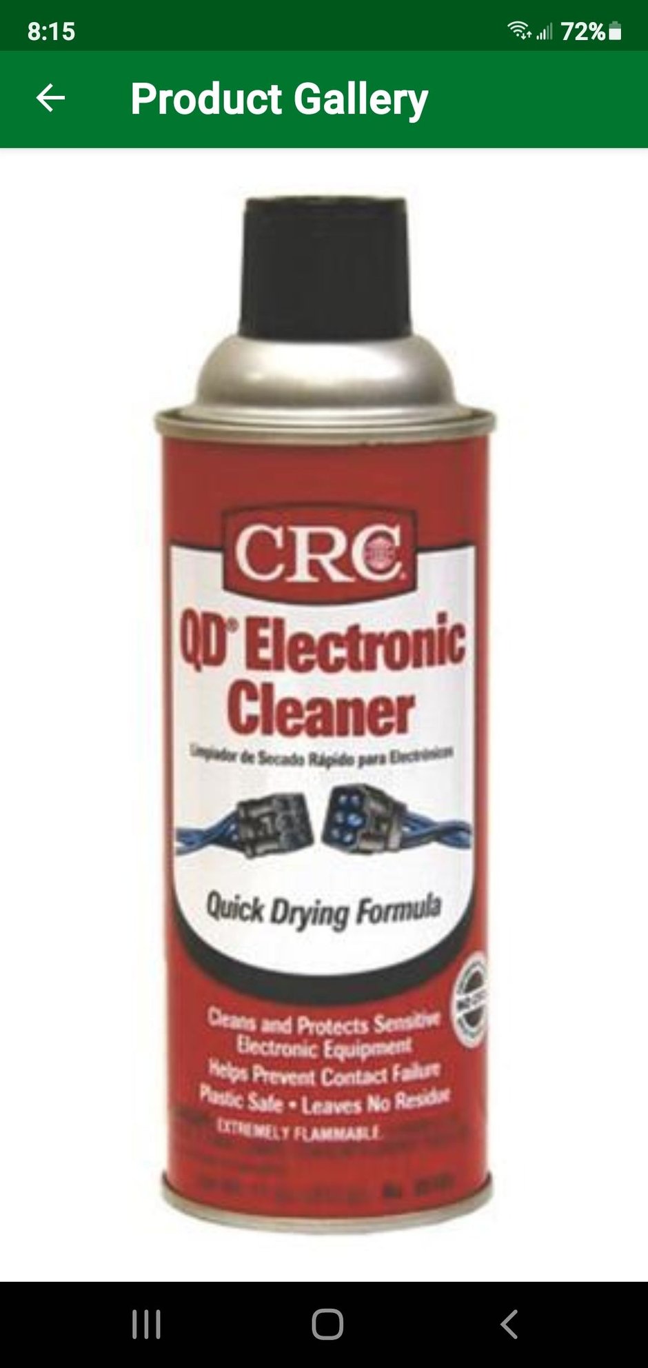

Late to the thread I know but I use this electrics cleaner you can pick up from Menards. I use this **** on everything. It's under pressure so it squirts out strong and practically cleans everything without having to touch or dry anything. Safe for all electrical components and connections
