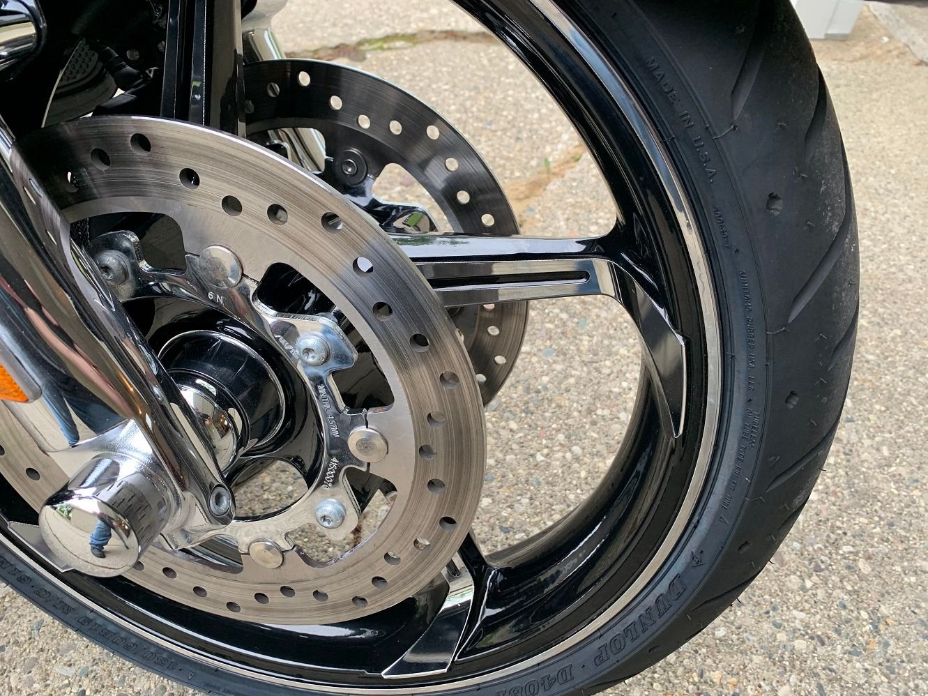

I picked up some Sonax Wheel Cleaner plus for my 19 FLHXS. It say's that it’s not recommended for motorcycle wheels, so I tested a small area before doing an entire wheel, and I couldn’t find any damage caused by it. This is the result of me just spraying the stuff on, letting it sit for about 3 minutes, and hosing it off:
Gonna try to do a full wash this weekend, if I do I’ll post any additional results because like I said , this was just a quick test of the Sonax, but so far I don’t see any reason why it’s not safe for these wheels. I might also try to contact the manufacturer.

Looks really good. Thanks for sharing!
