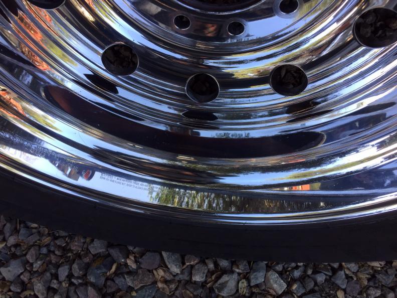

Use a buffing wheel and rouge bars. Mounted on either a paint buffer or 6000 rpm grinder. They will come out looking like chrome and stay that way for awhile. Using mothers is not the same. It makes it shinier but not polished. Using the buffer and rouge wheels melts the aluminum and it lasts much longer. I make my living polishing aluminum. I wouldn't use mothers for anything. It's crap. You can see Pics of my work on Instagram @precisionfleet. I would use a muslin wheel and either green or white rouge. Basic supplies can be had at harbor freight. It's not what I use but it is cheap and available. professional supplies can be bought from Highwayshine.com. Hope this helps

Properly done the wheels would look stunning. Here is a before and after pic of a wheel we did yesterday. Only takes thirty minutes or so. Maybe an hour if you just started polishing.

After
