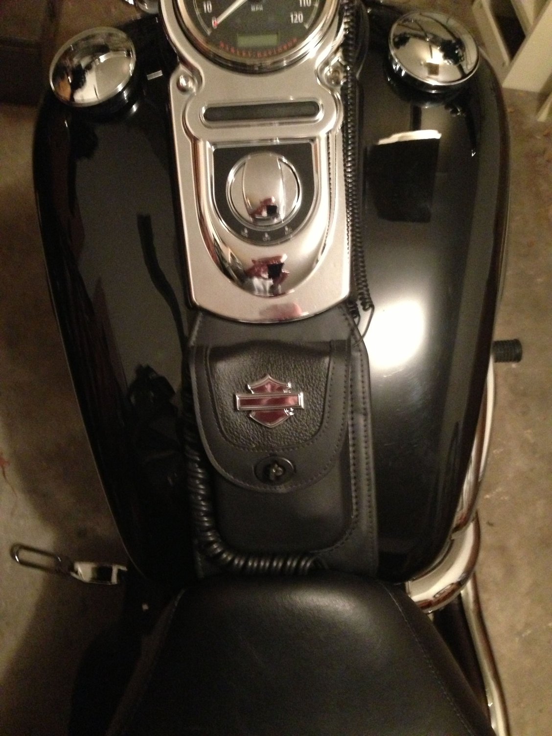

Linewatch, here are a few photos of my set up.
The first shows the tank pouch containing the CB installed on the bike. The large coiled wire running down the left side of the pouch provides connection to the auxiliary jack and antenna connection under the seat. The smaller coiled wire coming from the top right corner of the pouch leads to the Bluetooth radio adapter mounted on the handlebar.

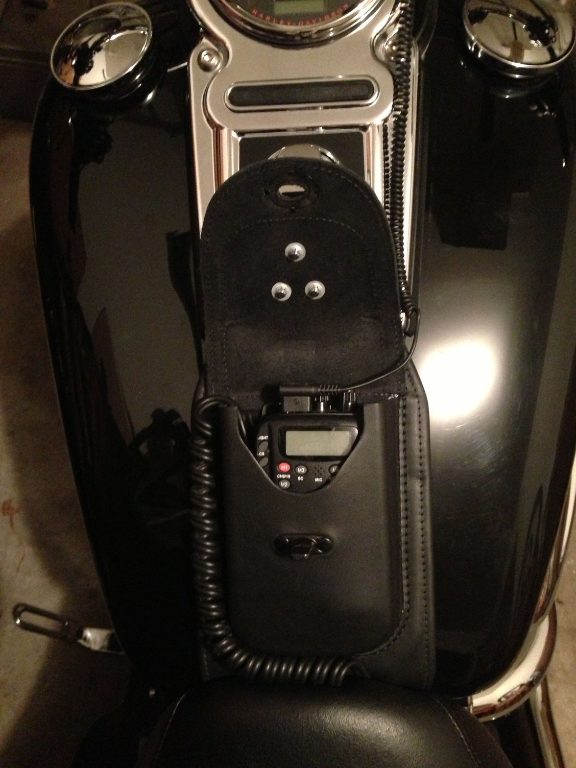

Second photo with the pouch flap open shows the CB tucked into the pouch.
One of the things I like about the Midland unit is that the on/off/volume **** and squelch **** are both on the top of the unit, so they are easily accessible without having to remove the unit from the pouch. Since the group I ride with always stays on the same channel, I really have no need to access the other buttons.
