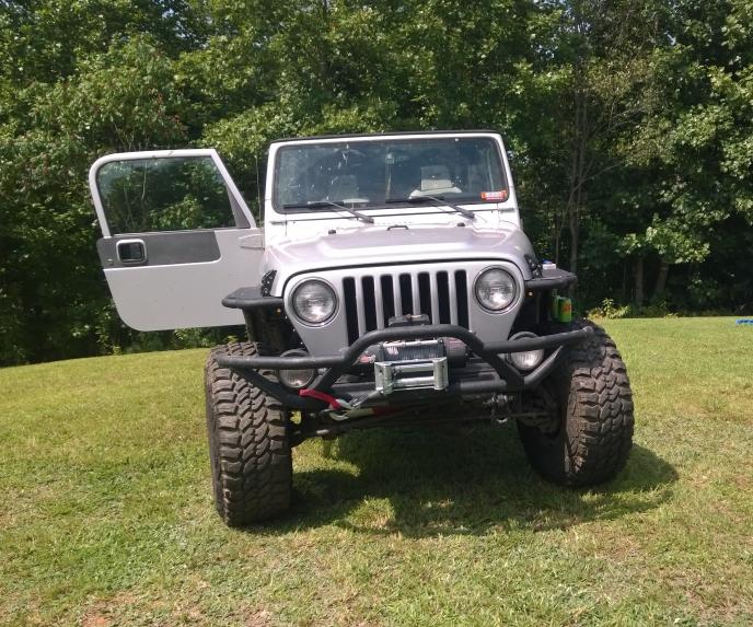

That is an awesome pipe. Really liking this idea. I like to mess around and figure stuff like this out, hence the Jeep haha.
