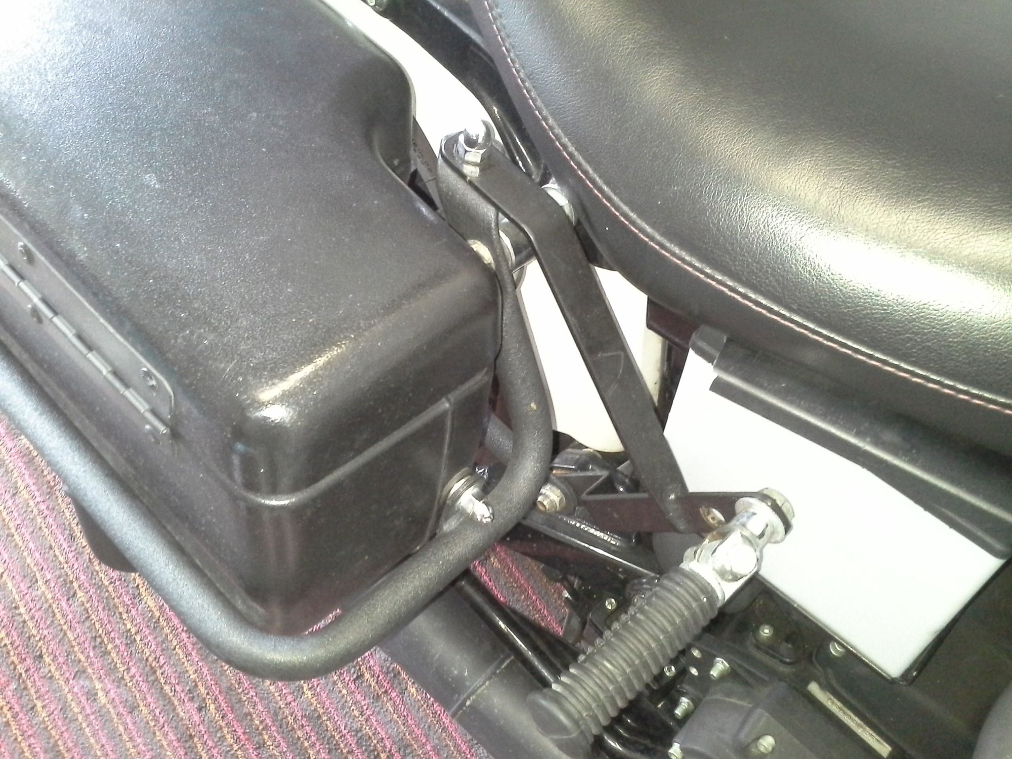

Default Dyna Defender passenger foot pegs.
Paul's Cycle Repair in Canoga Park, Ca. And I designed these. Paul fabricated them.

Your bags are fine. I ran into this same problem with my FXDWG.. Get a set of 4" extensions made by Kuryakyn- #7937. These will get her feet far enough out in front, the bags won't be in her way and also make it more comfortable for her to stretch out some. Also get a good seat like the Harley Sundownder along with a sissy bar W/pad and with a quick release mount. Set your shocks to as stiff as they will go and your ready for the long haul with your wife. REMEMBER, a HAPPY wife sure make your life better and a lot easier to get what you want for your bike also. Have fun 2 up
