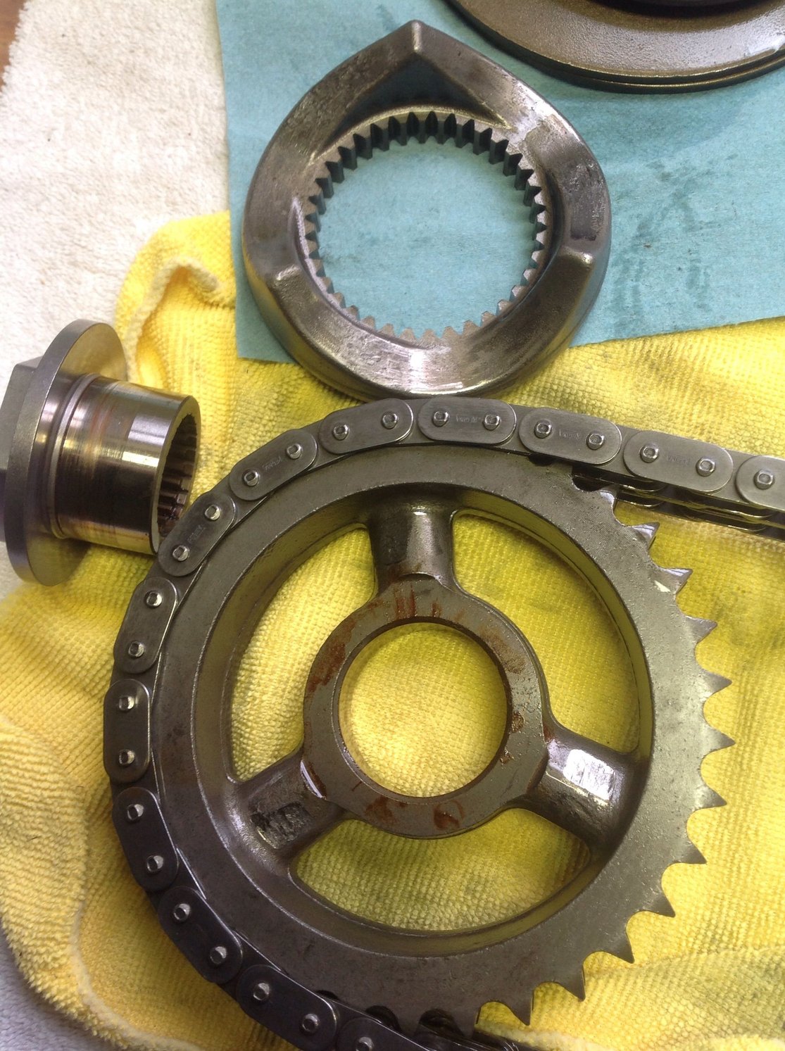

I ran the same for about 9 months, did not like what my compensator parts were looking like:
You can see the missing metal where the spokes of the compensating sprocket engage the sliding cam. The sliding cam is showing wear and the sproket retainer is getting scratches where it fits inside the compensating sprocket. I had cleaned the 3 pieces up before the pic but they had that red rusty burnt up residue all around the inside of the compensating sprocket and the same scratched up areas of the sprocket retainer.

Lot of bigger differences here except for the Harley wet clutch looking the same. However, the automatic transmission has a high pressure pump with filtered oil. It does not have that large heavy side loaded roller bearing like the inner primary bearing. The AT clutches are actuated by springs and hydraulic pressure releases them. The crude cast finish ramps and highly loaded compensator bearing. I have seen it recommended by certain clutch makers but it leaves me thinking all they are concerned is their after market clutch and not the overall whole primary..strange. The years that Harley had the compensator like HDpilot's look like that with any oil. The case hardening on the sprocket rams was way too shallow due to production cuts by the mothership..The ramps in my older style are the same angle and show no fretting are were thru hardening even after 40K. However, the bearing of the shaft extension and compensator sprocket shows wear and galling.
