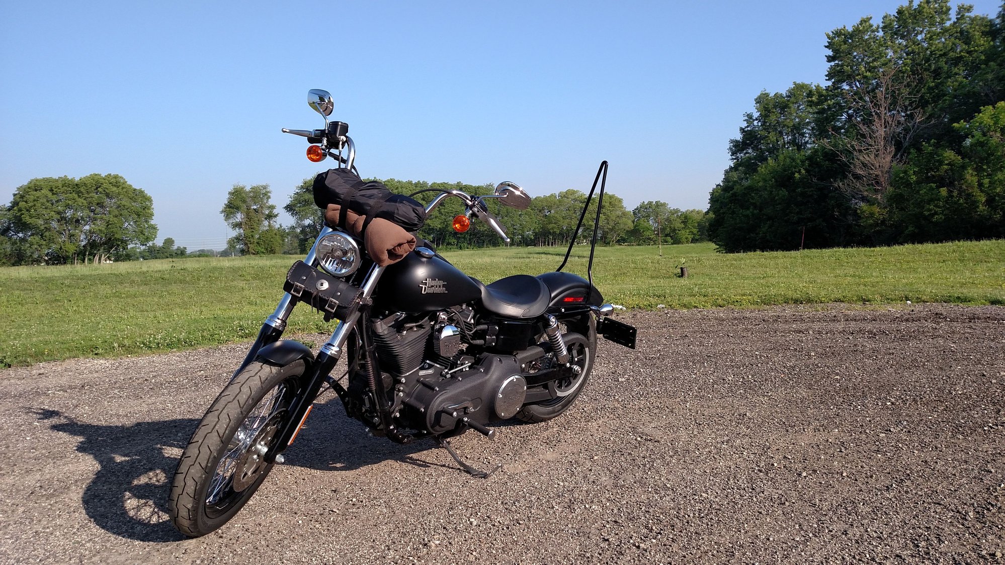

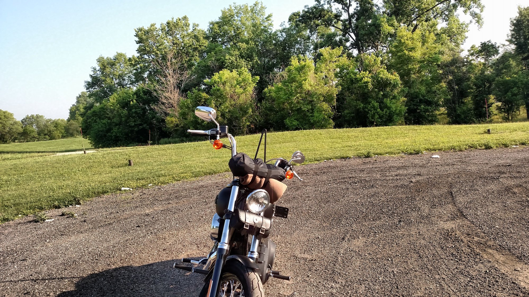

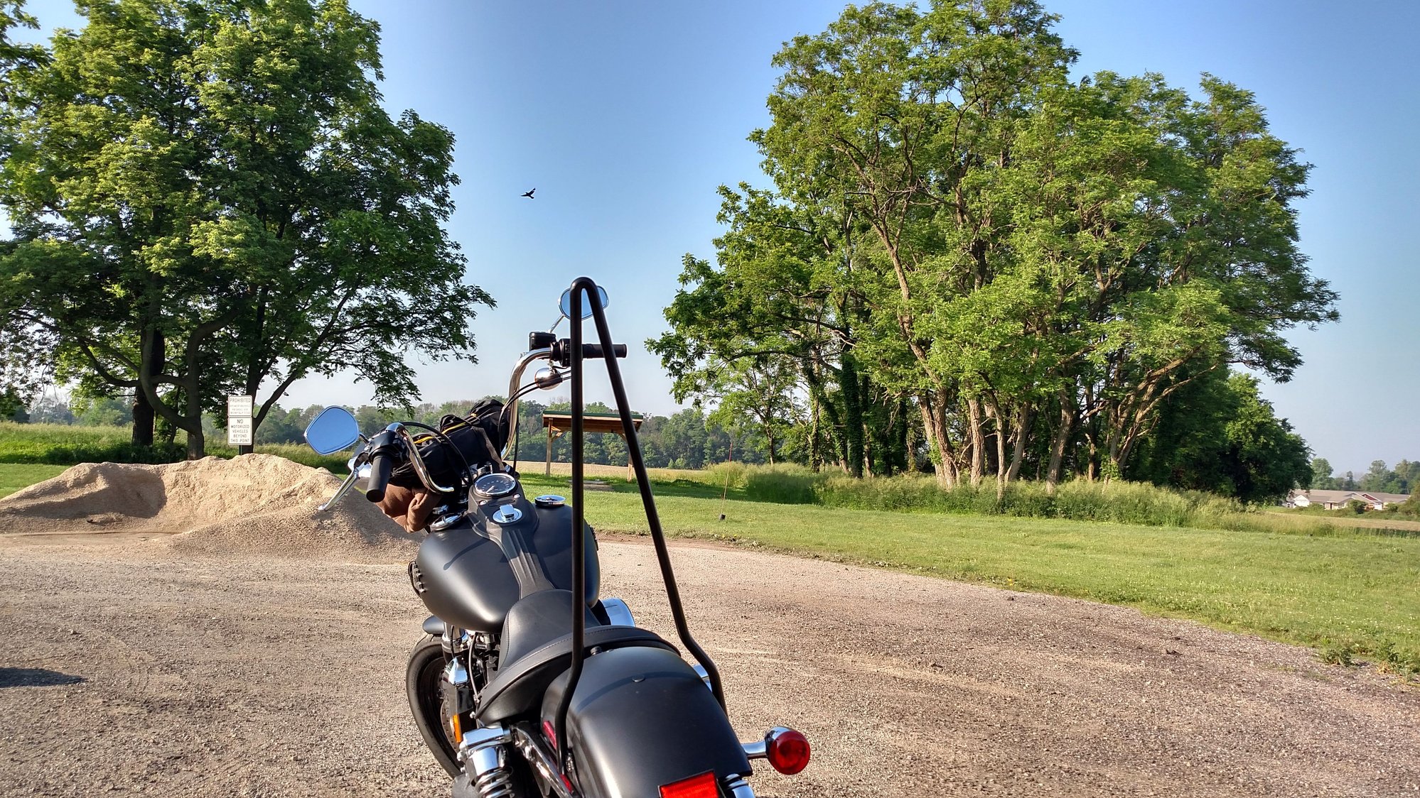

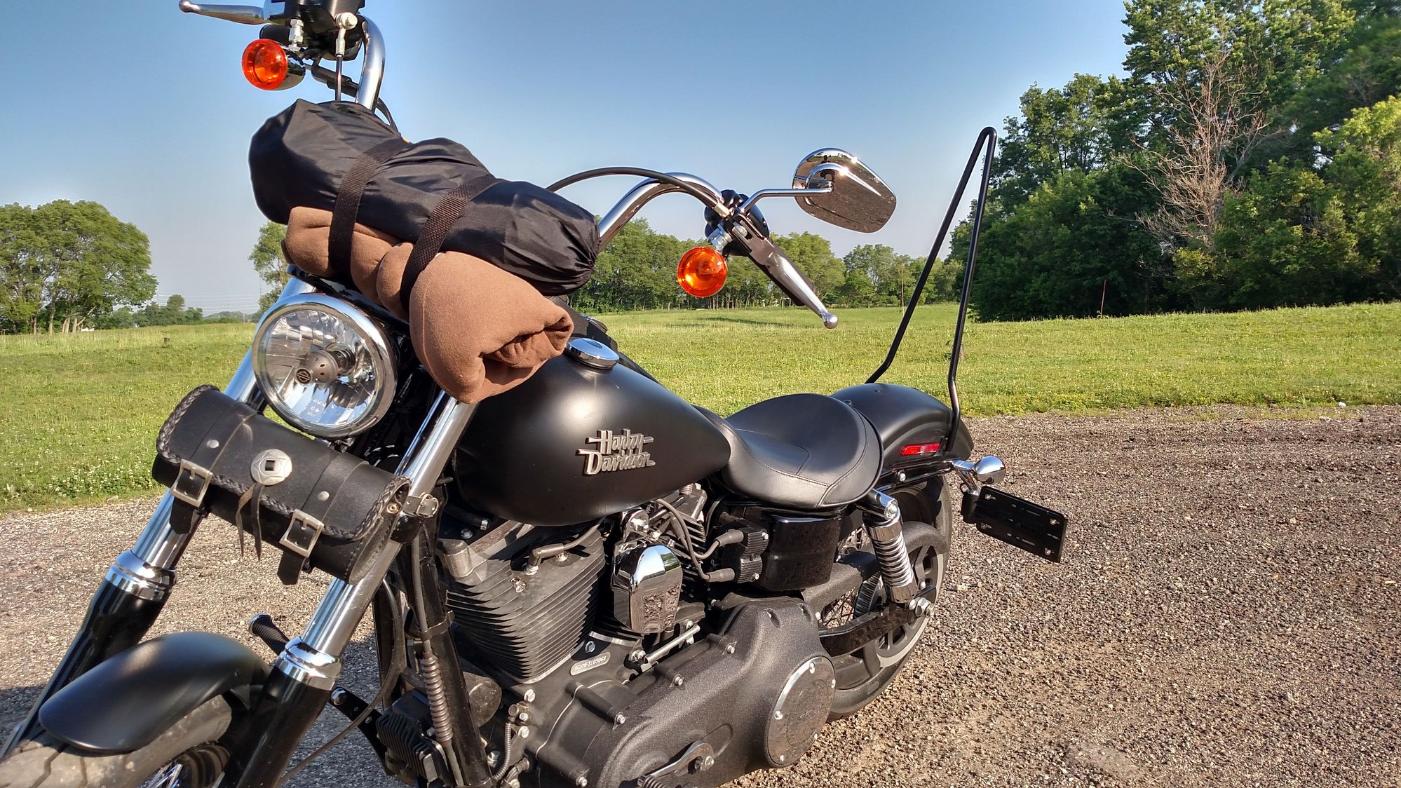

Default EL Hefe Pics and Review
EL HEFE Pics and Review
So after I received a private message from a fellow forum member about some flaws in his EL Hefe I decided to take a closer look at my bar. The message indicated his bar had marks from clamps and the bends in his bar were not symmetrical. My bar does in fact have small marks from clamps and some "popcorning" near the welds. The bar looks symmetrical to me. If its not, it is not noticeable to the naked eye. As far as the marks go they're not noticeable unless you take a close look. Also, the finish on the bar isn't extremely glossy. It still has a gloss to it but its kind of between satin and gloss if you will.
Installation was pretty straight forward. I did have to grind the mounting holes in the side plates about 1/16's to get it to fit. I need to pass this info onto slim. I would recommend covering your fender to protect it. Someone suggested masking tape. I put light scratches into my fender during install. Again not terribly noticeable but its worth taking an extra minute to protect your paint. I also took a small jack under the frame to lift the suspension for more room between the fender and rear tire to allow more space to work. Both wheels stayed on the ground.
I'm happy with this bar. I've never had any of the other competitors but you can't beat the El Hefe price. Its a solid bar. If I could make my own I would, but this was a great solution and product for me. Mine is the 27 inch bar.
