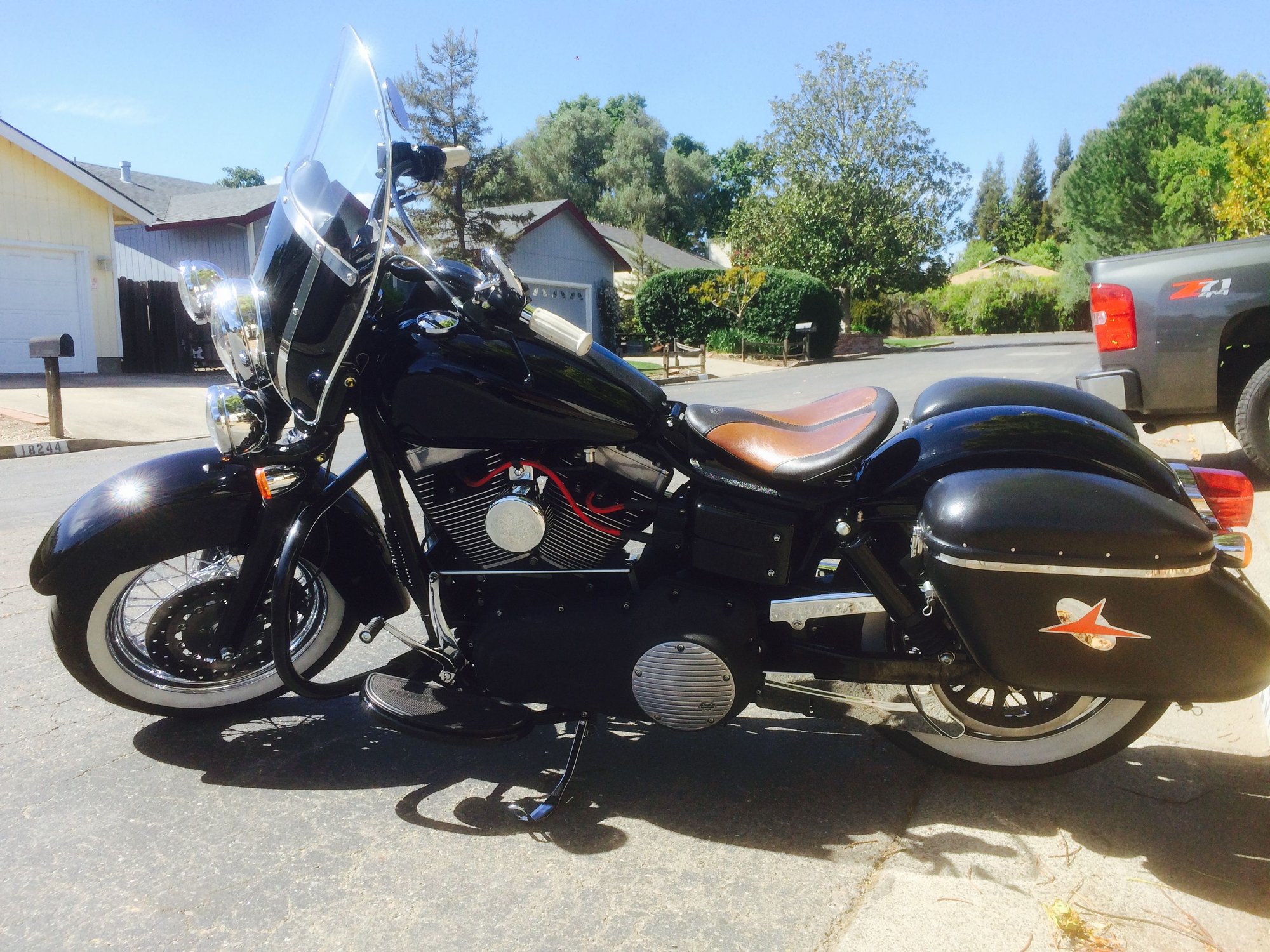

Knowing what I know now if they had the switchback in '07 I'd of bought it. Changed the bags, seat , wheels and some other things. Blue angel above gave you the link you need. Here's mine so far. Next to come--Chrome Dash, polished aluminum primary cover, cam cover and transmission cover. FLS front end or switchback front end? Questionable.
EDIT: I think '97-98 choices would be low rider, FXD or wide glide -I'd choose FXD. Just MY opinion.
