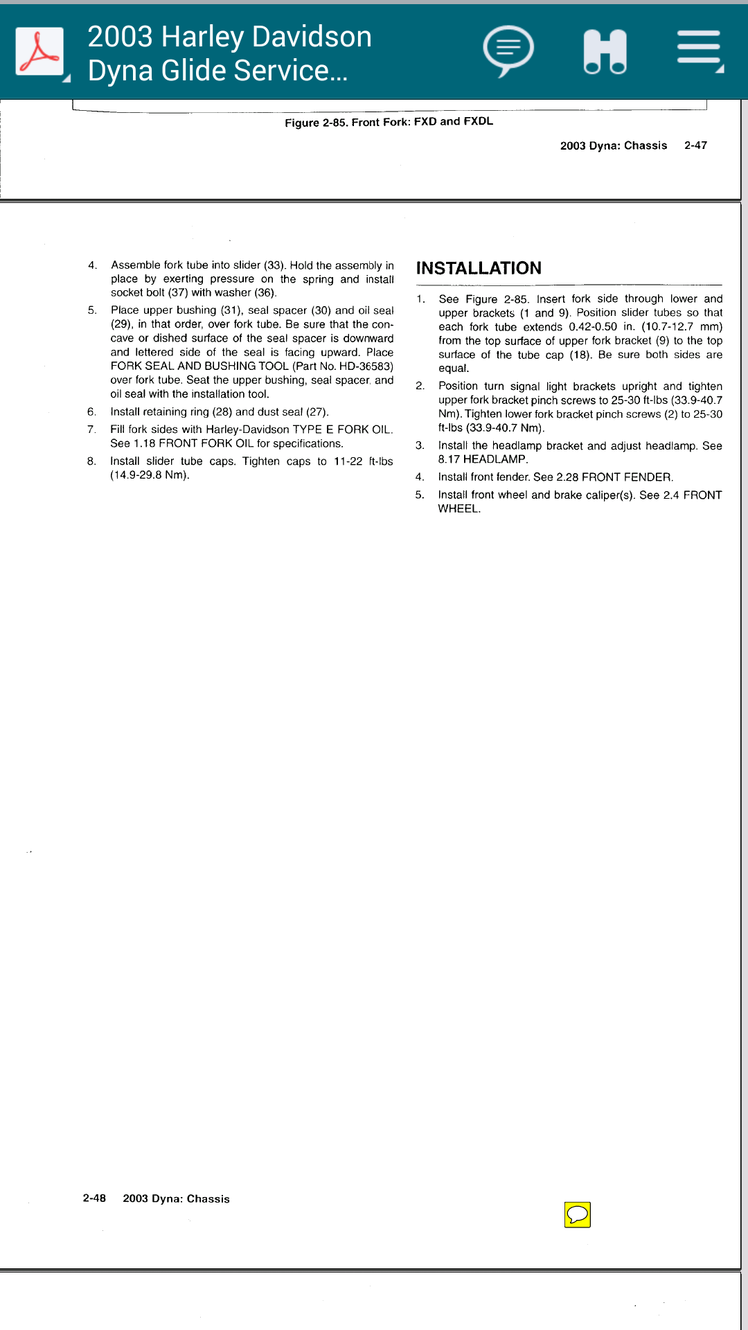

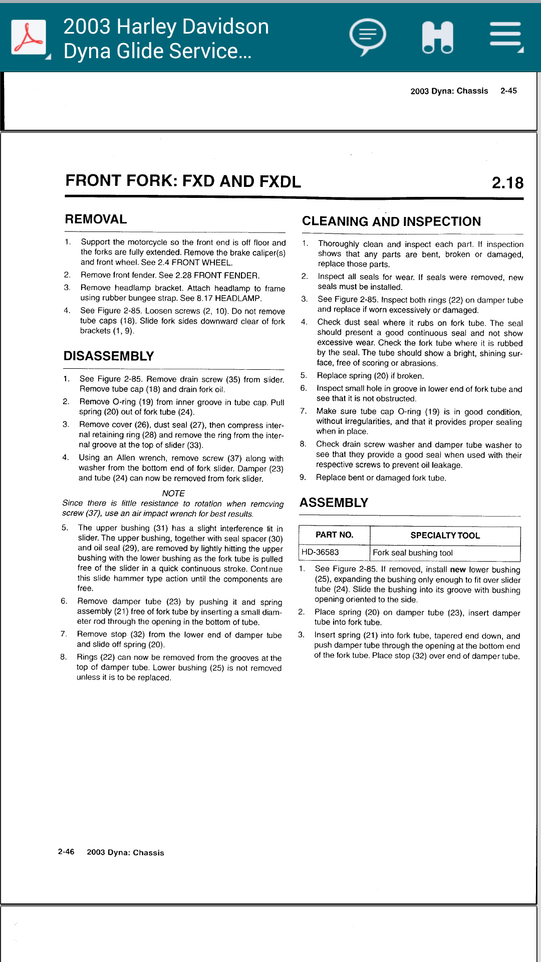

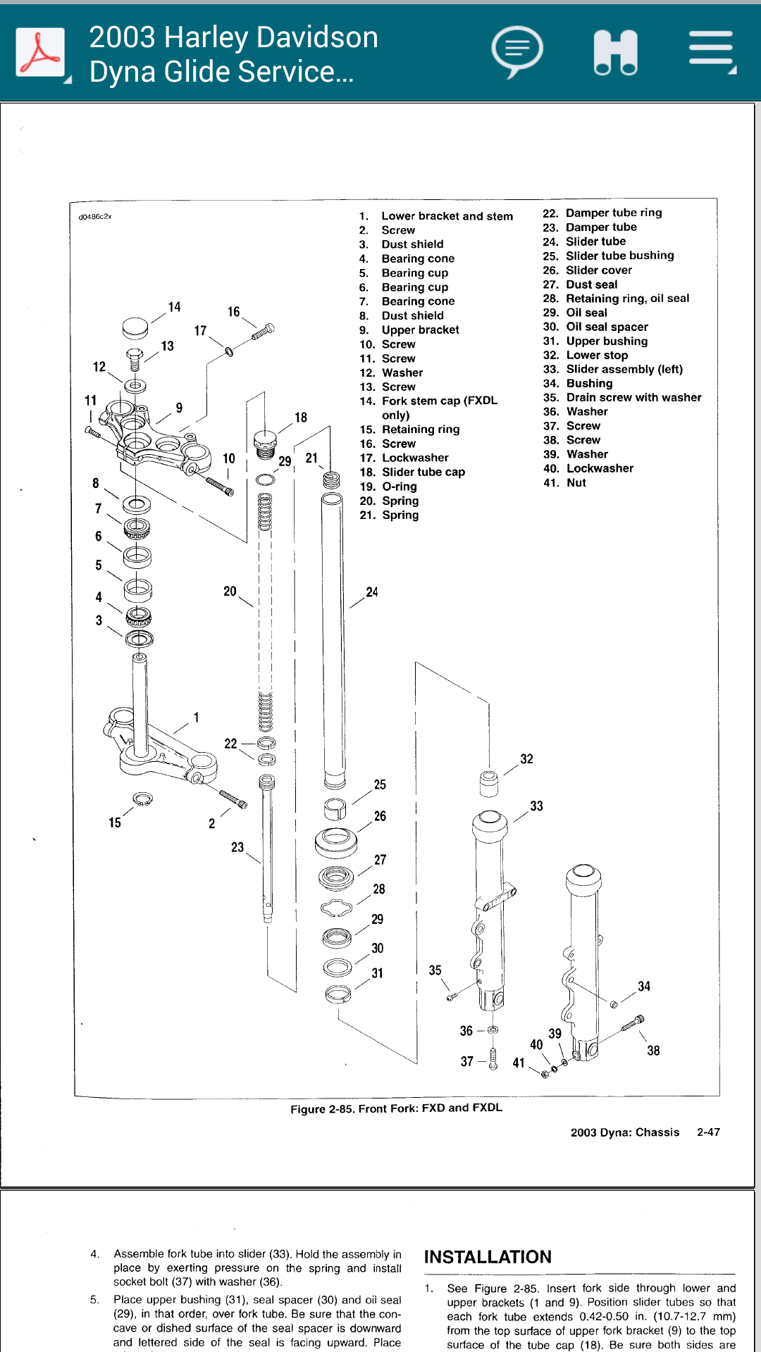

Can u guys give me some advice on how to disassemle for porwder coating and reinstalling the forks ? Here are the manuel instructions. I just need a little more help. Says nothing about sag and any tips or tricks u guys can give would be appreciated.
