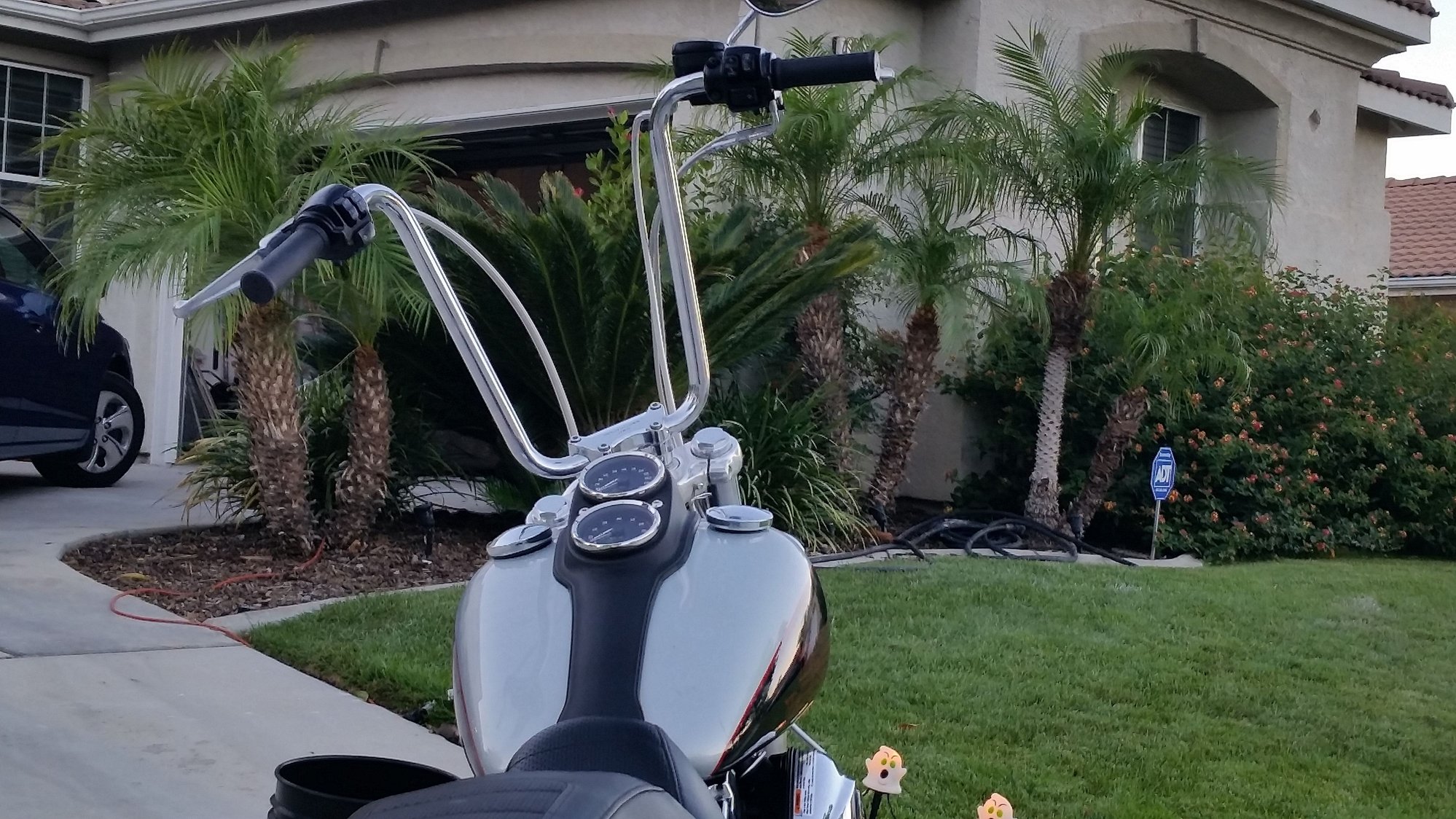

Dusting this old post off with a fresh post....
16in ZBars 1.25 in w/dimples, from RYCA Motors Whittier,CA. on my 15 FXDB.
Pros:
tighter, more narrow grip. Better control. Split lanes easier. Kick *** look.
Cons:
Took me way to damn long to put em on. Wiring was a real MFr. Could come a slight degree inward for the wrists sake.
Used a Burly 16 in extension kit. Had to swap clutch, throttle and idle only. Stock wire harness was long enough (barely), but since I couldn't get one GD CAN HIGH pin out from tang, had to cut and solder on new connector pin from kit for that one wire. Kept stock brake line. Took me a bit of time to install since it was my first rodeo and my wife was good with the interruptions all weekend.
Compared to stock mini's....no comparison. Whole different ride with much better control. Grips sit at shoulder height with mid controls on a 6ft rider. Arms don't feel tired or numb after an hour ride thru LA. Cornering is tighter and easier. Should be available thru website, Rycamotors.com. Let me know if you have questions. Thrash on!
