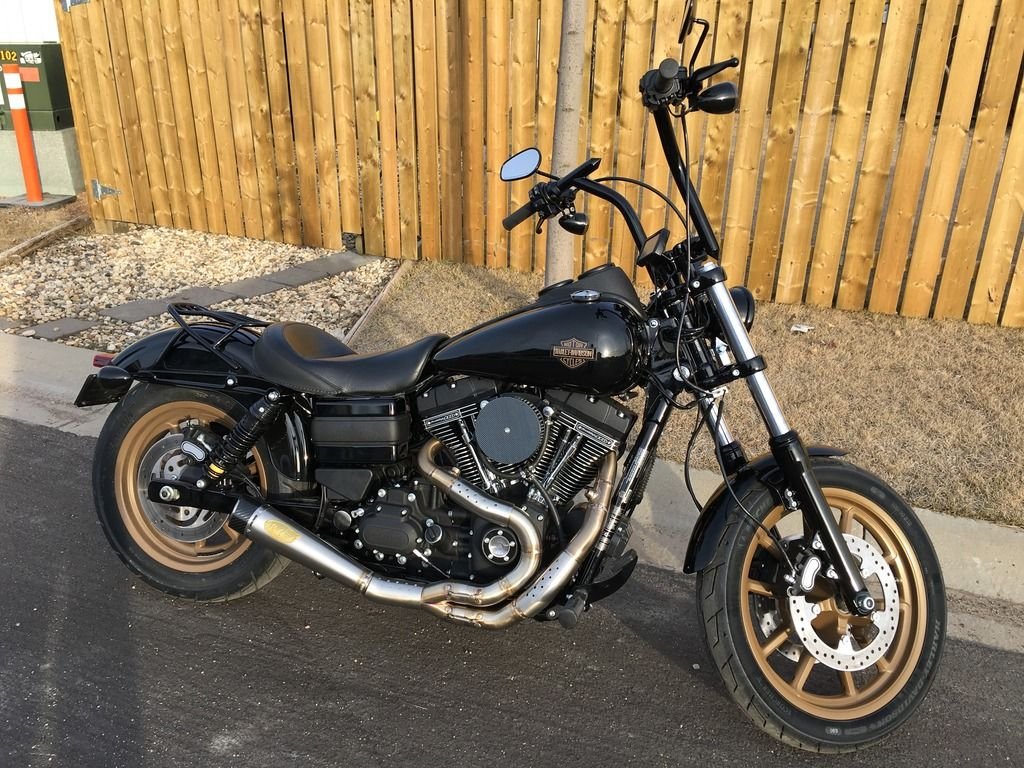

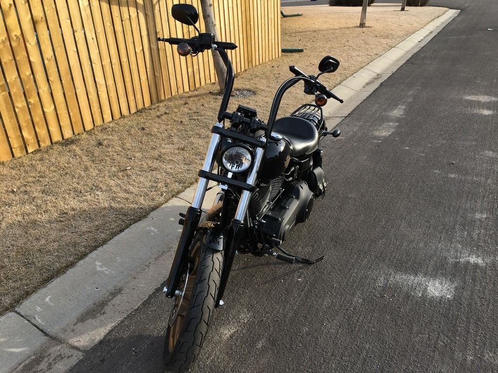

Default FMB Hellbent Narrow Monkey Bars
These are 14" FMB Hellbent Narrow Monkey Bars
http://www.fmbchopperparts.com/produ...dlebars-p-2729

Wicked... One unique set of bars there. tp

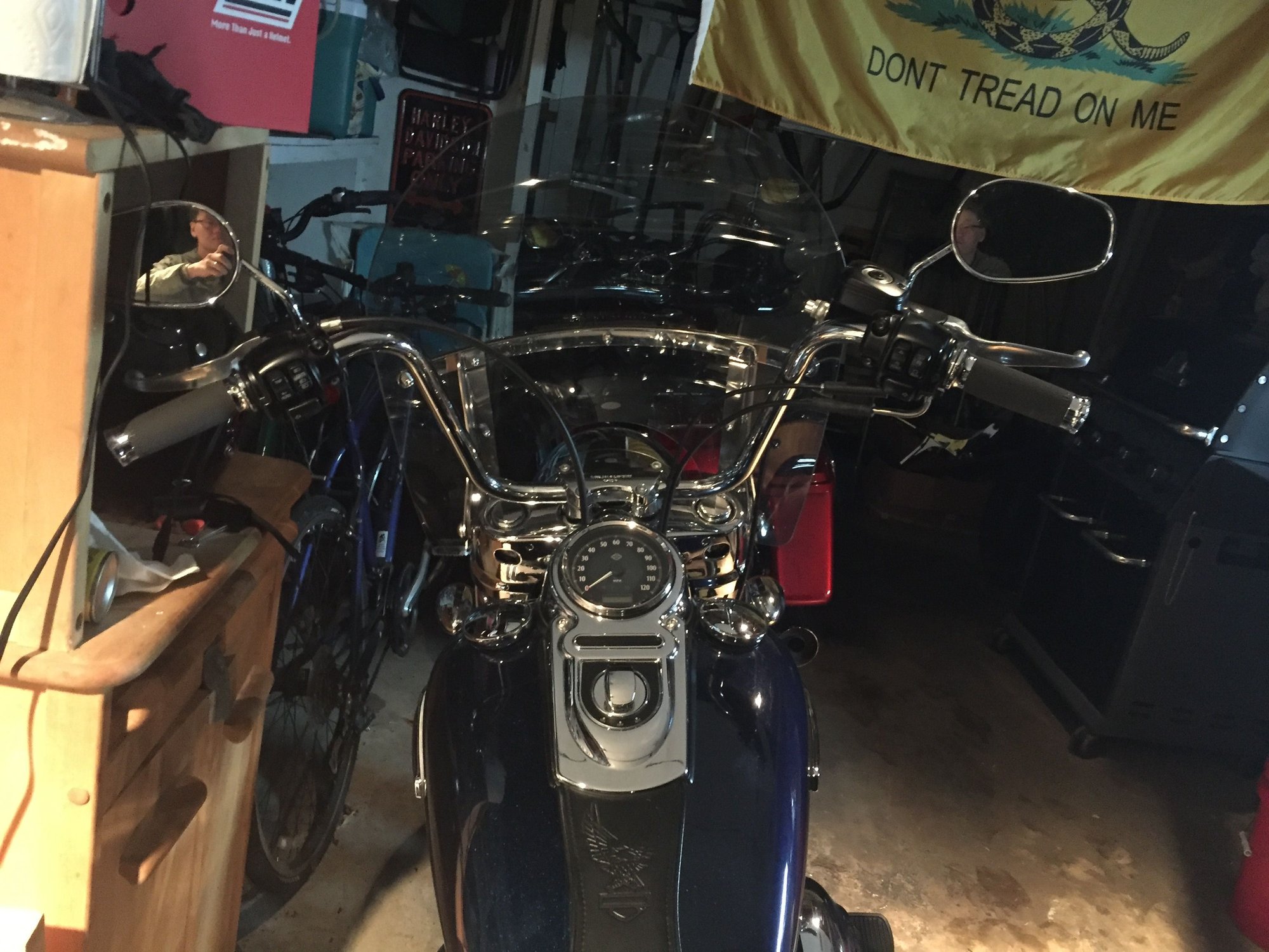

Sorry for the crappy quality. Bike is a Switchback. The bars are Khrome Werks Bobber 12", 1" diameter drilled for the wiring. From this link, if you drill down and select the 12" bars, there will be a diagram showing the measurements of bars in the pics. Be warned, I had to open up the holes in the grip area as the holes weren't wide enough for the connectors to pass through. The area where your hands go only has an angle of 30.4 degrees and they are flatter across than most bars. They approach the flatness of drag bars, but not quite as extreme. I find them very comfortable. I had Street Bob bars previously. They have more of a down angle and angled more inward. Aesthetically, I like that the vertical stalks/stem (not sure of correct terminology) are more in line with the forks than the Street Bob bars. I would have gone with the 1.25" bars, but they are 2" wider than these and 3" wider than stock. Just wide enough that I wouldn't be able to get my bike down the driveway with the car in it.
I had already replaced the clutch and throttle lines to Street Bob lines. Still have the stock brake line. In order to still use the stock brake line, I had to remove the Switchback risers (up 2, maybe 3" and back 1") and use Street Bob risers (up 1-2" and they don't move the bars back).
