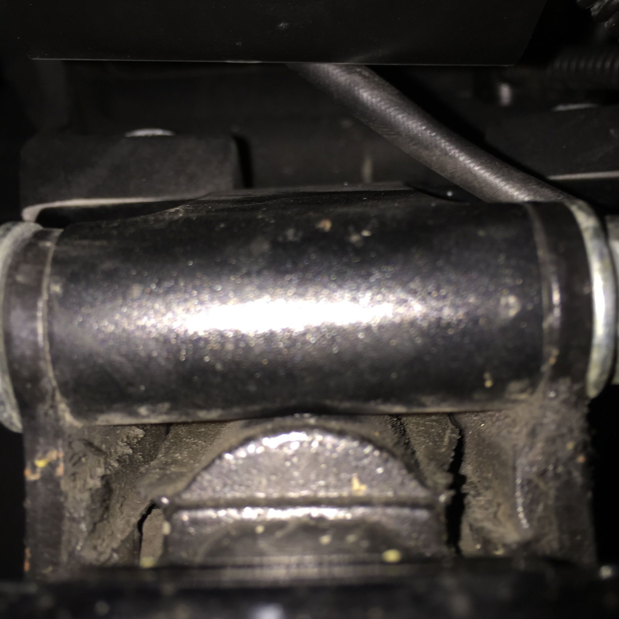

2012 wide glide with about 600 miles on it, barely ridden. I've been getting excessive vibes in the mirrors, entire front end jumping horribly, and my feet go numb after a few miles down the road
3/8 gap on bottom

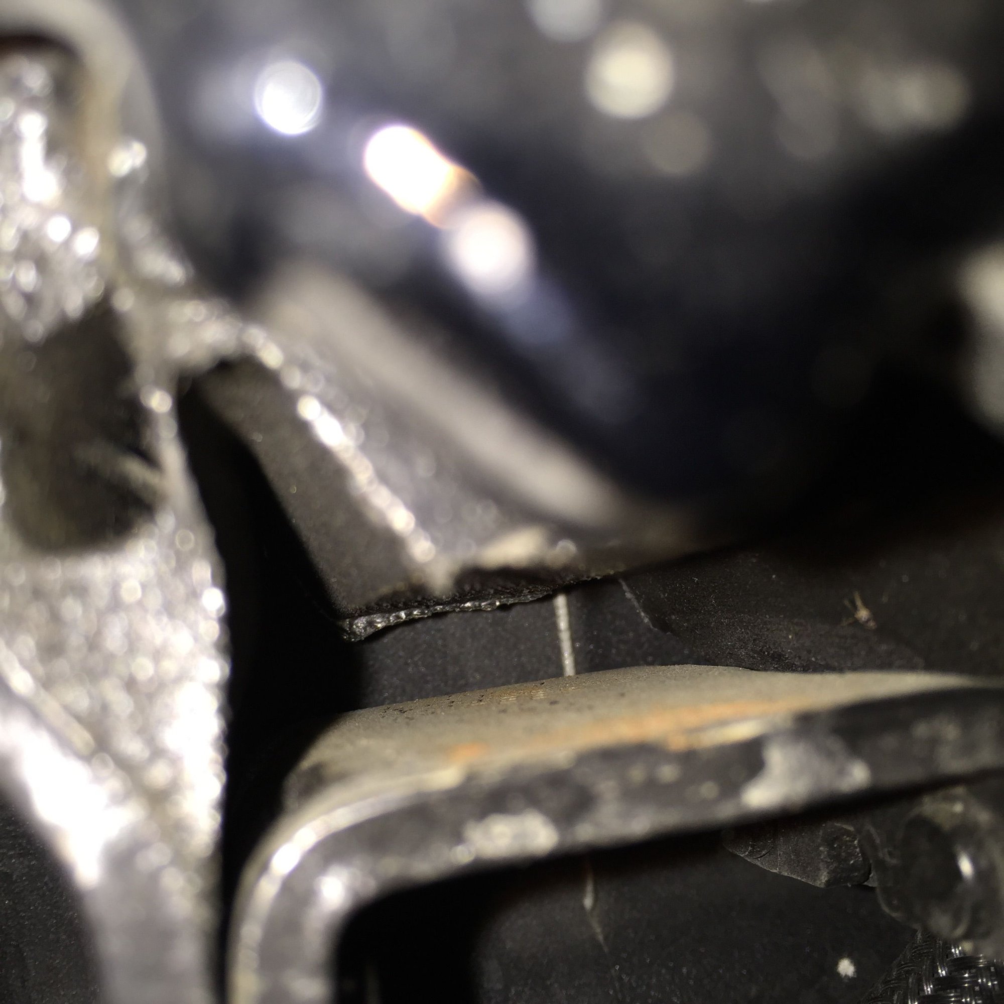

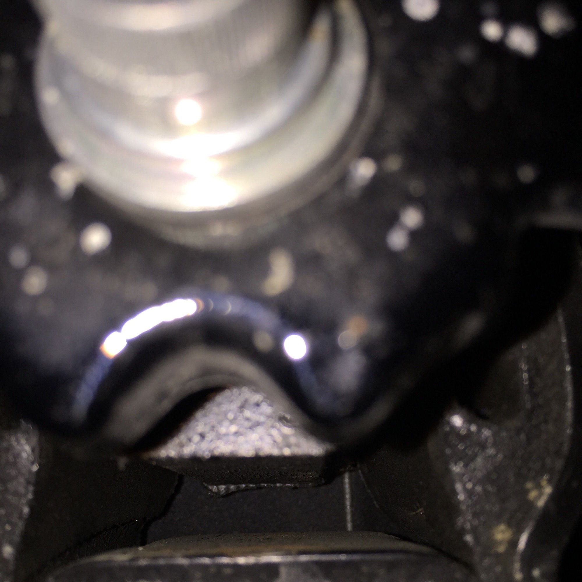

Right side of motor mount, Looks like rubber is about to tear. Left side looks the same
Left side motor mount about to tear. Notice big gap on bottom rubber
Clearly touching metal and supposed to be a small gap according to service bulletin I found
