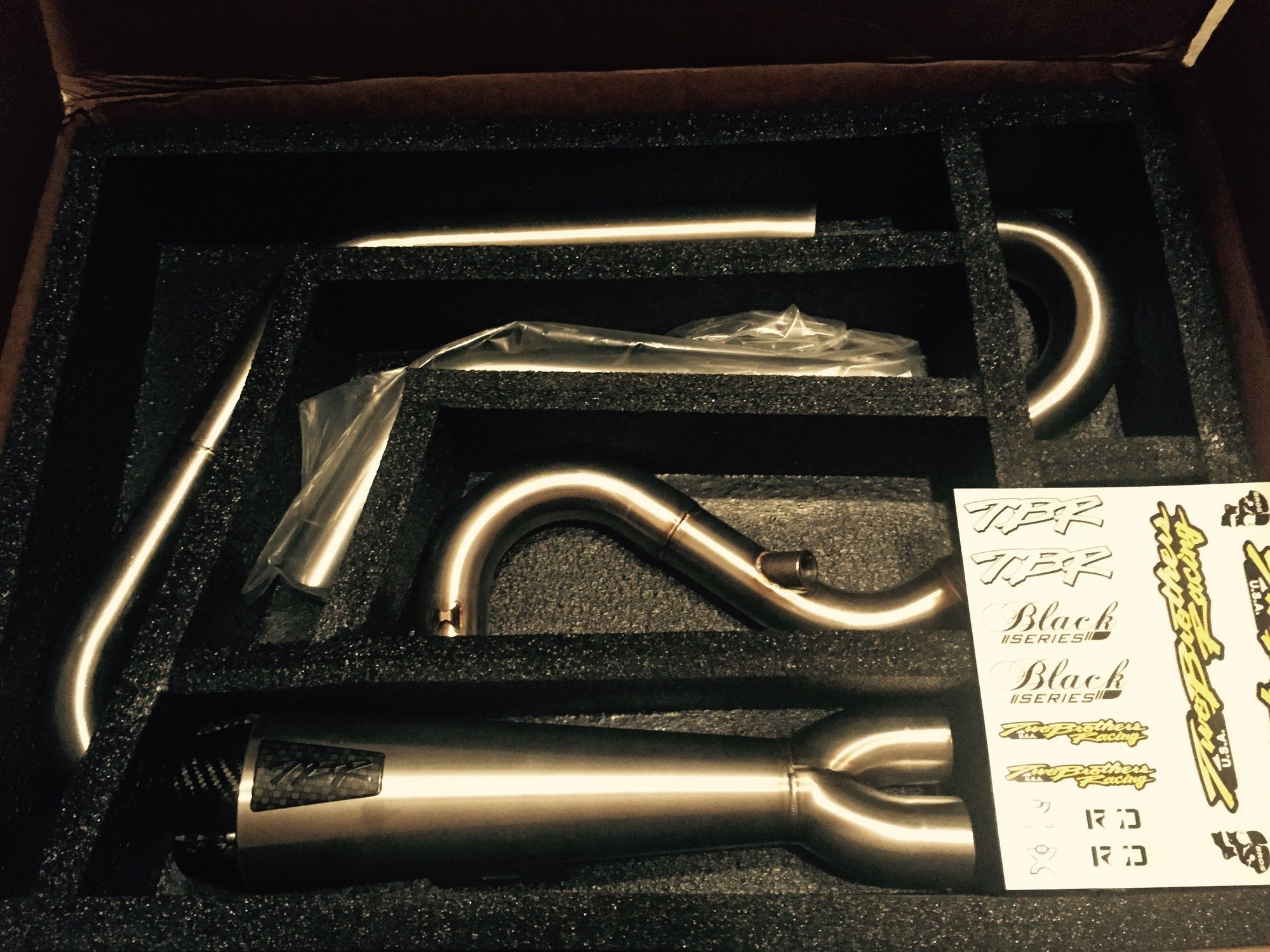

I just bought and installed a stainless steel Two Brothers Comp-S 2-1 exhaust on my 2015 Low Rider. Before buying I tried to research and didn't find much of anything on it so I figured I'd fill that void.
http://www.twobros.com/Products/Dyna...Dyna-2014.html
I'll speak to the package, quality/finish, fit, sound, and performance...
1. Package - The exhaust is shipped with each header separate, the collector/muffler, 2 springs to attach the 3 pieces (with a tool to do so...it was quick and easy), 2 heat shields, a muffler bracket, a couple sets of O2 bungs for different sized sensors, and nuts and bolts. It was packaged really well with no concern for damage while shipping.
2. Quality - I bought the stainless pipe (they also offer black coated). From first impression it looks great. It comes with a nice stainless finish and after idling on the bike for about 2 minutes, the header already changed to that nice gold that I love. Make sure (as the instructions say) to clean the pipes really well before starting the bike. Any oils from your hands or anything can cause permanent discoloration of the pipe once heated. Also, after starting the bike I noticed a rattling sound from the carbon fiber cone. There are some small bolts holding it on that weren't completely tight when shipped so I just tightened them up a bit. No biggy.
3. Fit - The pipes did come with instructions that were clear enough if you have any experience installing exhausts. If this is your first exhaust install then the instructions may seem a little vague. I will say there are two different ways you can install these pipes. One, is to attach the header pipes and collector while off the bike, then mount up like you would most other 2-1 systems. If you do this, I'd recommend not attaching the two springs until you have the system lined up and seated in the exhaust ports nicely. This is bc it can be a bitch rotating the header pipes around to the right angle to both align them with their respective exhaust port and also to where the muffler aligns to where it bolts up to the muffler bracket. The second way is to install the system in pieces. Loosely bolt up each header pipe to the exhaust ports and THEN muscle on the collector. This will help ensure the exhaust is seated and won't leak, but it may be a pain getting the collector on going this route. I didn't actually try this method, but it seemed like an alternative after installing it the first way bc it was a bit of a headache. Also, use all of the bolt torque specs for your stock exhaust on the TBR exhaust.

4. Sound - Completely subjective. I love it. Deep rumble and really rips at high rpm. Definitely loud either way.
5. Performance - I haven't put the bike on a dyno before or after install, but TBR has their own sheet here...
http://www.twobros.com/products/dyna...Dyna-2014.html
Your tune will matter as much as what exhaust you have so that is what it is. If you have a 2-1 pipe, I don't think brand matters so much. You'll get relatively similar performance gains either way. That said, the butt dyno approves. lol
So there you have it. The TBR Comp-S 2-1 in a nut shell. If you have any questions or comments...let's hear it. If not, hope you found the review helpful in some way.
