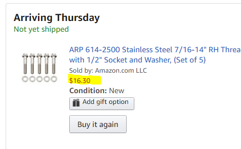

been putting this off for a while. i will be replacing my rear tire soon. i'll swap these in. just ordered.
the price just doubled after i bought it...
shady....
