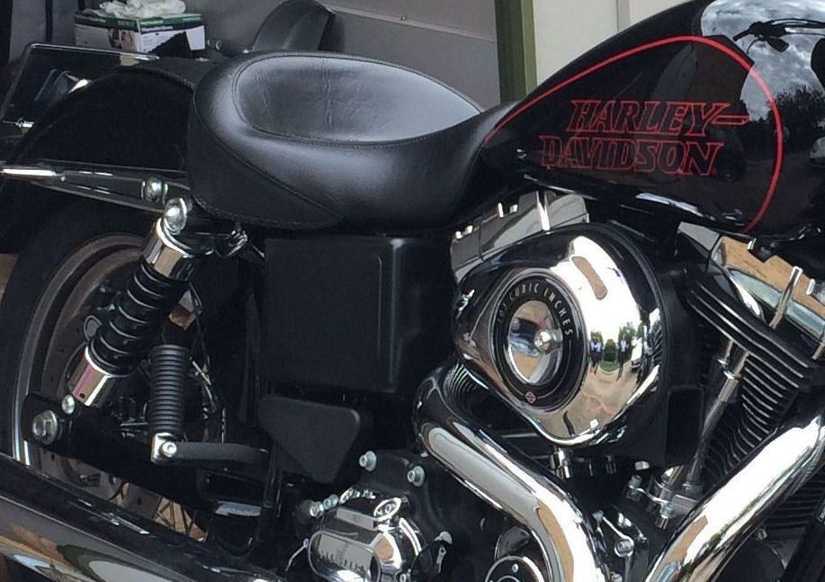

Old Jul 14, 2015 | 07:52 AM
MAJ Ethanolic's Avatar
MAJ Ethanolic
Joined: Jun 2015
Posts: 201
Likes: 14
From: Gilbert, AZ
I did the derby cover, chain cover, and electrical cover using the VHT wrinkle black. I can hardly tell the difference from the stock paint.
Old Jul 14, 2015 | 11:27 AM
cggorman's Avatar
cggorman
Posts: 11,448
Likes: 2,299
From: NW Ohio
That looks real nice. Can you get a close up of the primary and derby?
